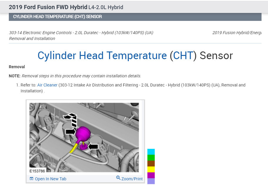

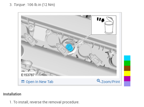

Hi to you, this may concern I'm having an overheating problem on my car listed above. I've been trying to locate the coolant sensor or a few days now, this is the code that popped up when i put the ob2 reader on (p1299).
