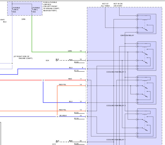

My car recently overheated. the heater was not working 'no hot air coming out'. then the radiator cracked and was leaking and I replaced with a new one. I recently replaced a thermostat, and only discovered that the cooling fan is not responding.
please advise! thank you

we have no information on this car, but what i am sending may be very similar to what you have. check all items in picture which are relays and fuses normally under-hood. this is from an Altima here in USA. it may be a bad CPU which will have to be scanned for codes.
