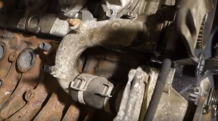

Fuse for fan was good. I have located thermo fan switch. If I left ignition switch on (engine is off), and removed the connector from the thermo fan switch, the fan worked. The thermo fan switch is shown in the first picture.
I was about to replace this unit. But I ran into another article about different "fan sensor" located in the left side of the engine, below the exhaust manifold as in second picture (viewed and captured from YouTube video). I am not sure if second picture is applicable to my engine. It is not easy to reach.

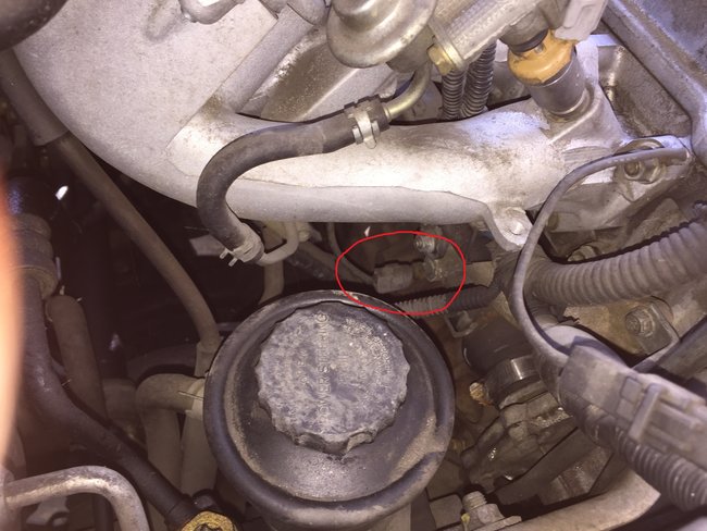

I just took a picture of second possible "fan sensor" in my car below the exhaust manifold. What is it called? Could you point me to the link of this part? Thanks,
-Tim
Feb 25, 2018 at 1:37 PM

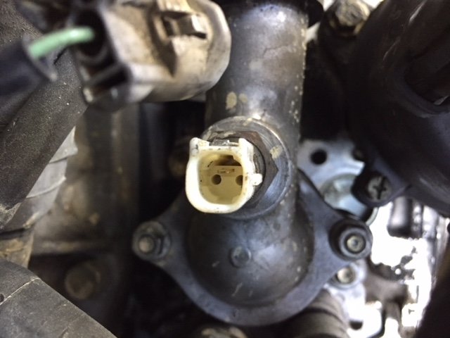

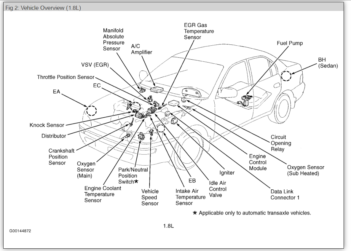

The fan sensor is in the thermostat housing the one in the last picture is the coolant temperature sensor for the gauge i believe.
Here is a guide below that shows the sensor locations but I don't see the location in which you are showing here now.

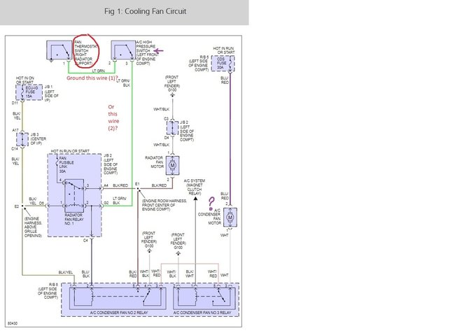

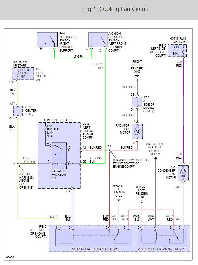

Here is the cooling fan wiring diagrams you can see the two sensor/switches that work the system. If you ground the sensor wire at the thermostat housing with the key on the fan should run can you do this test please?
Mar 1, 2018 at 10:57 AM

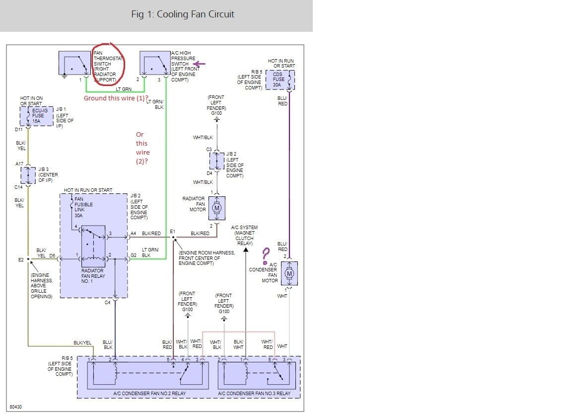

Thank you. I edited the diagram and added in text to wire. Could you confirm that is the sensor wire you want me to try?
As I mentioned in the initial report, if I removed the socket out from sensor as in 2nd attached picture, the fan ran. The wire to this socket is "light green"

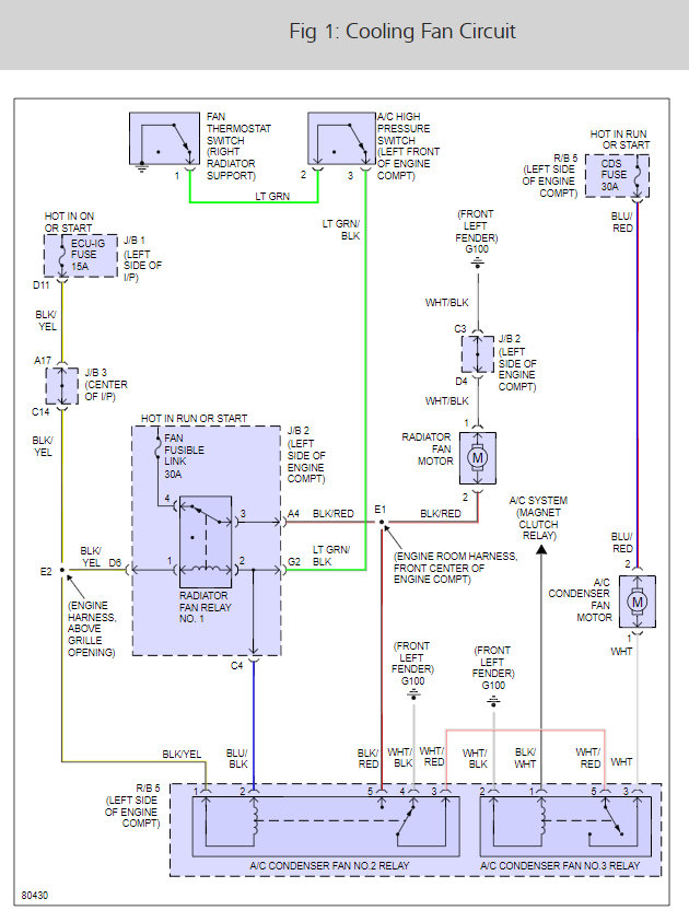

... here is attached edited diagram with 2 texts on "light green" wire: (1) and (2). Which one you want me to try?
I don't know if light green wire from my car (in previous picture) is (1) or (2). My best guess is that it is (1) as it is on engine block, far away from A/C unit.

The fan thermo switch is the one I would replace. You say once you remove the wire the fan runs correct?
Mar 2, 2018 at 10:14 AM

From that experiment, the fan switch appears to work and fixes part of the problem. But something else interferes with the switch so that it is turned off at 107C. I fear that 2nd switch (picture posted on Sun 2/25) might need to be replaced but:
1. I don't know what it is called and how to find that part number.
2. I need to find another way to test if that switch is my problem.
From your posted diagram, there is also 2nd switch (AC high pressure switch). Is there anyway you can help narrow down to part number and its location for me?
