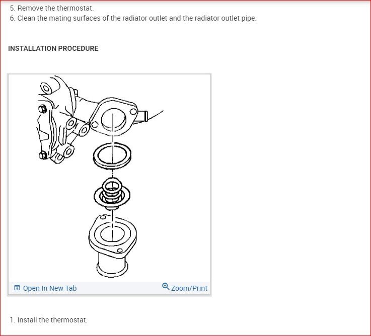

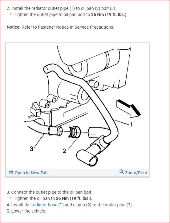

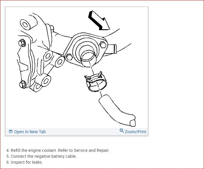

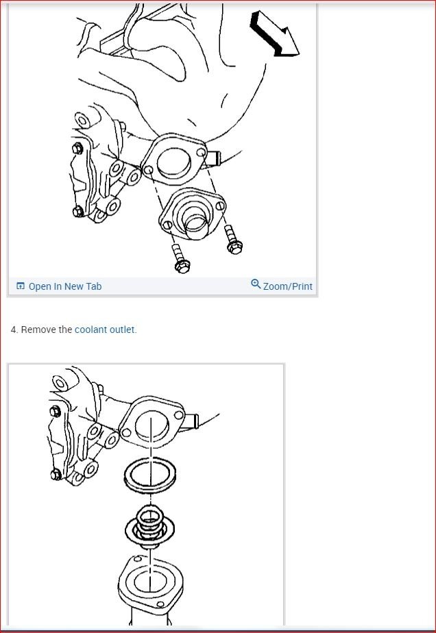

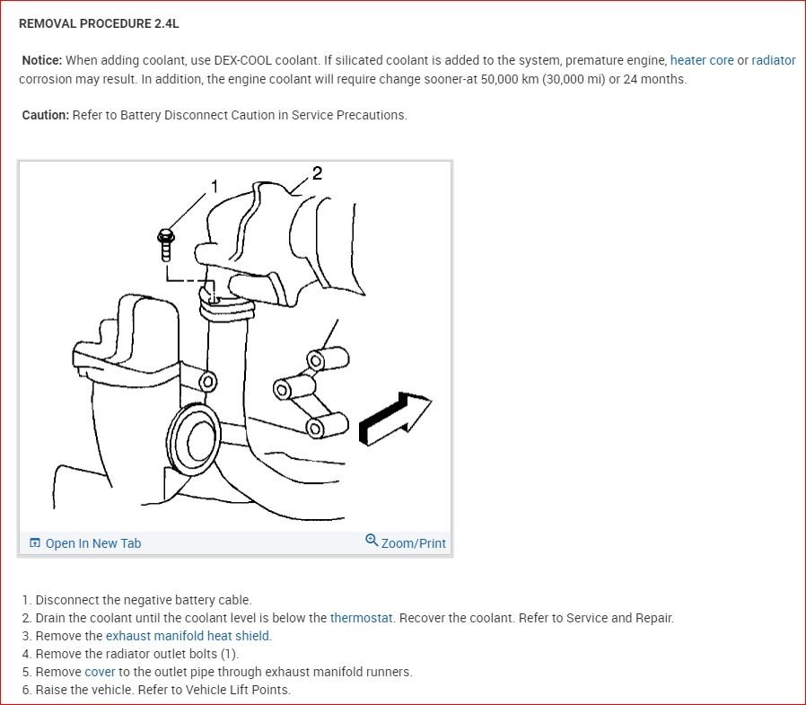

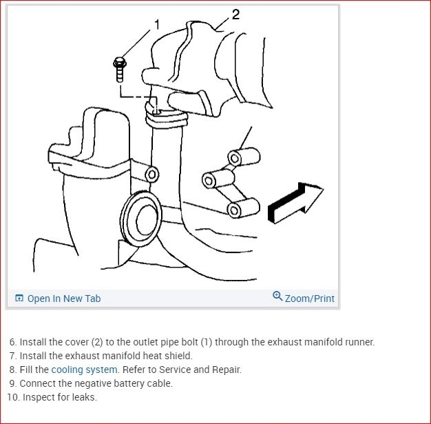

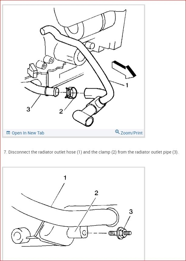

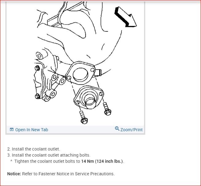

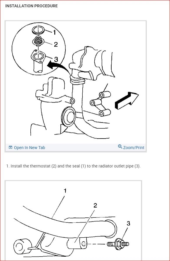

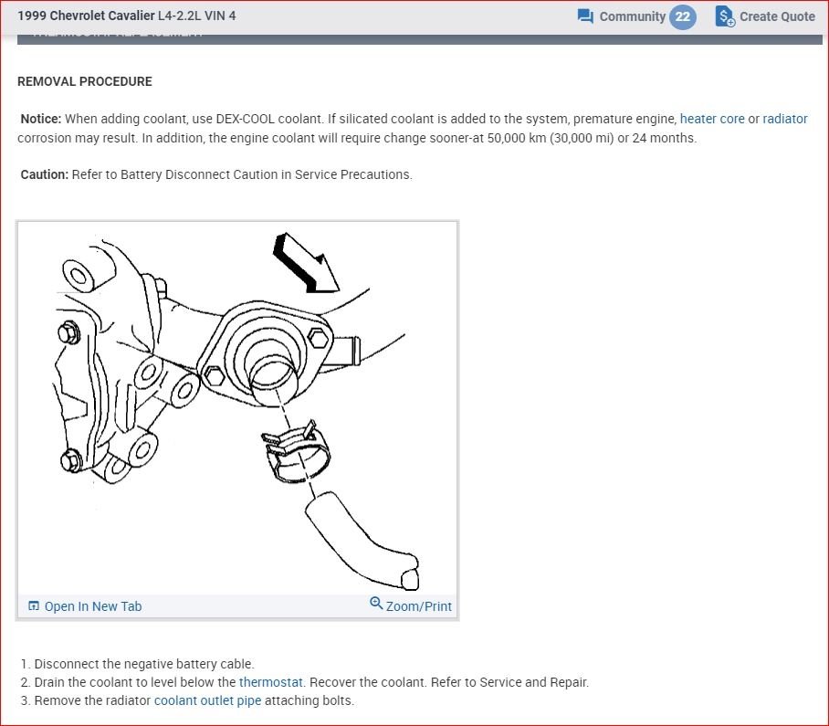

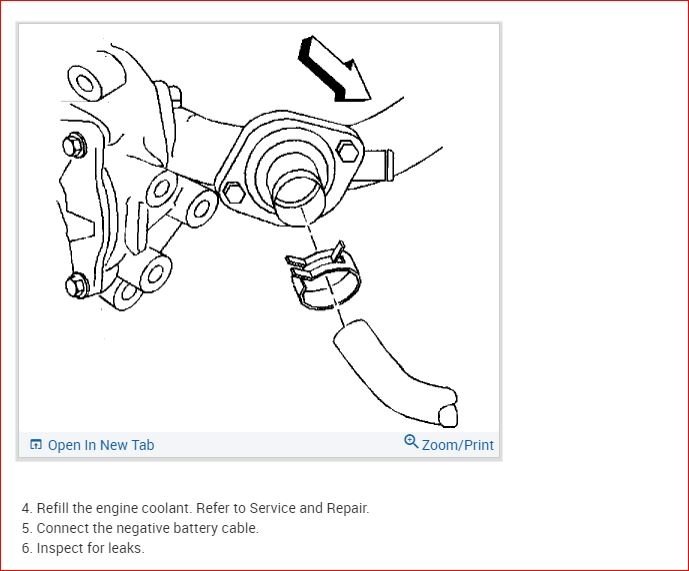

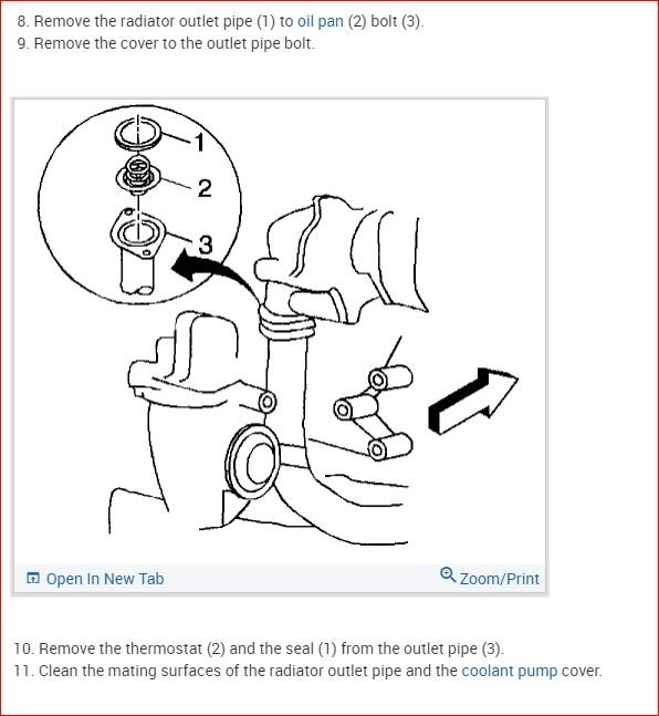

Where do you change the thermostat?
May 21, 2019 at 6:39 PM
Hi Victoria,
Here is the procedure depending on the engine you have. 2.4L or 2.2L. Both are provided below so please refer to the proper one.
Please let me know if you need more information. Thanks
