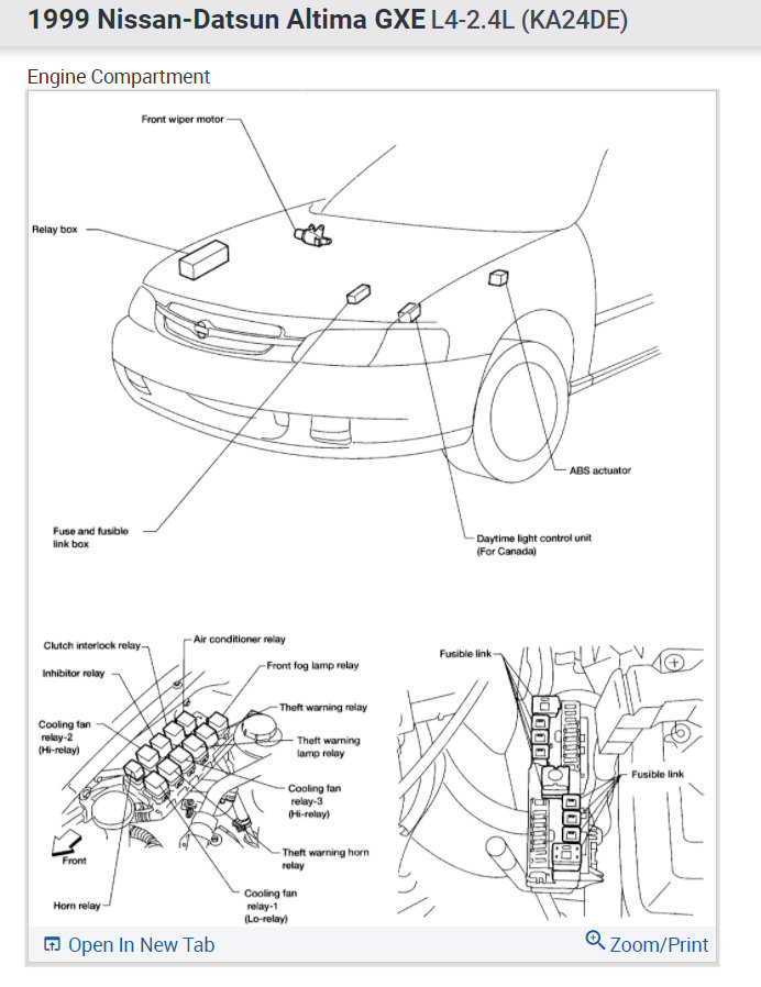

Can you hear the cooling fan running? if not it will usually be bad. these guides can help us fix it. Here is a guide to help you step by step with instructions in the diagrams below to show you how on your car. lets also check the relay.
https://www.2carpros.com/articles/engine-overheating-or-running-hot
and
https://www.2carpros.com/articles/replace-electric-fan-motor
and
Here is a guide to help you step by step with instructions in the diagrams below to show you how on your car. Check out the diagrams (below). Let us know what happens and please upload pictures or videos of the problem.
