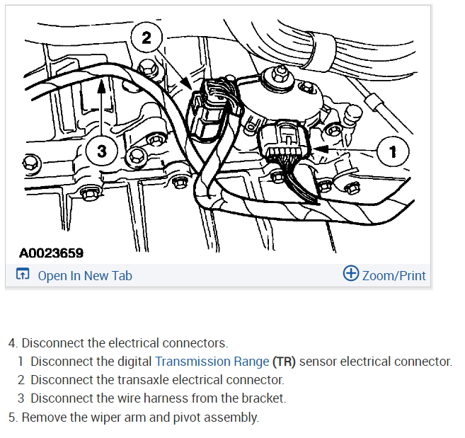

I just bought this van from a dealer, 6 months ago. Only replaced the battery. Then suddenly the engine shuts off when I shift into any drive gear. Doormen for when shifting to neutral. ATF is at the proper levels I'm not having any other lights or OBD codes. Internet searches are producing, easy and cheap 2$ part to buy a new transmission $2,500. How can I attempt to fix this without having to go broke?
