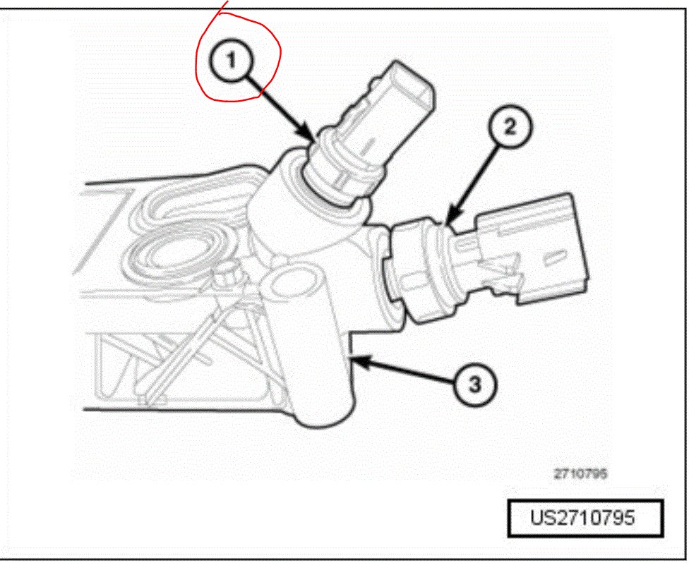

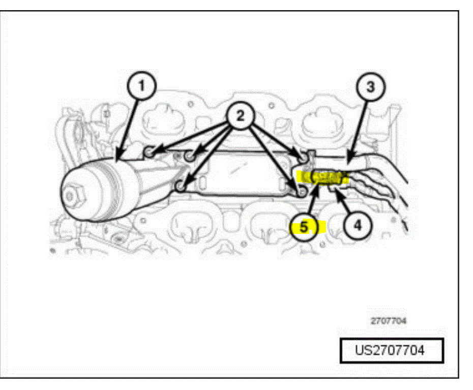

The oil temperature sensor is located on the oil filter housing. See the attached pic for location.

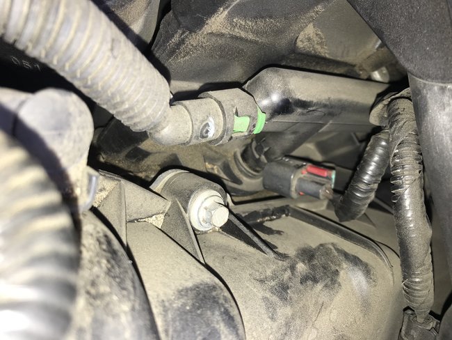

I’m looking at the area that your referring to from the diagram, and I can’t seem to find the right one. Here are some pics. Let me know if it could possibly be one of these.
Sep 13, 2020 at 10:20 AM
It's really hard to tell what I am looking at in the pic. The sensor is under the intake at the rear side of the oil filter housing.

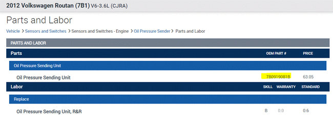

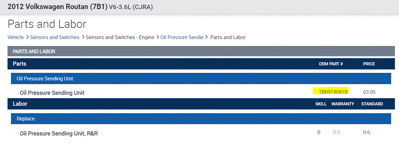

I have the part number for the oil pressure switch, but there isn't a listing for the oil temperature sensor. I attached the part number for the oil pressure switch. In all honesty, I would think they function differently, so I question if they are the same part.
