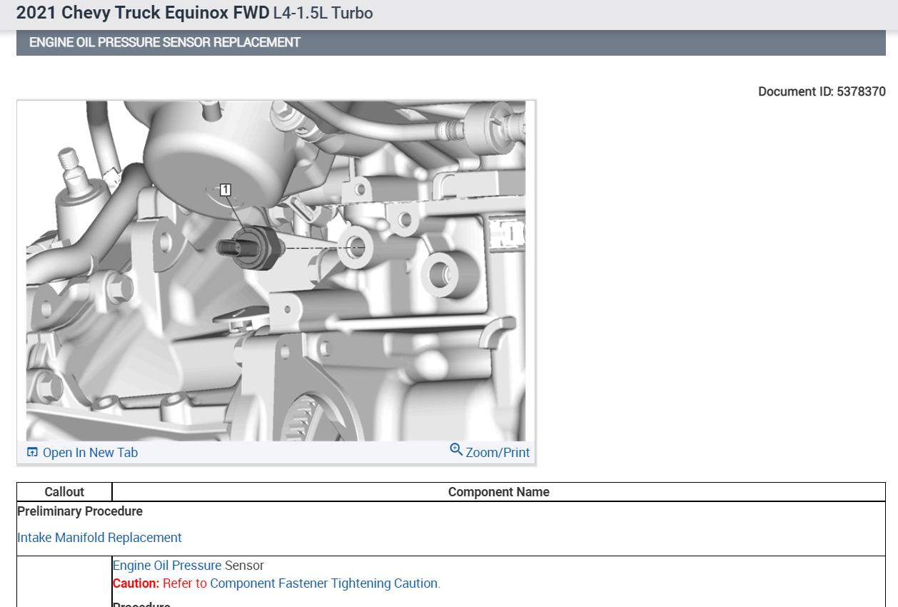

Oil Pressure Sensor location needed on the vehicle listed above?

The oil pressure sender is located right above the starter motor. Here is a diagram in the images below. Check out the images (below). Please let us know if you need anything else to get the problem fixed.
