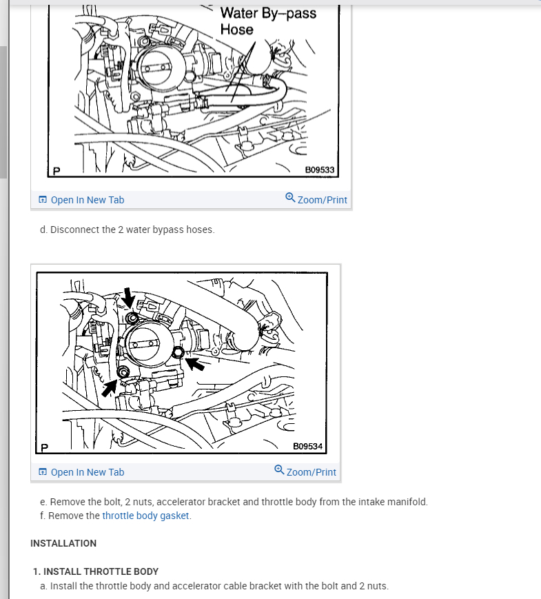

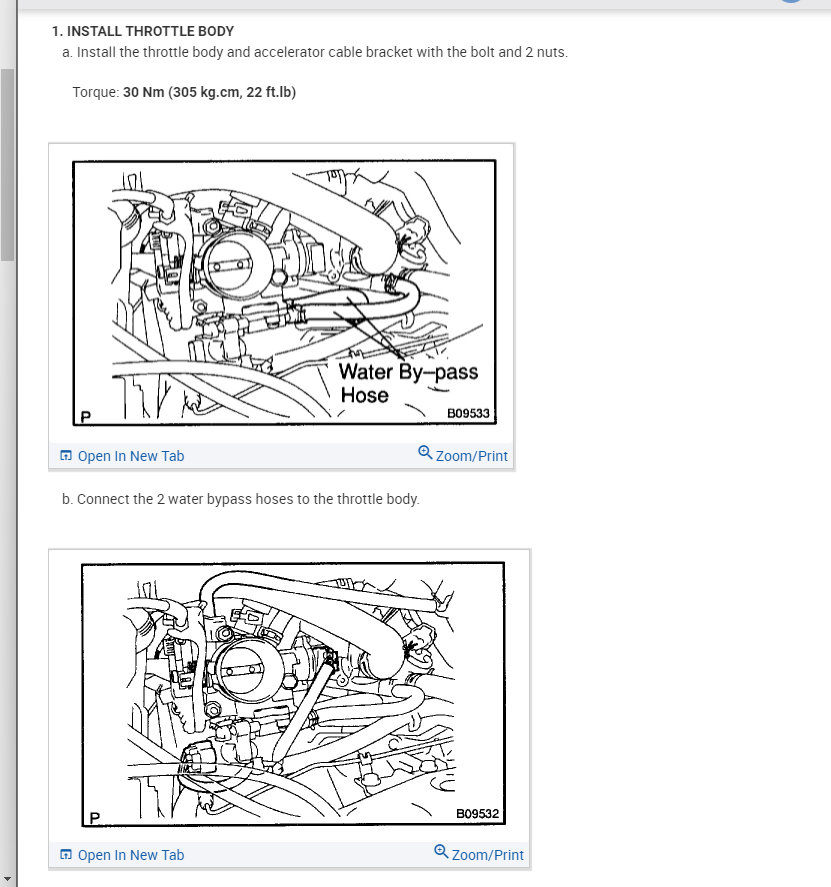

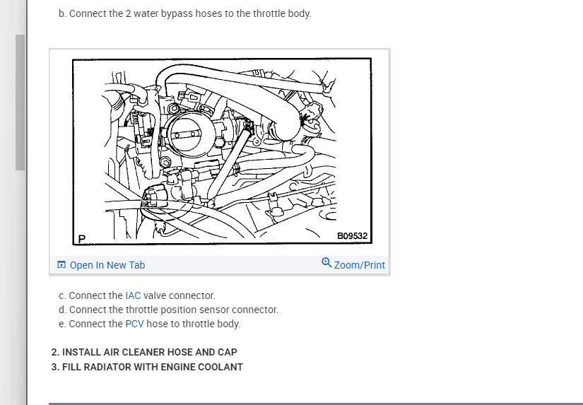

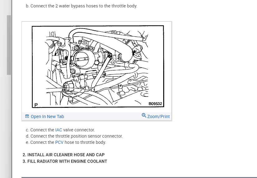

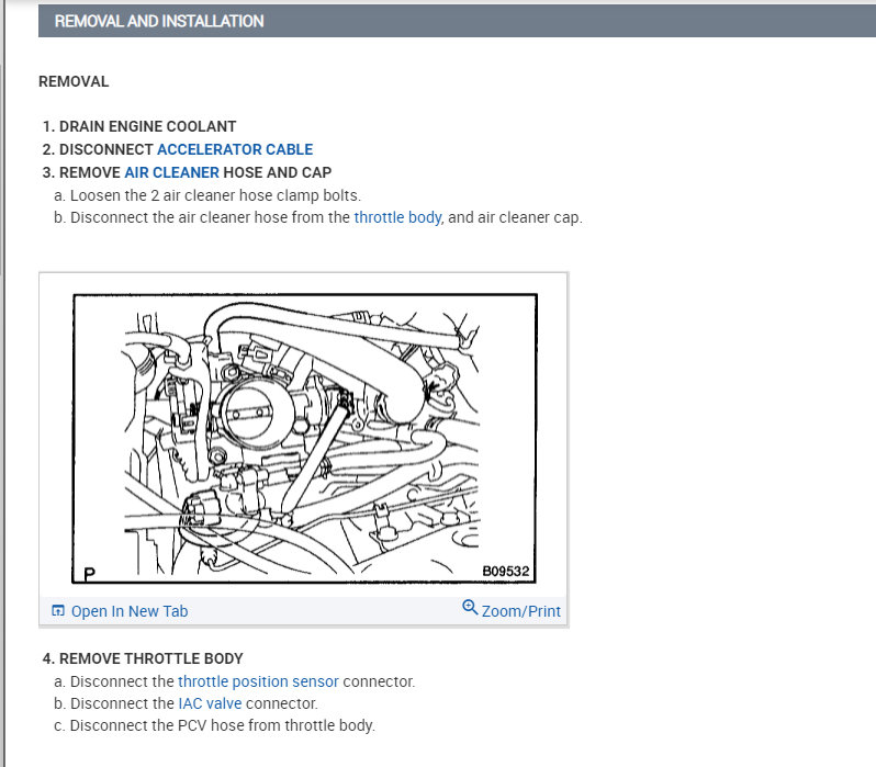

We don't have this vehicle in the USA, so I have to use the manual from the sister vehicle. This shows the vehicle has an electronic throttle body so can you confirm that there is no cable that operates the throttle body?
Basically, push the accelerator and watch the throttle body and see if a cable is moving the plate.
I attached the process below to show more details.
Let's start with this info and go from there.
