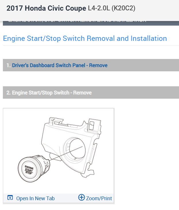

Here is how to change out the push button in case you need it, as far as cost goes it can range from $200.00 to $800.00 depending on the issue but I can help narrow it down with more information. The start switch button looks pretty easy. Check out the images (below). Please upload pictures or videos in your response of any problems so we can see what to help you with.
