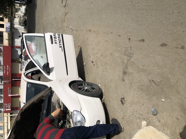

After installation of newly ignition coil. I started the engine by switching use of key. Battery is full charged. But the engine still not running.what's the problem here? Is fuel pump is defective? Any idea?
