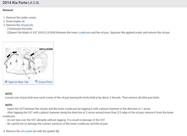

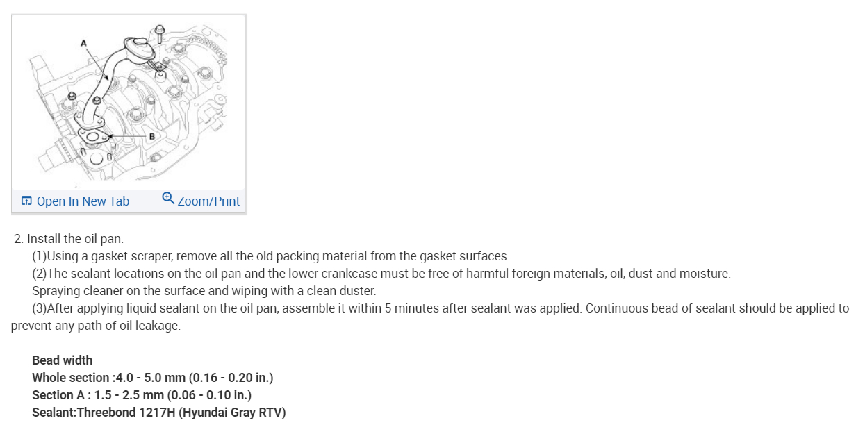

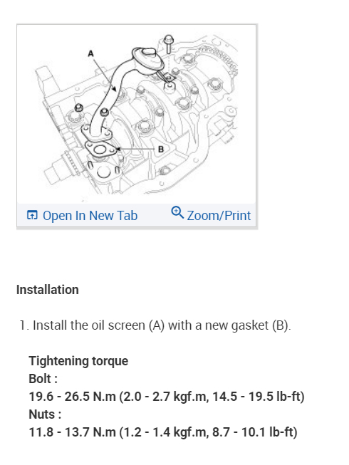

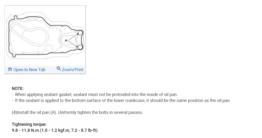

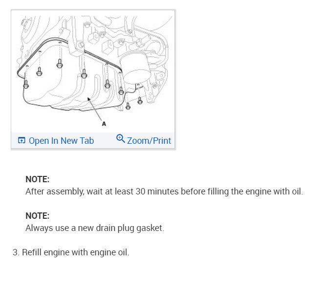

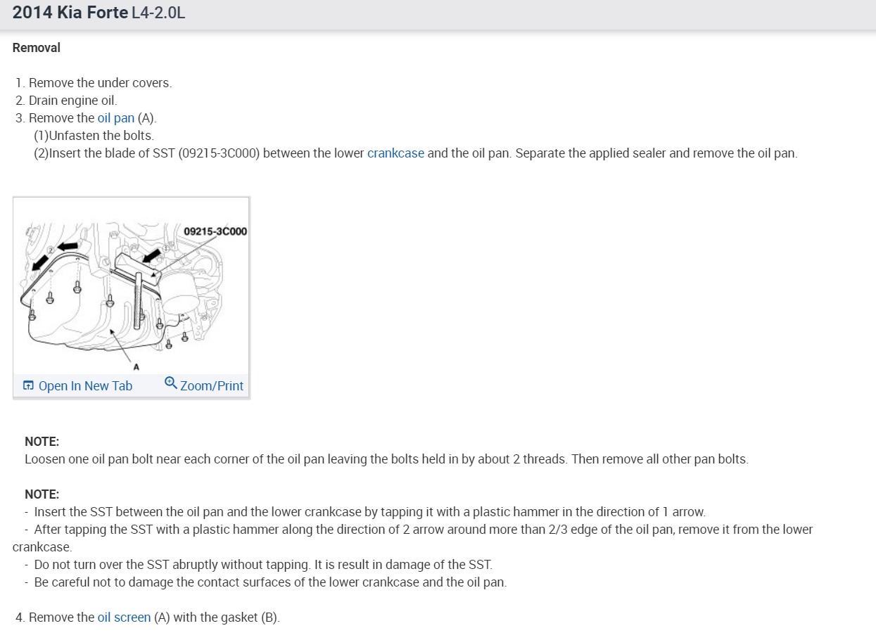

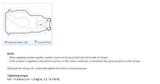

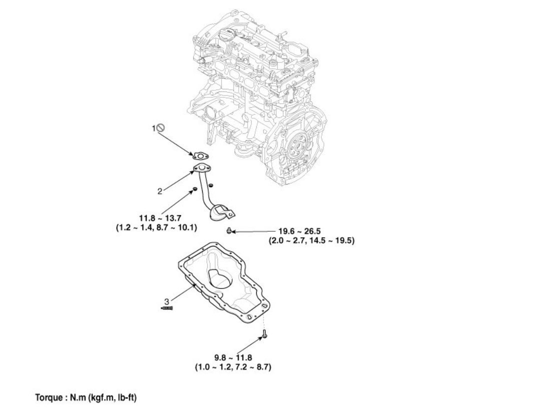

What happens is the if the oil changes have not been kept up is that sludge will develop inside the engine and plug up the oil pump intake. I would drop the oil pan and clean it. here is how the job is done. Make sure to roll on a new oil filter as well.
