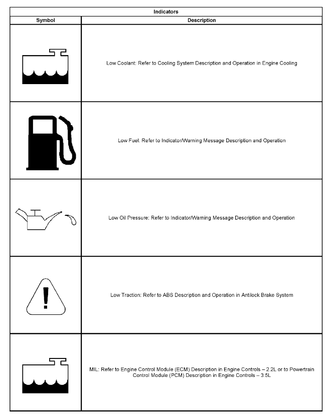

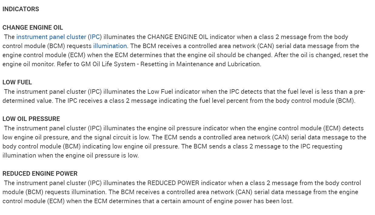

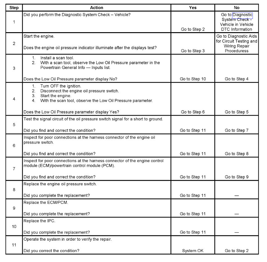

I have the car listed above 3. I have to have it jump started after a cold night. After letting the car warm up the oil can light started to flash and when put into gear started to make a clunking sound. Oil shows as full on the dipstick.
