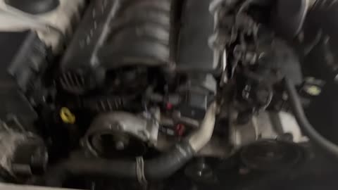

Bought it from the auction dirt cheap. Knew it had an engine noise. Car is well maintained, drove excellent, not even suspension issue which are common on these. When i got home 95% of the noise was gone, strange. Can you listen to this see if it's something you heard before? This is when it was cold. I will send another when halfway warm then when fully warm. This is the 3.5l. Not even check engine light.
Oct 9, 2021 at 3:23 PM
DIVIDES
  • 903 POSTS
Mid way before warm, loud.
Oct 9, 2021 at 3:25 PM
DIVIDES
  • 903 POSTS
Raising the RPMs, it kinds of goes away then gets loud. Also turned it off and on again, a lot of the noise was gone.
Oct 9, 2021 at 3:29 PM
DIVIDES
  • 903 POSTS
When you first turn it off then turn back on its almost 100% gone then slowly comes back at a minimum.
DIVIDES
  • 903 POSTS
Fully warm.
Oct 9, 2021 at 3:31 PM

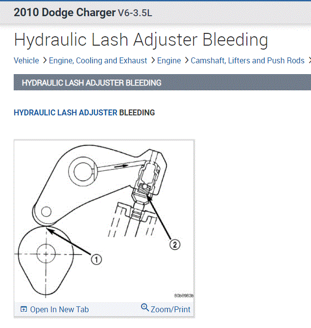

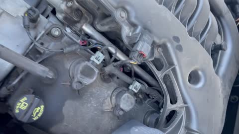

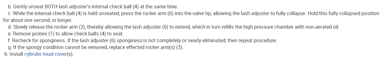

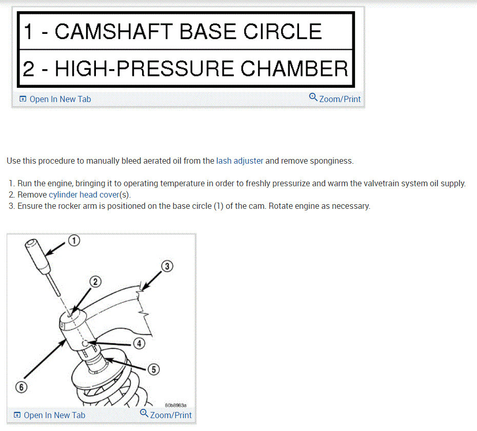

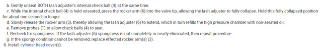

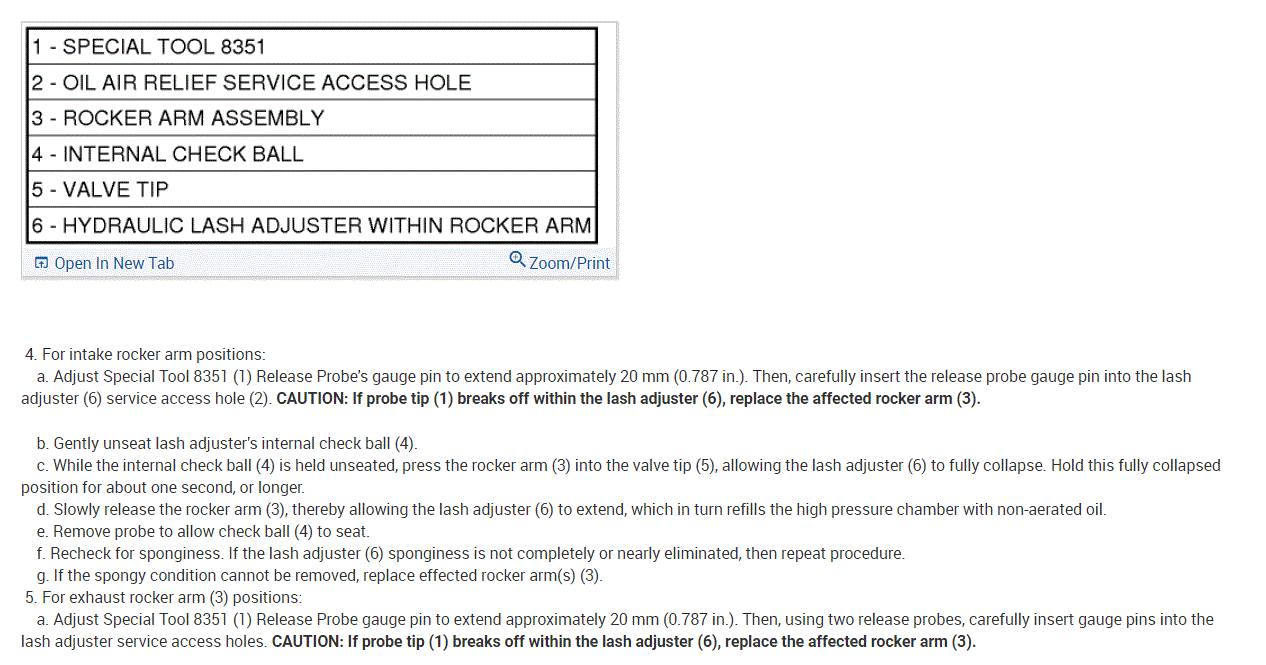

I would suggest pulling the valve covers and check for a loose rocker. The hydraulic lifters are adjustable so you can adjust the valve lash by bleeding the hydraulic lash adjuster. However, I feel if you find the loose one, it will need to be replaced. Regardless, you can try bleeding it.
Also, here is a link that explains different sounds from an engine. Take a look through it and see if anything seems to fit.
https://www.2carpros.com/articles/engine-noises
Listening to the sound, it sounds like an issue with a rocker. That is why I'm suggesting the adjustment/bleeding.
If you look at the pics below, they are the directions for adjusting lash. Also, I don't feel it is something with the camshaft (yet) because it goes away. A bad lobe wouldn't change.
See pics below.
Oct 9, 2021 at 7:19 PM

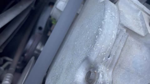

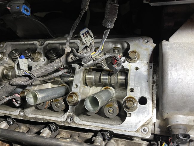

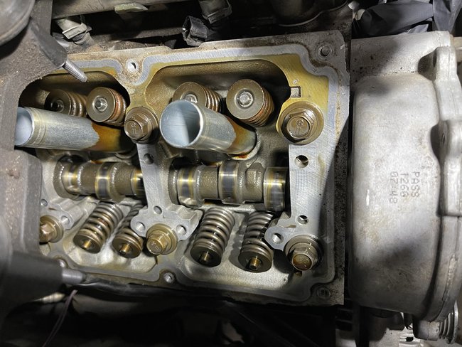

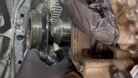

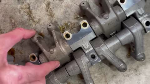

I removed the lifter assembly, is this normal? I have seen a lot of videos attributing the sound to this. Many of them are this loose.
Oct 14, 2021 at 10:53 AM
DIVIDES
  • 903 POSTS

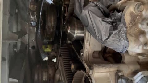

I changed that one side of assembly as far as rockers because it was just eaten and loose, but i removed the timing belt cover and the belt is just too lose in my opinion, but not sure how it can cause such noise.
Oct 14, 2021 at 12:59 PM

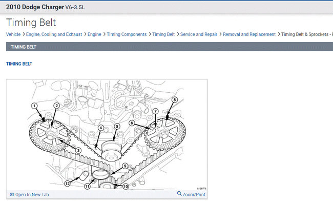

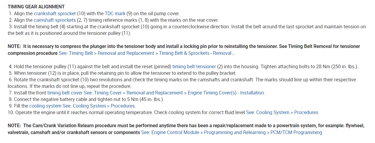

Wow! The belt is way too loose. As far as the rocker arms, they will move, but what I'm seeing seems excessive.

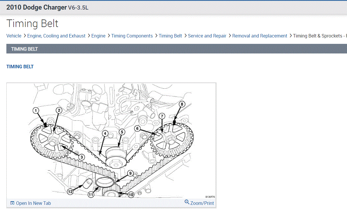

As far as the timing belt, chances are the tensioner is bad. It has a hydraulic tensioner. In your video, the side of the belt you are moving wraps around the water pump, so you should inspect that as well. Actually, if you replace the belt, it is a good idea to replace the water pump at the same time. That way, the chances of you needing to do the job again in the near future are lower.
I'm not sure what your intentions are with the vehicle. If you plan to keep it, I would replace the timing belt and tensioner. It will jump time the way it presently is. I'm surprised it hasn't already. Please keep in mind this engine (3.5L V6) is an interference engine. If the belt breaks while it's running, it will likely cause internal damage.
When you replaced the rocker assembly, did that side quiet down?
If you look below, I attached the directions for the removal and replacement of the timing belt. I'm adding it in the event you want to change it. (I do recommend it) but that's your call.
Let me know if this helps.

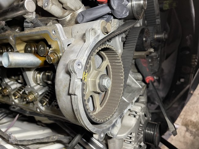

DIVIDES
  • 903 POSTS
Not keeping it, just want to change the tensioner and send it to auction. I can't really tell if it did quiet down or not as the sound is everywhere and only way for me to tell if after its warm for 20-25 minutes which is when it quiets down and i didn't want to wait that long. Is the tensioner held with one big boot from the bottom? Also, i guess i need to turn the motor a bit so the loose end if the belt is by the tensioner? Easiest way to make sure the marks are lined up?
Oct 14, 2021 at 6:08 PM

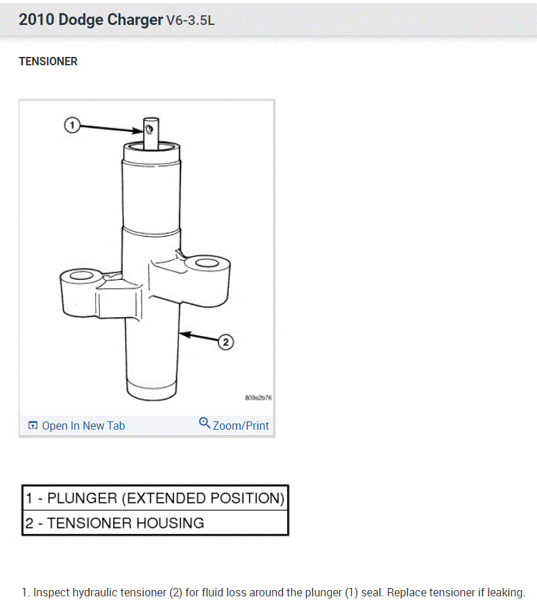

DIVIDES

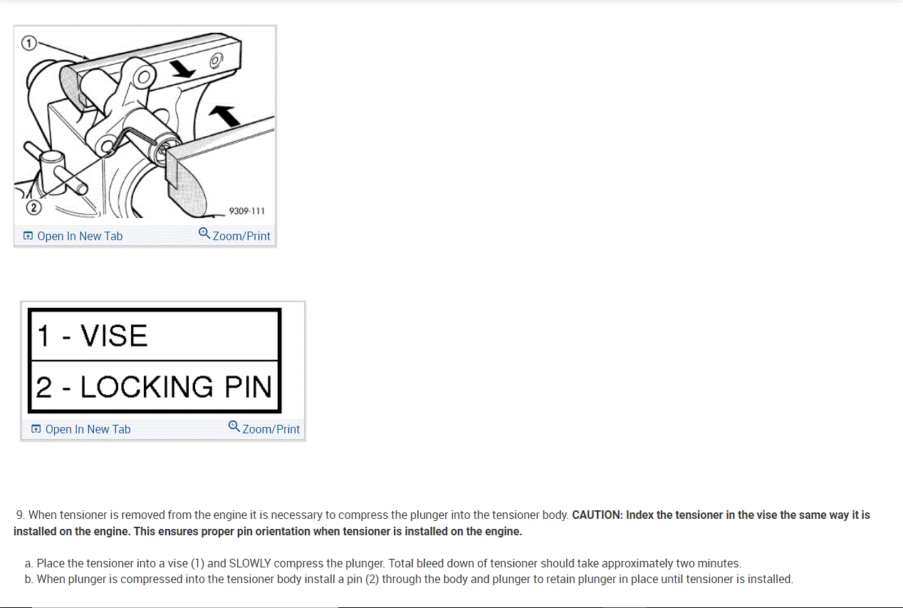

  • 903 POSTS

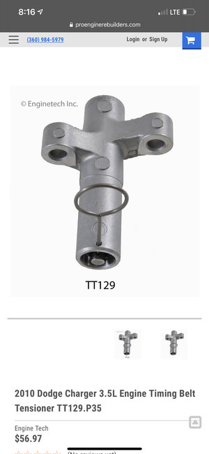

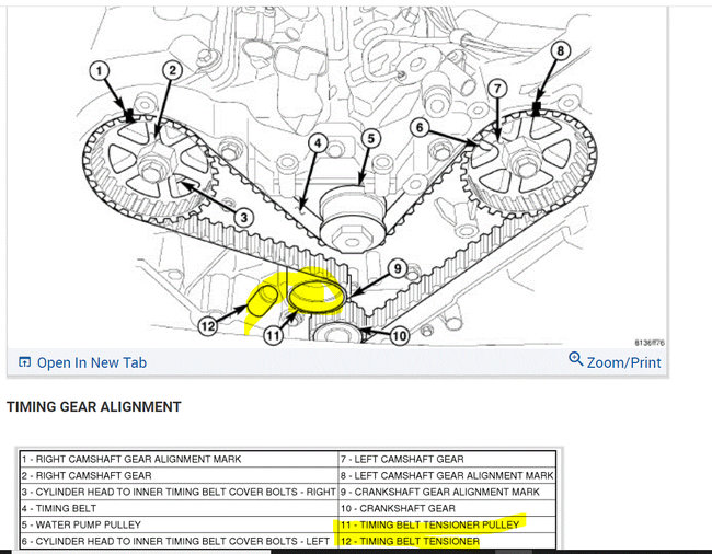

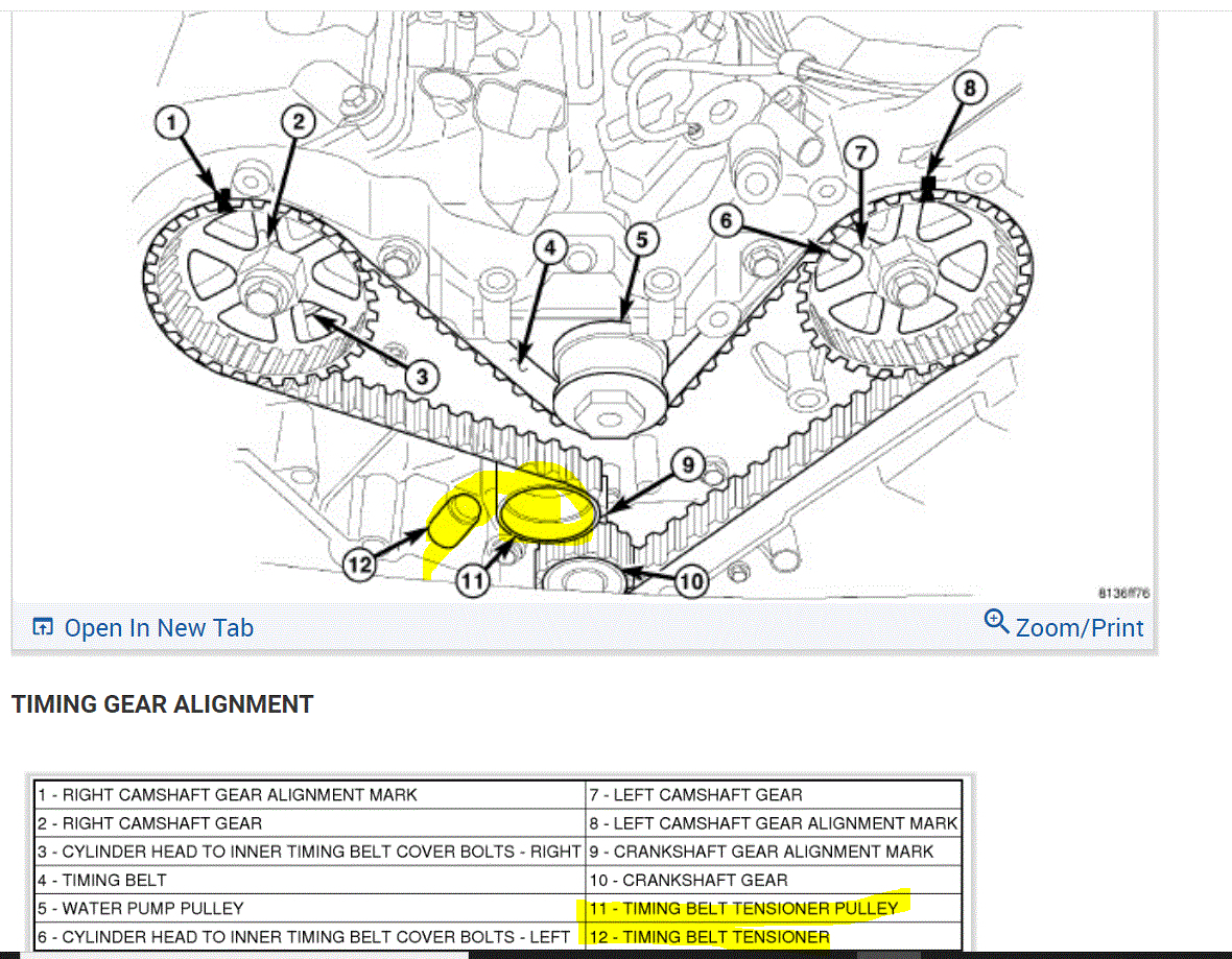

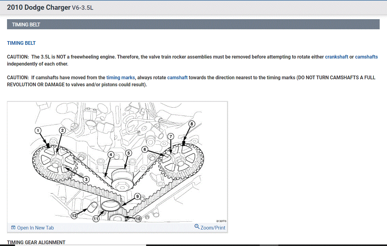

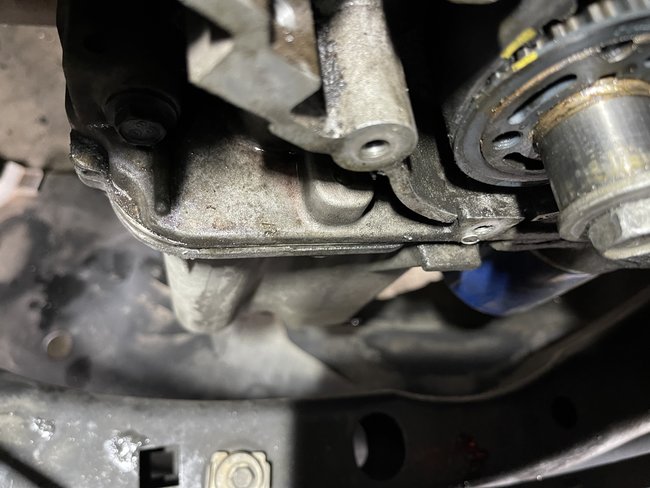

Not sure why it is showing two different types.
Oct 14, 2021 at 6:18 PM

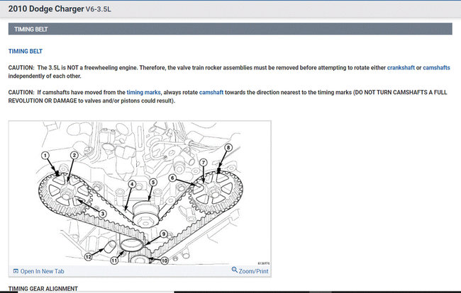

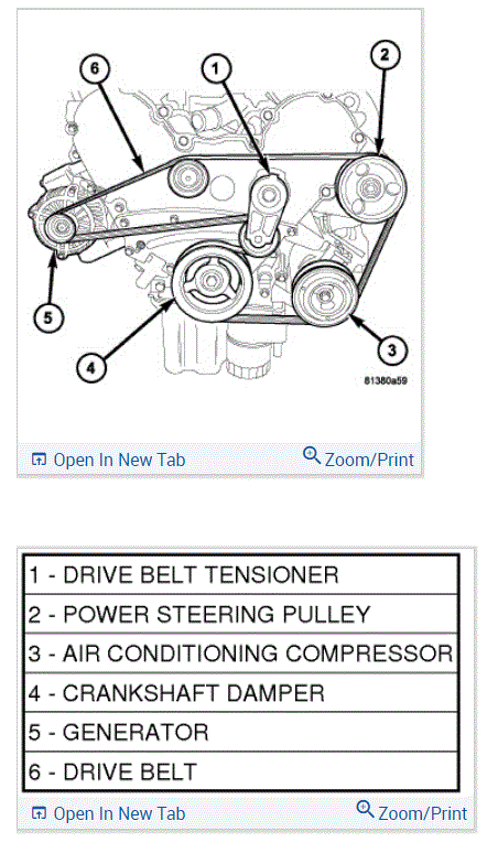

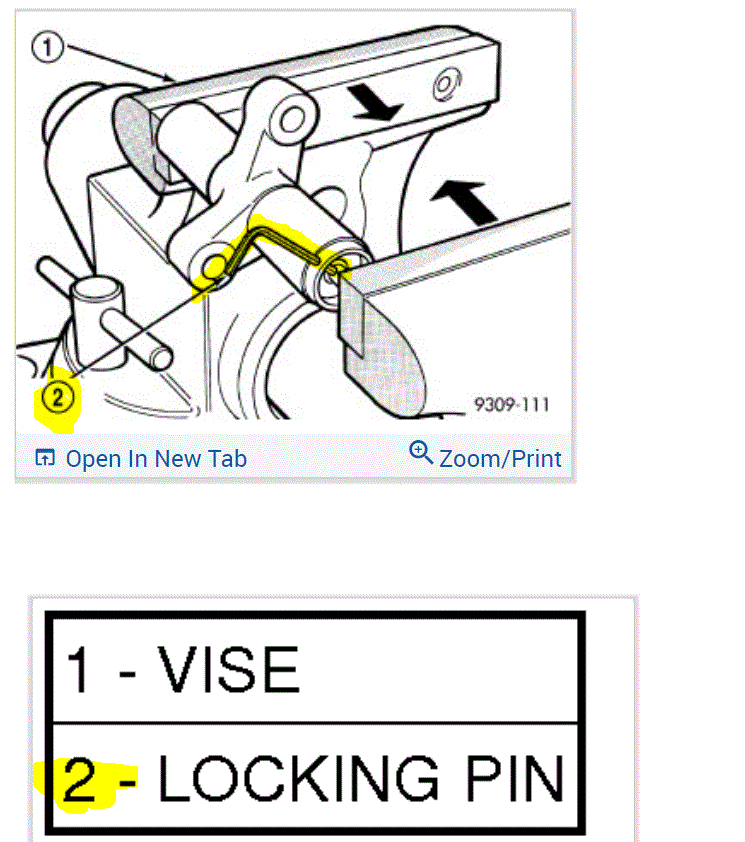

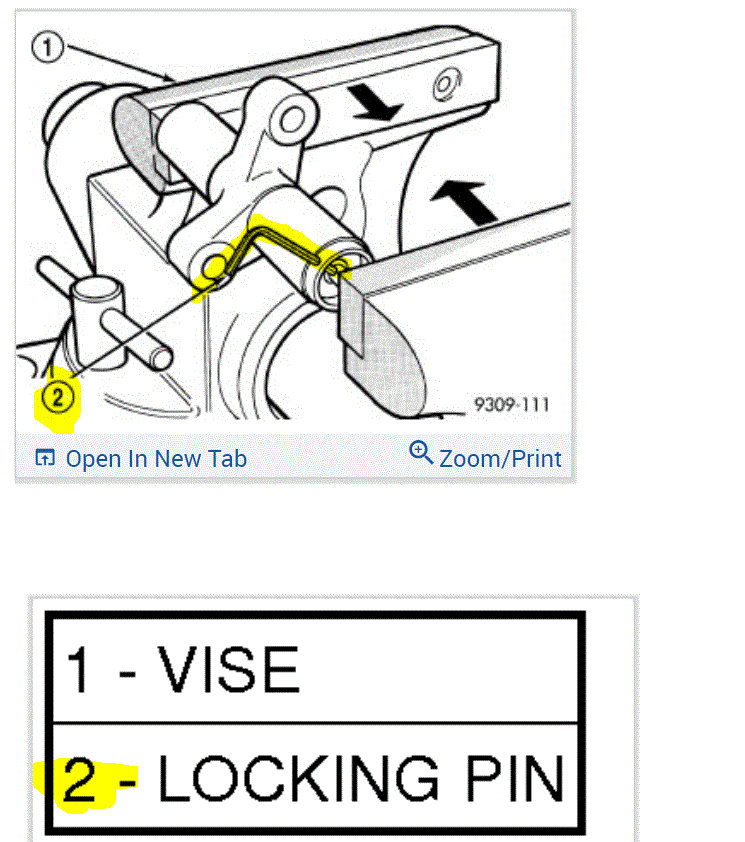

The second pic looks correct. The end is depressed and being held in by a locking pin. That gets removed once it's installed. I attached a pic from my manual showing what it should look like. See pic 1 below.
The tensioner is located right above and to the left of the crankshaft pulley. See pic 2. Pic 3 shows the tensioner depressed and the locking pin installed.
I hope this helps. Let me know if you have other questions. Also, make sure to check the water pump for bearing issues when it's apart.
Let me know if I can help.
See pics below.
Oct 14, 2021 at 6:44 PM
DIVIDES
  • 903 POSTS
Yes, i was confused but one was the tensioner pulley not the tensioner. Car doesn't have any issues overheating and the belt looks good, water pump spins smoothly. Will just change that tensioner.

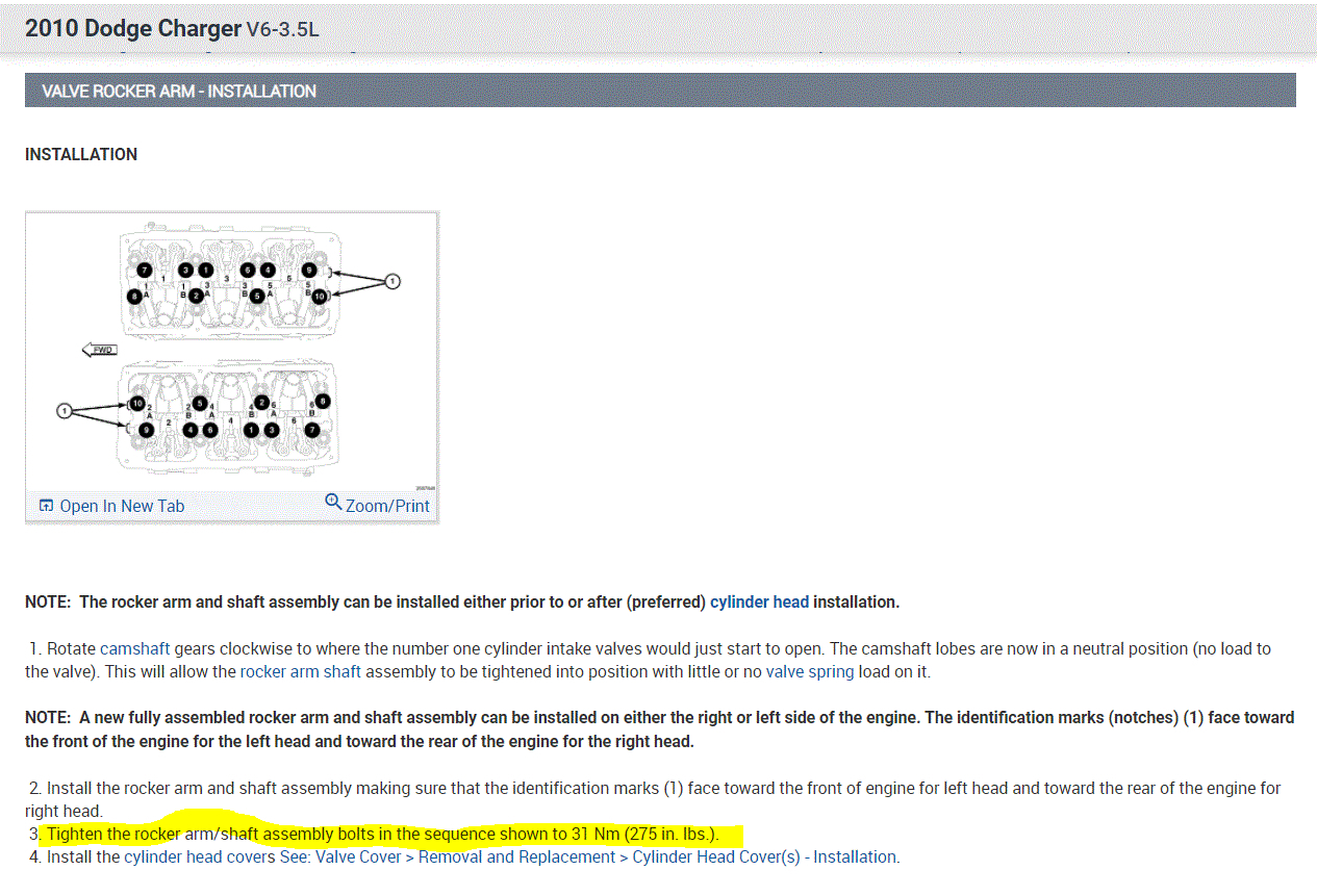

Can you do me a favor and confirm to me that the bolts to the rocker arm assembly torque at 23 in-lb?
Oct 14, 2021 at 6:58 PM
That doesn't sound right. Take a look below. I highlighted what I believe you are referring to. Let me know if this is what you needed. Also, it shows the sequence in which the bolts should be tightened.
Note, the torque is indicated in inch-pounds. If you convert 275 in/lbs to foot-pounds, it comes up as 23 ft/lbs.
If you only tightened them to 23 in/lbs, that is extremely loose. That works out to just under 2 ft/lbs
See pic below.
Oct 14, 2021 at 8:19 PM
DIVIDES
  • 903 POSTS
Holy smoke, yes i did 23 in/lbs, saw it online, but really 23ft/lb?

I thought he meant 23 in/lbs here.
https://youtu.be/0YnoH7mV_3g
Oct 14, 2021 at 8:27 PM
I just listened. Instead of saying foot-pounds, he said feet pound really fast. I had to listen twice.
If you leave them at 23 in/lbs, it's going to come loose.
Take care and let me know if I can help in any way.

I also checked on the new assembly i installed, i did torque it to 23 ft/lbs not in/lbs as it didn't make sense, i just forgot that i did.

Guessing while both rocker assemblies off. I can turn the camshafts to line them up with no issues since nothing would cause them to open and hit the cylinders.

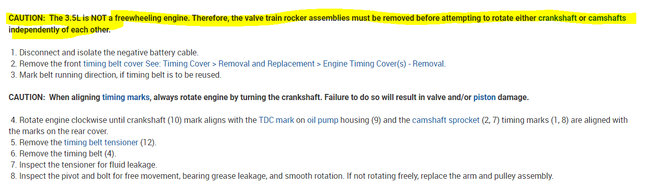

Oct 16, 2021 at 10:49 AM

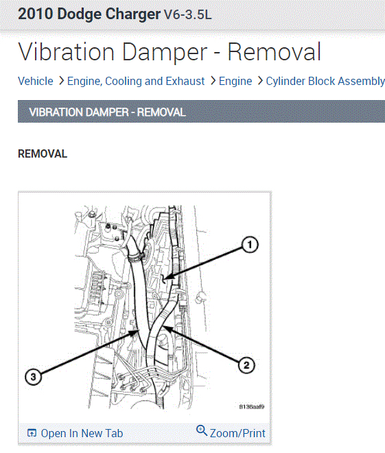

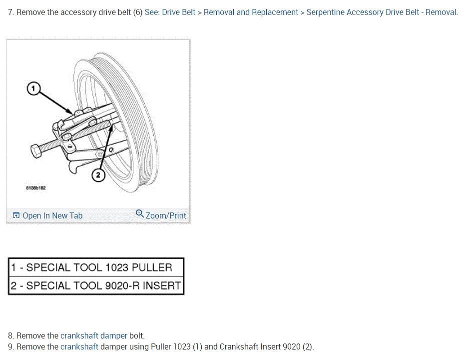

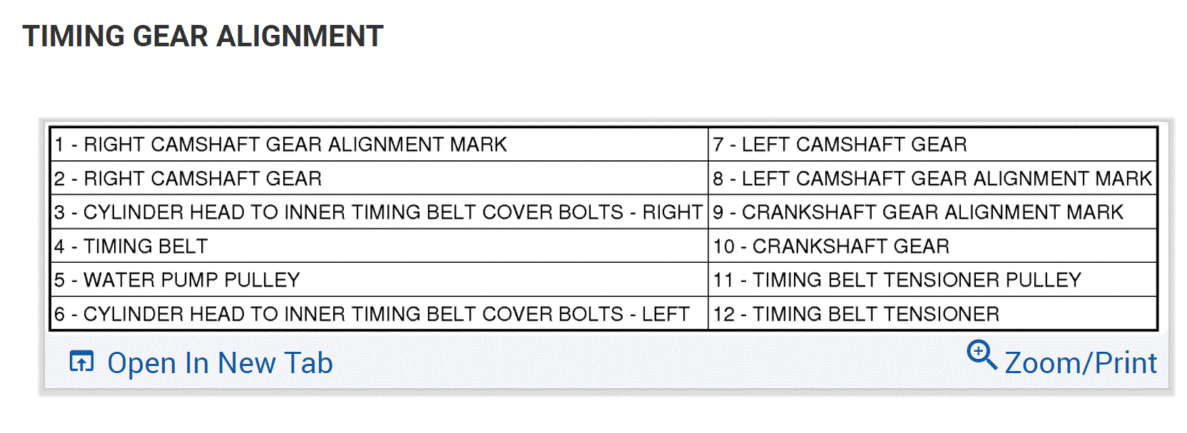

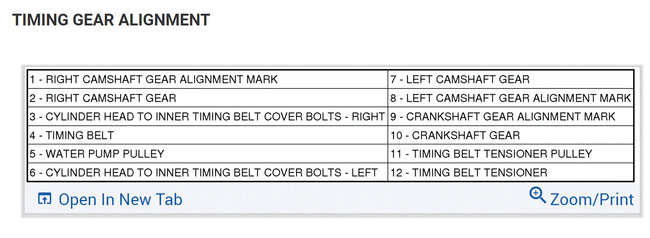

If the rocker assemblies are removed, you can turn the cams or the crank independently. As far as the harmonic balancer/crank pulley, I don't believe there is a mark on it. Check to see if there is a small V cut out of the pulley. If there is, then check to see if there is an indicator on the timing cover. If both are missing, it needs to be removed.
All you need is a standard wheel puller. Most parts stores will lend one to you.
I attached the directions below for the removal of the pulley.
See pics below.
Oct 16, 2021 at 8:42 PM

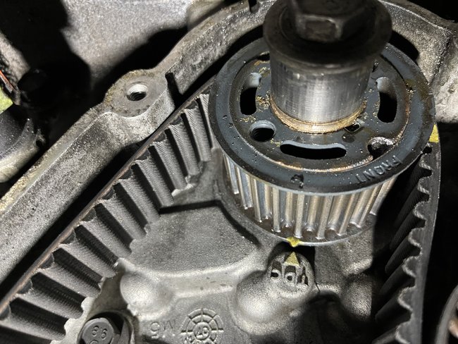

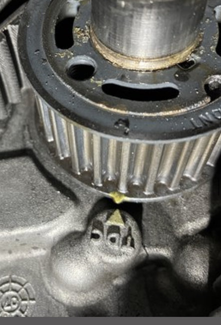

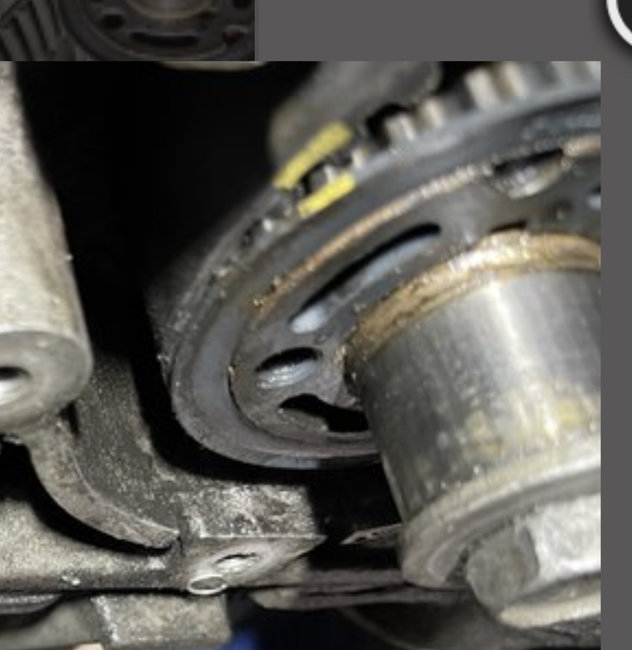

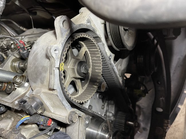

Does this look right?
And i guess i don't have to worry about valves for now since they are all closed, meaning even if i rotate the cam 180 degrees now it won't matter, right?
What about the crankshaft mark, how do i confirm its TDC and not 180 degrees off as it is, all yellow marks are from previous installation and i aligned them all. Once the tensioner is on the left cam will pull a bit to the left to align.
Oct 21, 2021 at 1:31 PM
Yes, with all valves closed, you can rotate it. As far as the timing marks, the left bank does look slightly off, but I do see play in the belt. Also, I can't see the crankshaft for certain (pic 4) because of the angle.
As long as the crankshaft marks are good, you won't be 180 out.
Oct 21, 2021 at 6:47 PM

Thanks. Hmm, i heard that you can be off 180 on some engines even with the mark lined up, unless am mistaken.
Oct 21, 2021 at 6:56 PM
DIVIDES
  • 903 POSTS
And so, if i release the tensioner I am off one tooth I'm bumming, lol.
Oct 21, 2021 at 6:57 PM
If it is one tooth off, it won't run properly. If it is one tooth off, release the tensioner and move the pulley so it aligns.
