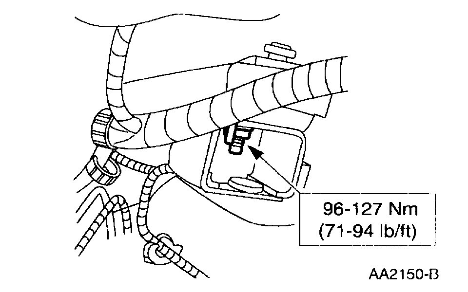

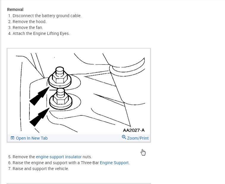

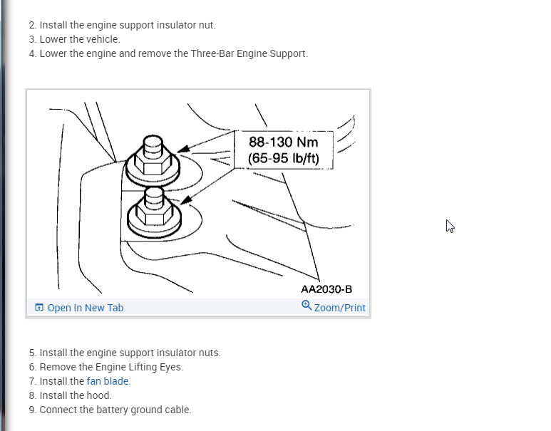

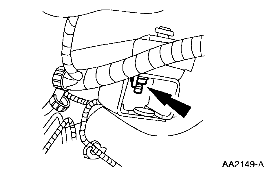

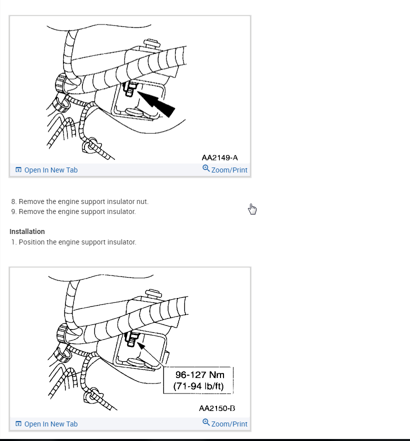

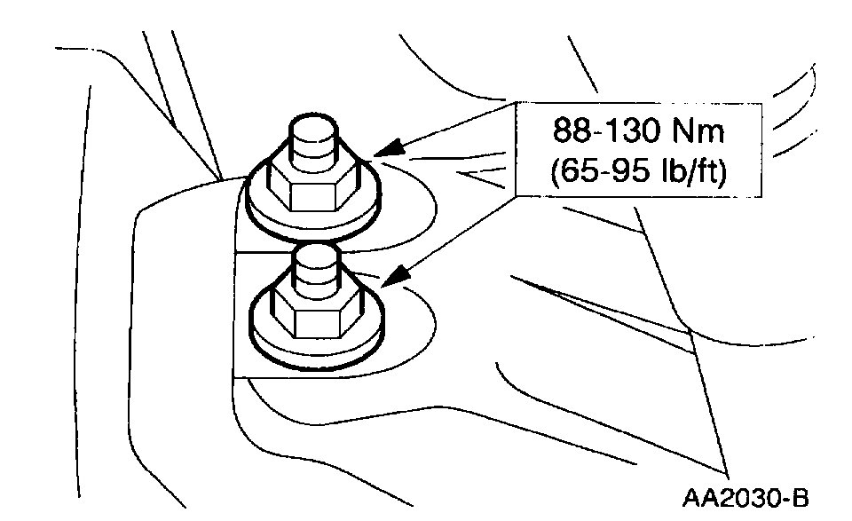

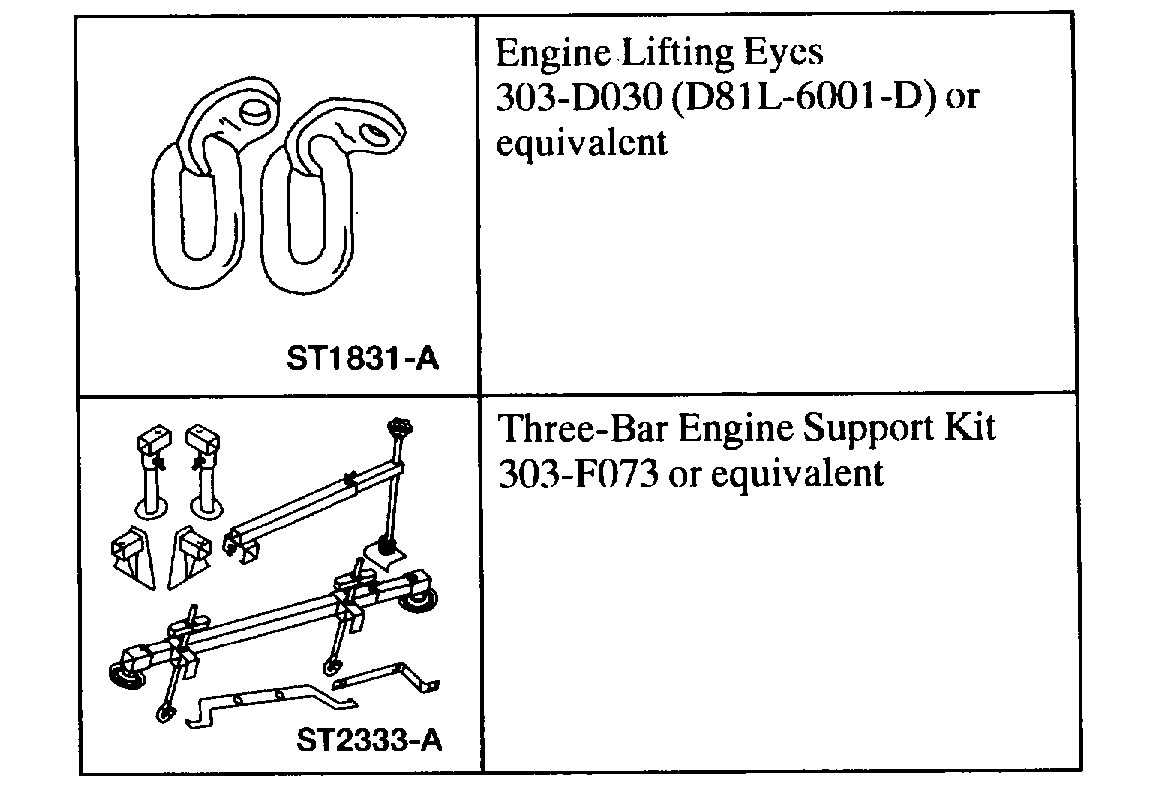

Here are the actual directions for the left and right mounts. The attached pics correlate with the directions.
2000 Ford Truck Ranger 2WD V6-3.0L VIN U
LH
Vehicle Engine, Cooling and Exhaust Engine Drive Belts, Mounts, Brackets and Accessories Engine Mount Service and Repair Procedures Engine Mount LH
LH
pic 1
Removal
1. Disconnect the battery ground cable.
2. Remove the hood.
3. Remove the fan.
4. Attach the Engine Lifting Eyes.

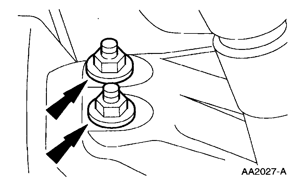

pic 2
5. Remove the engine support insulator nuts.
6. Raise the engine and support with a Three-Bar Engine Support.
7. Raise and support the vehicle.
pic 3
8. Remove the engine support insulator nut.
9. Remove the engine support insulator.
Installation
1. Position the engine support insulator.
pic 4
2. Install the engine support insulator nut.
3. Lower the vehicle.
4. Lower the engine and remove the Three-Bar Engine Support.
pic 5
5. Install the engine support insulator nuts.
6. Remove the Engine Lifting Eyes.
pic 6
6. Raise the engine and support with a Three-Bar Engine Support Kit.
