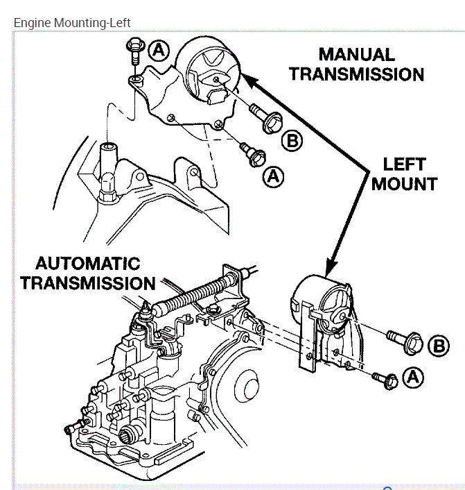

So i bought the vehicle listed above use off of a friend. It is missing a few of the engine/motor/transmission mounts and since they were not already there i am having a hard time figuring out which ones i need and where or how they go. i can't really find any diagrams to help me either. so if you could maybe help me or give me some advice it would b greatly appreciated thank you

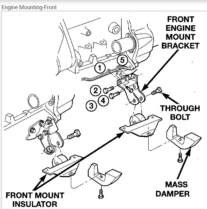

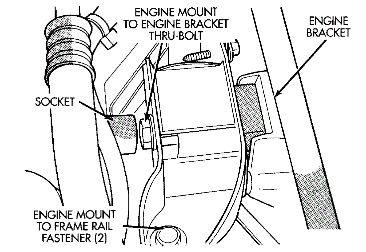

I don't know if this is what is needed, but let me know. Also, if you need help getting them installed, let me know.
Pic 1 Right engine mount.
Pic 2 Left engine/transmission mount.
Pic 3 Front engine mount.

When i look online there is like 4 mounts it's very frustrating because i'm not sure which ones to buy for my car and like you said it was already missing a mount. so I do not know where it goes. thanks for the pictures though. but i'm still very confused.

No problem. Listen, are the ones in the pics still on the vehicle? The manual is only showing three, but anything is possible. I do need to confirm something. You indicated it's a 1998 with a 2.4L engine. I suspect that was a typo because the only engine used in 98 was a 2.0L. Can you confirm that for me?
Also, hang in there. We'll get it figured out.
