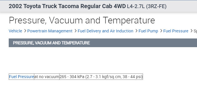

If you are unable to find any leaks, I would move to checking fuel pressure to make sure it is within spec.
Here is a link that explains how that is done:
If you look below, I included the manufacturer's fuel pressure specifications.
Let me know what you find.
See pic below.
