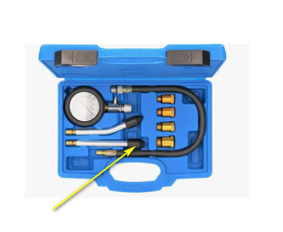

As you have tested all required components, I would suggest getting yourself a push on compression tester. see image below.
Cheers, Boris
