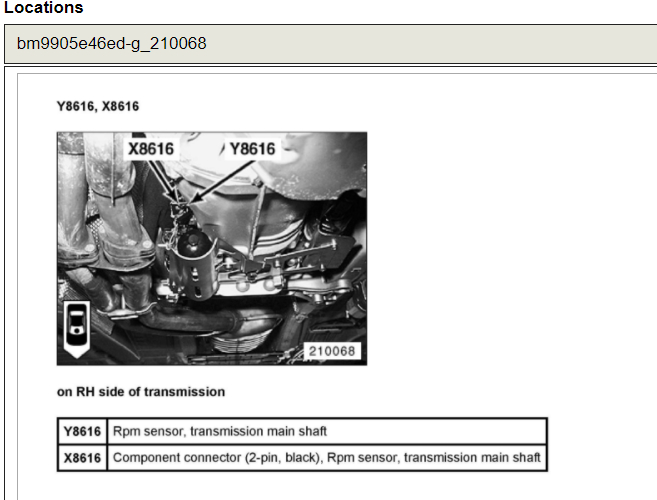

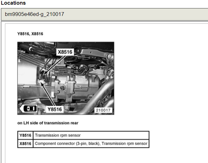

These codes can be caused by a shaft speed sensor that is out of range. Here are the sensors locations. I would try the sensors first
Check out the diagrams (below).
Feb 13, 2018 at 7:13 PM

Is this for the manual gearbox?

My bad, I did not see the transmission type. I would go with what Steve W. has suggested.
