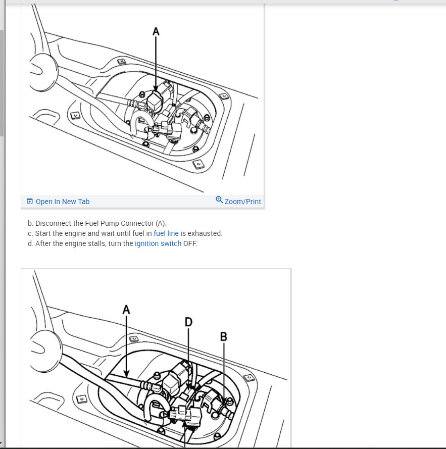

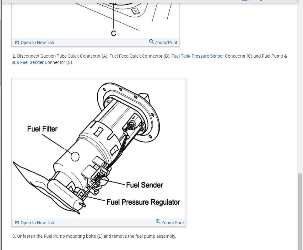

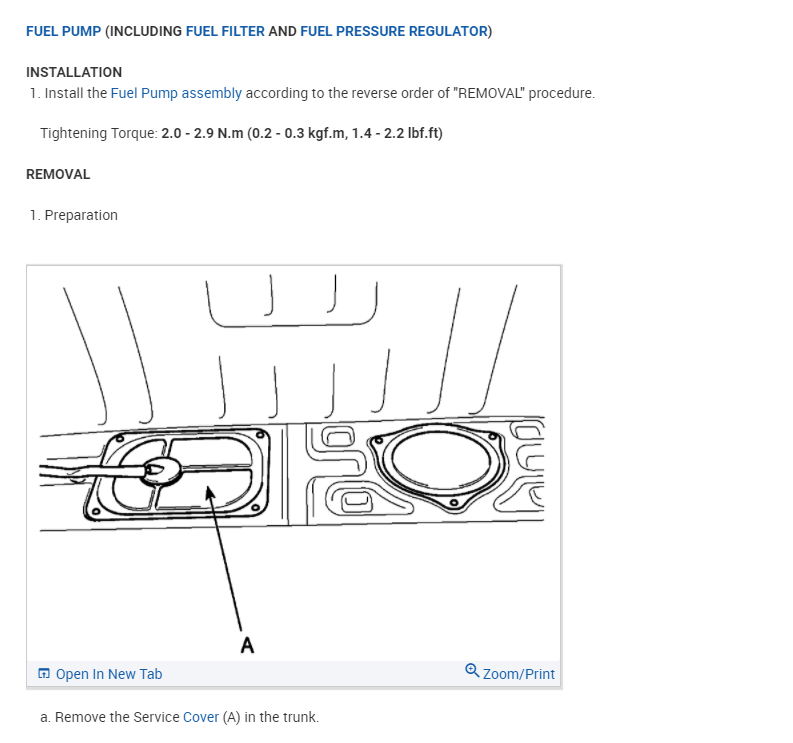

I am attaching the info on the filter which is part of the pump in the tank. The nice thing is you have an access panel, and you don't have to drop the tank.
This can also help to inspect what is in the bottom of the tank but let's start with the pressure and go from there.
