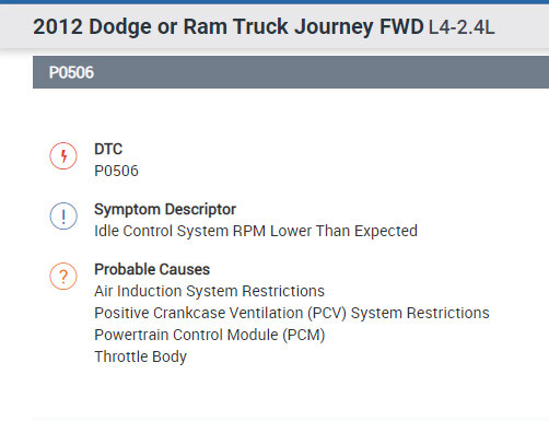

No problem. I never heard of using WD40 for cleaning the throttle body. Normally, I use carb cleaner. LOL
As far as the codes are concerned, I think they will help. If you look below, I attached an example. Note that it indicates possible issues to check.
Let me know what you find.
See pic below.

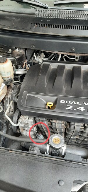

So, I just had it scanned, there were a couple of codes. Mostly about valve timing, if I'm not mistaken. He cleared the codes, but the engine kept doing the stutter. The mechanic said it's probably time for the timing chain to be replaced. I think on this engine it should be changed at 60,000 miles, and I'm just over that. What made us curious was that the engine light doesn't turn on when I turn on the vehicle. I've never seen it light up. He thinks maybe it burned or the guy who sold it to me covered it with some tape.
He also told me to check and clean the sensor in the picture.

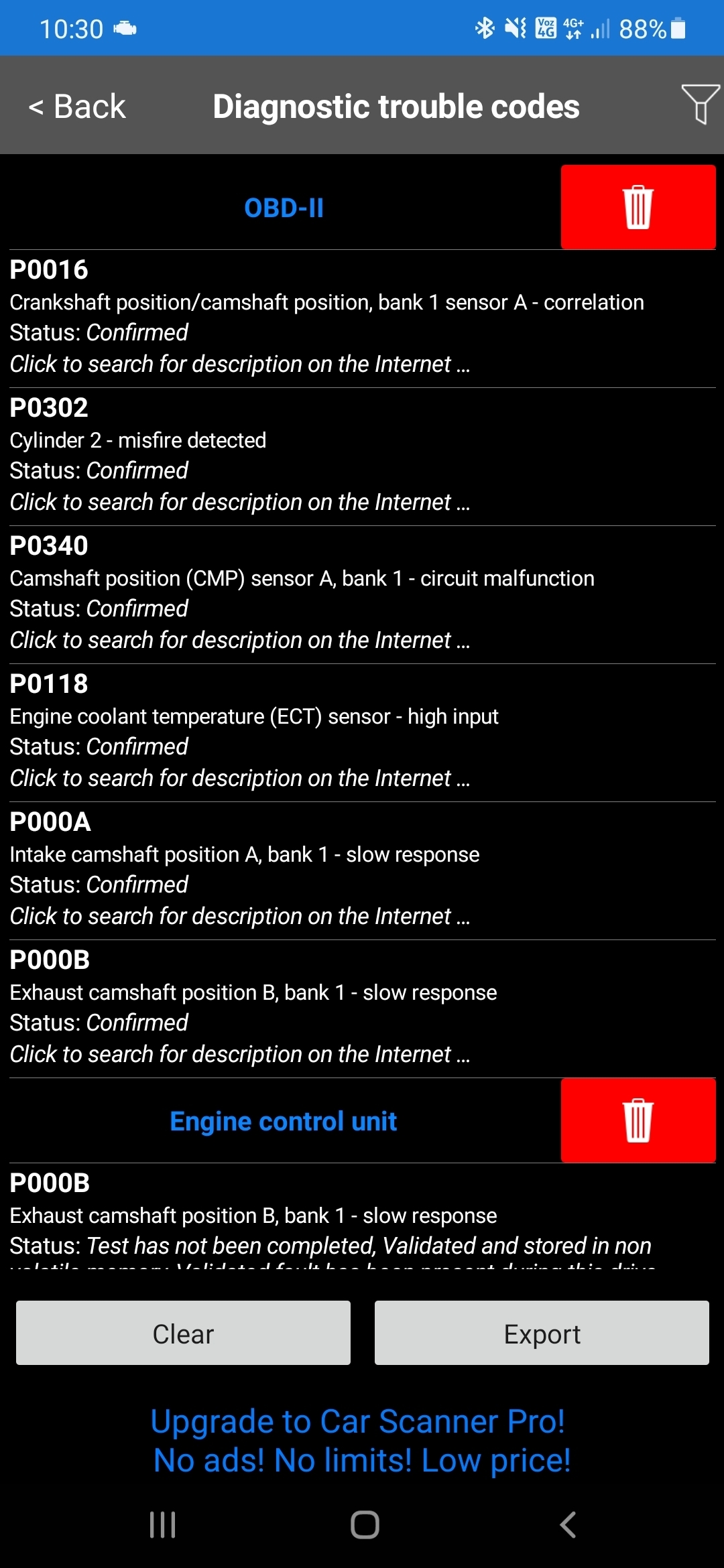

Alright, so...
I did a trip. 110 miles to my brother's house. All good, except for the idle issue. When heading home, did about 20 miles and all was good. I had the music on, so I didn't hear till I passed a semi and in the pause between songs, heard the engine doing a constant 'rrrrrrrrrrrrrrrrrrrr.....'
I want losing speed or anything, just the 'rrrrrrrrrr'.
I stayed at 50-60 mph. I didn't want to pull over, because if I had to shut the engine off, I didn't know if it would start up again. And in the middle of the night, in a dark road, in the country, I didn't want to risk it.
About 80 miles later, I made it to the highway where at least I had light posts. As soon as I merge in, noise got worse, and oil light came on.
Pulled over, shut it off, and check on the trunk where I knew I had an oil bottle the previous owner left there.
Only about 250 ML of 5w40 (I think about 9 Oz)
Started again, and drove at a constant 45mph till I made it home, about 10 miles away.
Engine shut off in the traffic light in my block, started again, made it inside the garage and has been off since because I've been away since Monday morning.
Checked oil level this morning and it's where it should be. And a friend let me borrow an OBD-2 scanner and got the following.
May 12, 2023 at 9:10 AM
I wouldn't have pulled over either. LOL I looked at the codes. There are a lot of them. However, the first one I need you to check is the P0118, coolant temp sensor. If that is off, it can cause havoc. The idea that you have the cam/crank sensor codes is a bit difficult for me to accept with the mileage on the vehicle. However, it is possible.
So, if the scan tool you have has live data, connect it. Check to see what the coolant temperature signal indicates. It should be close to the ambient temperature outside before starting it.
