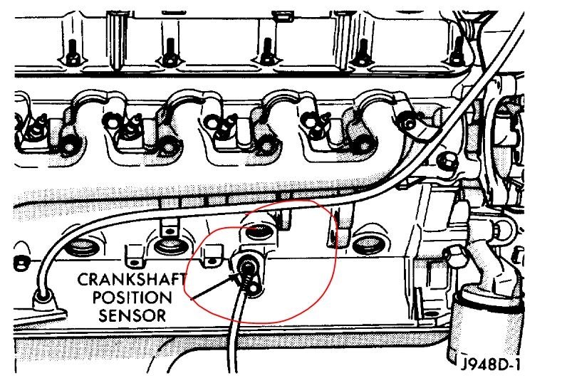

Now, if the check engine light never stayed on, it could still be this sensor. How I determine if it is bad is by using a live data scanner to see if the RPM signal stops when the engine stalls. If it does, this is my first suspect.
If you look at picture 1, it shows the location of the sensor. I circled it for you. If you determine this is the problem, here are the directions for replacement. The remaining pictures correlate with the directions.

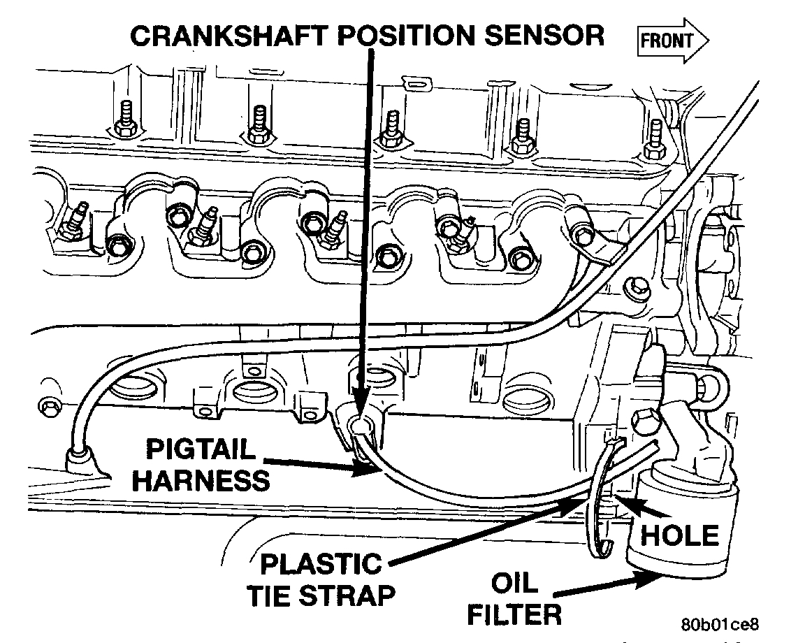

Crankshaft Position Sensor Location
pic 2
The crankshaft position sensor is located on the right- lower side of the cylinder block, forward of the right engine mount, just above the oil pan rail.
REMOVAL
1. Raise and support vehicle.
2. Disconnect sensor pigtail harness from main engine wiring harness.

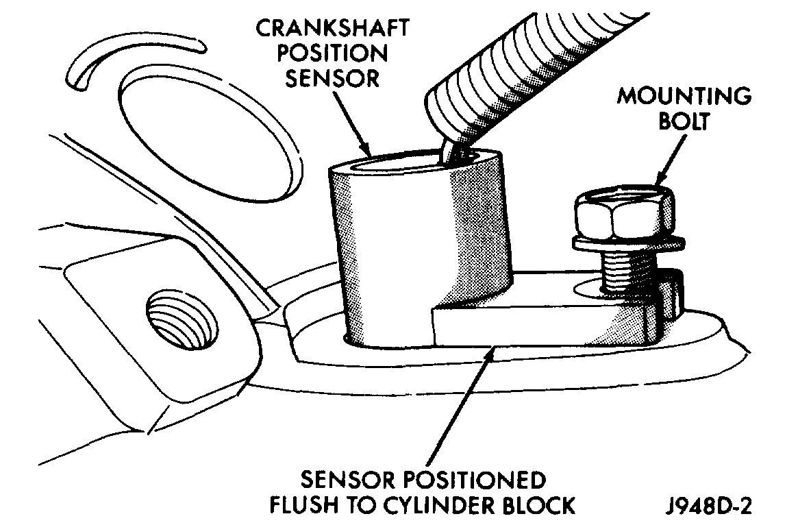

Sensor Removal/Installation
pic 3
3. Remove sensor mounting bolt.
4. Cut plastic tie strap securing sensor pigtail harness to side of engine block.
5. Carefully pry sensor from cylinder block in a rocking action with two small screwdrivers.
6. Remove sensor from vehicle.

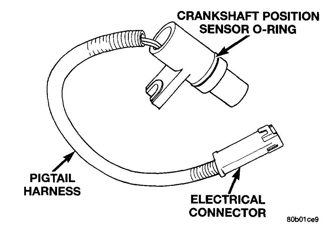

Sensor O-ring
pic 4
7. Check condition of sensor O-ring.
INSTALLATION
1. Apply a small amount of engine Oil to sensor O-ring.
2. Install sensor into cylinder block with a slight rocking action. Do not twist sensor into position as damage to O-ring may result.
CAUTION: Before tightening sensor mounting bolt, be sure sensor is completely flush to cylinder block . If sensor is not flush, damage to sensor mounting tang may result.
3. Install mounting bolt and tighten to 8 Nm (70 in. lbs.) torque.
