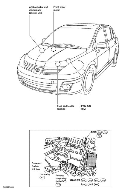

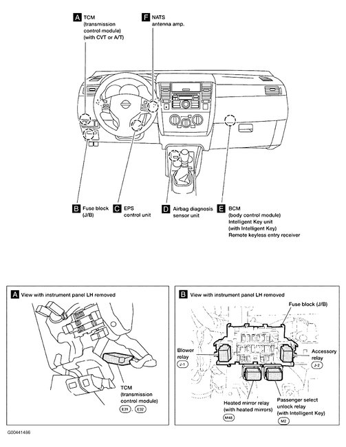

Aside from that, raise the hood and look and see if there is anything obviously wrong. Mainly, look for hoses that are unplugged or broken. If you do not see anything wrong, then check your fuses. Fuse box locations and information should be in your owner's manual. If you do not find any blown fuses, then more advanced diagnostic work is needed. Start with what I have outlined above and let us know.

https://www.2carpros.com/articles/how-a-car-fuse-works - See this link for information on checking fuses.
