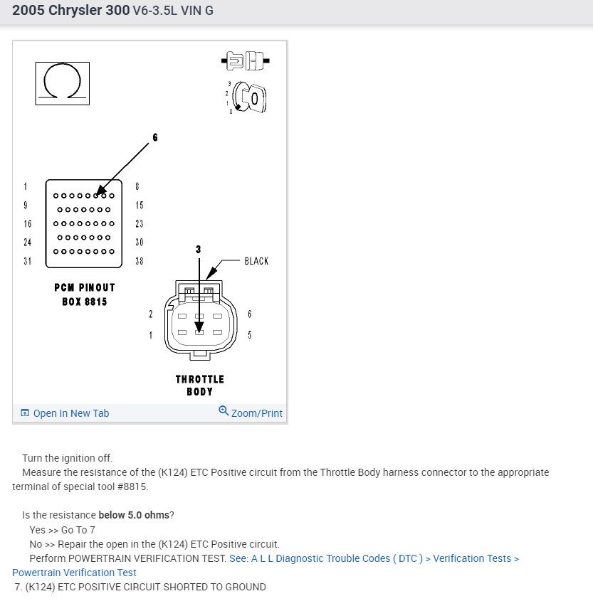

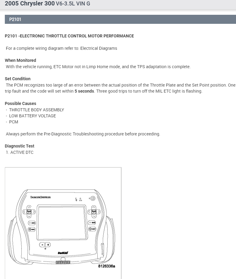

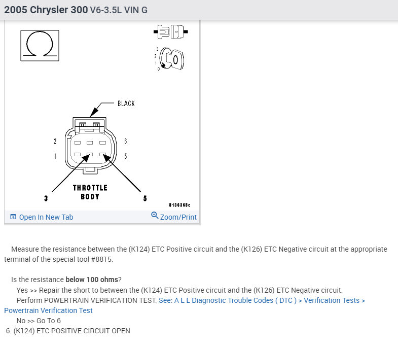

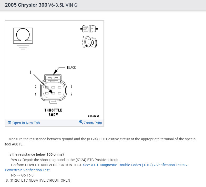

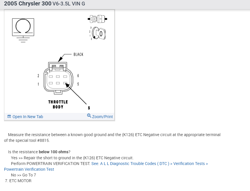

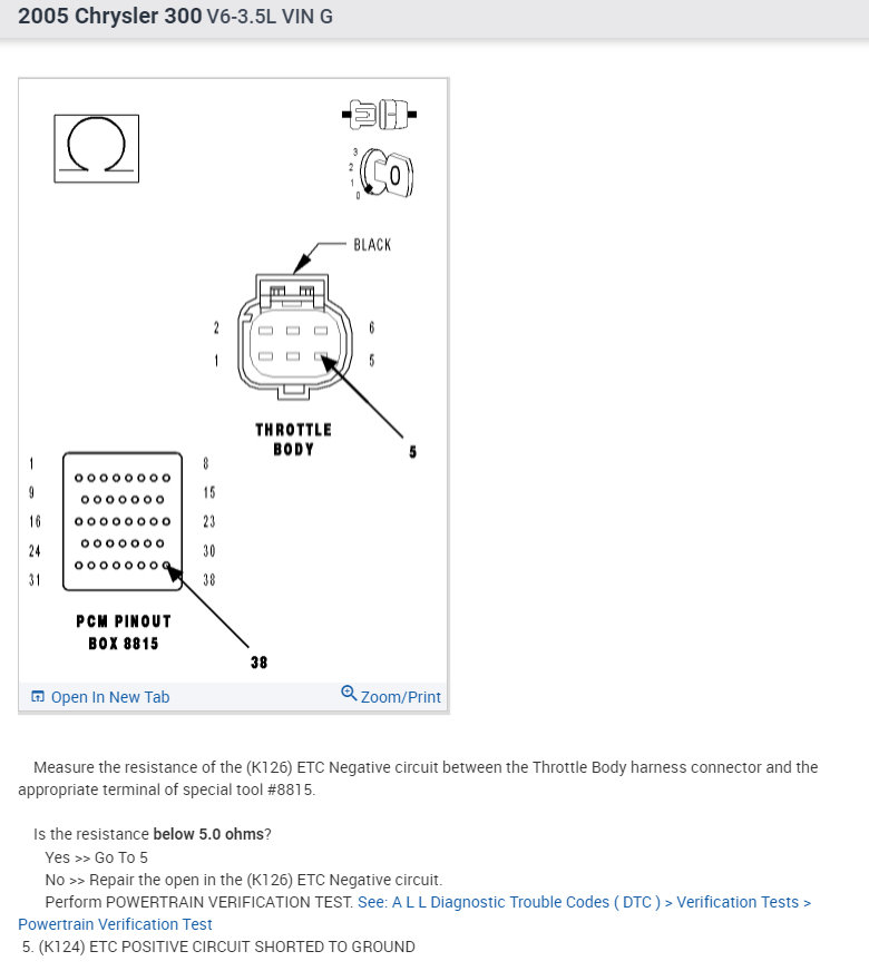

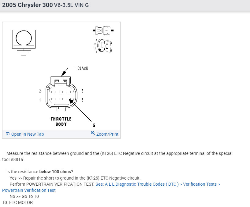

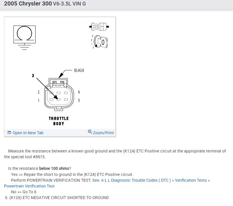

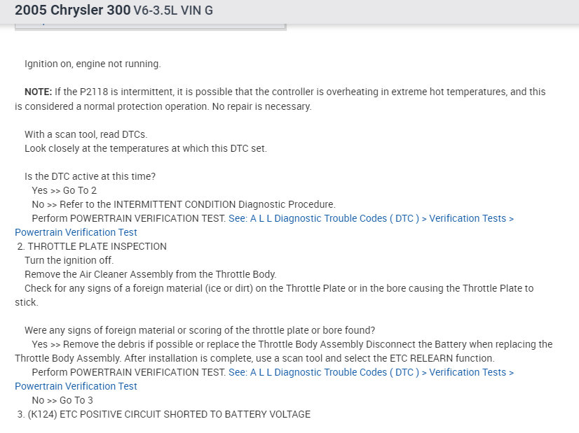

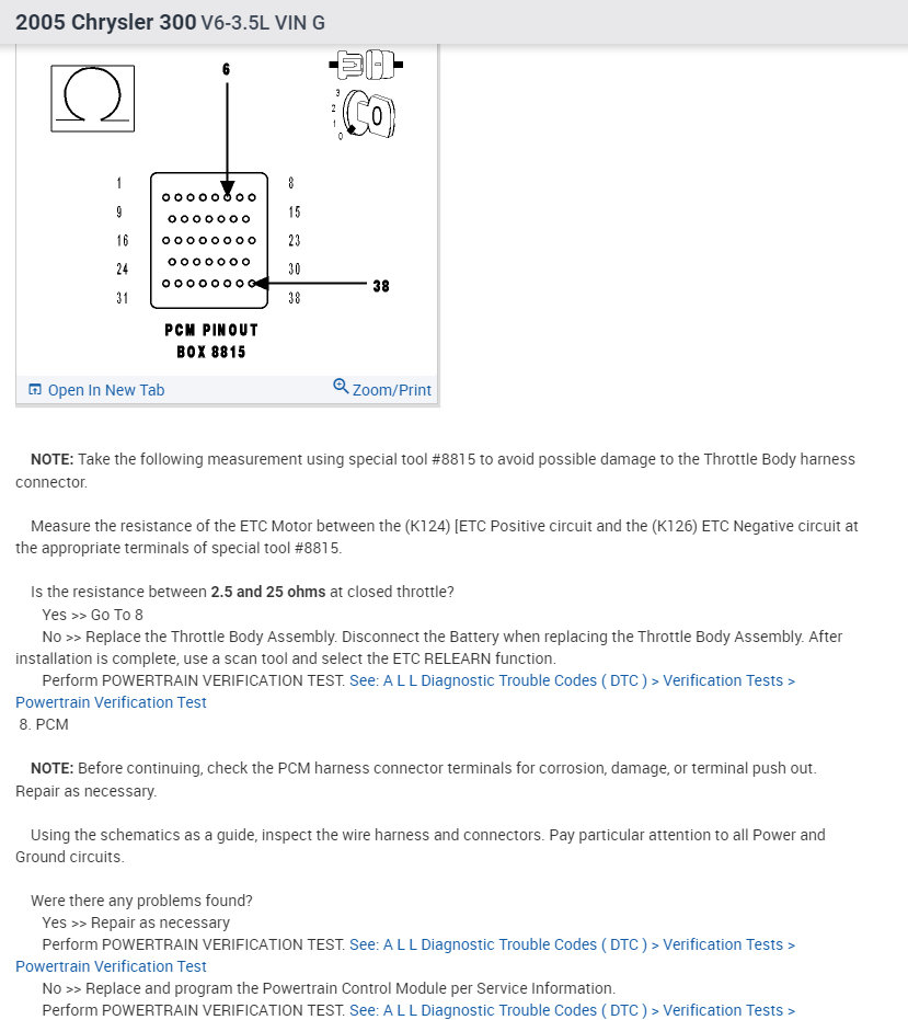

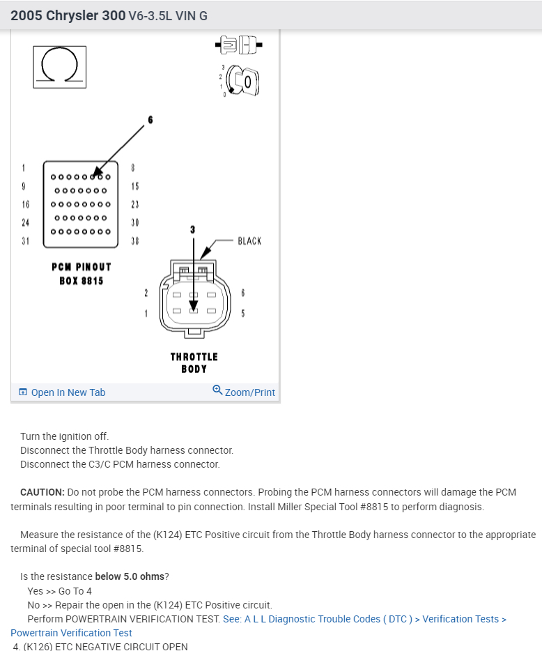

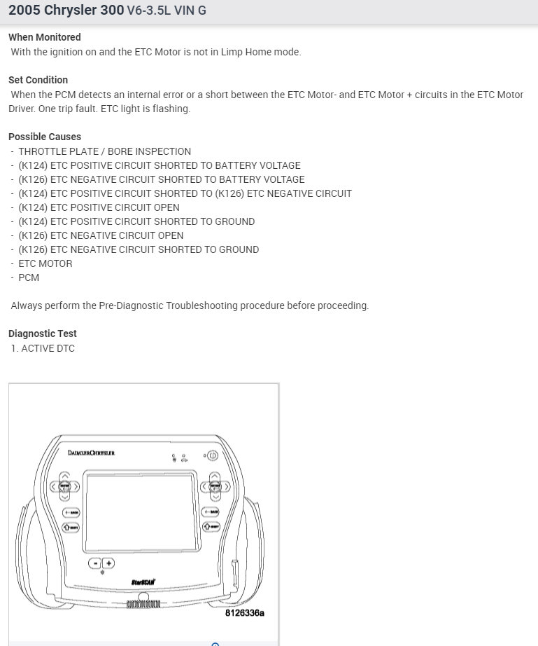

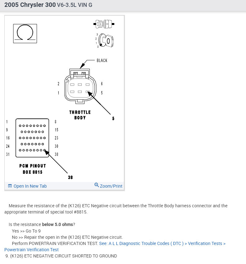

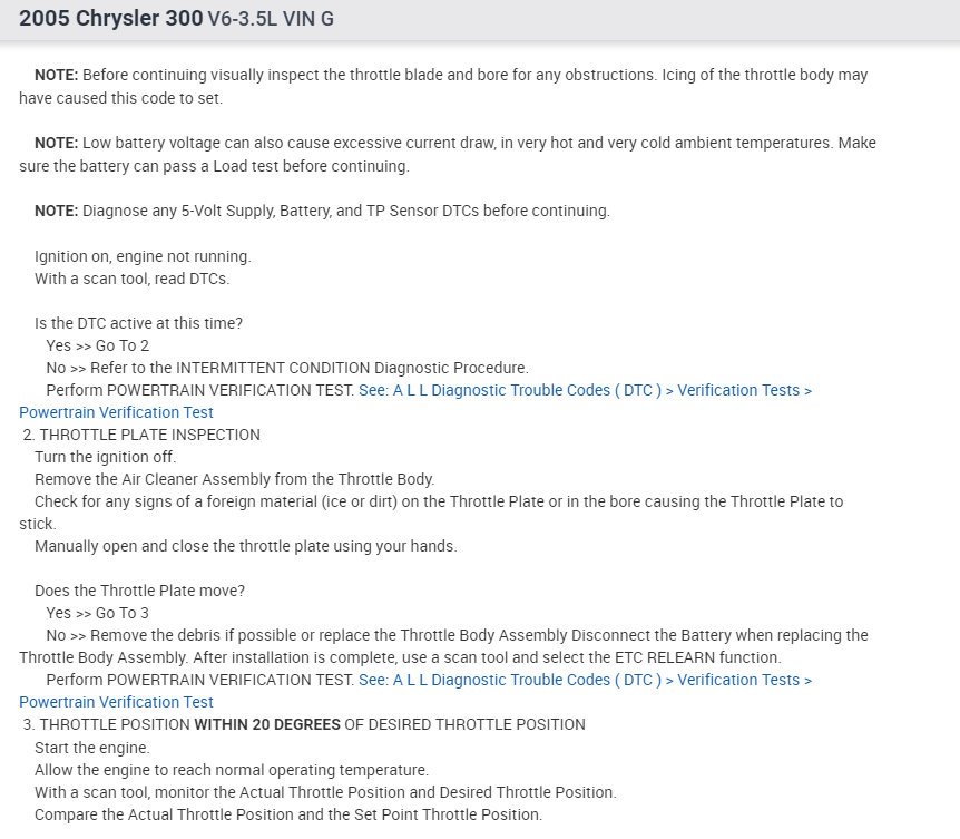

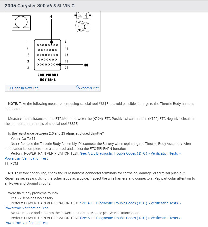

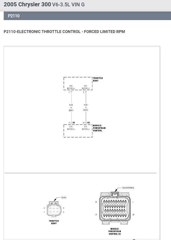

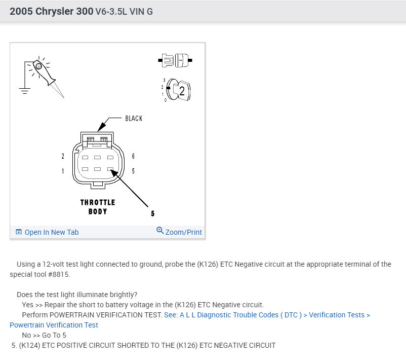

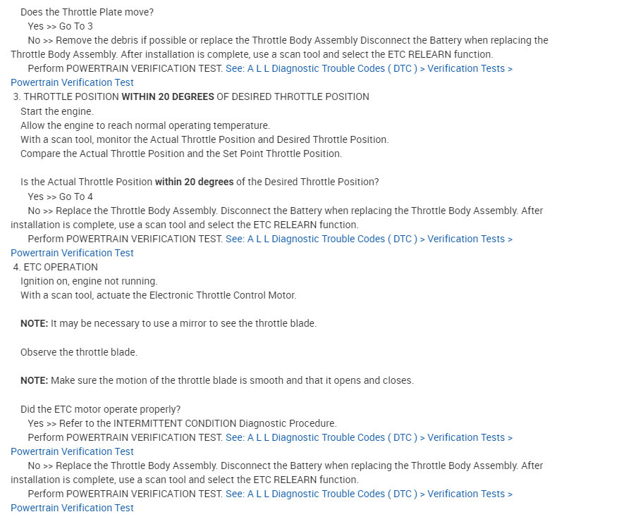

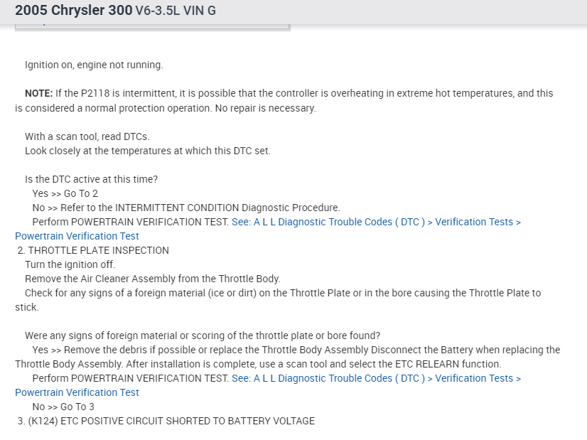

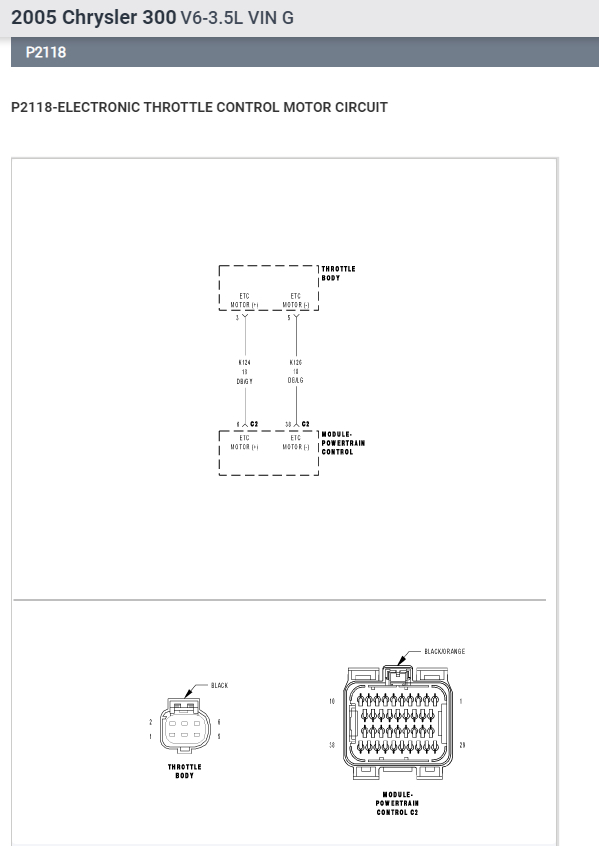

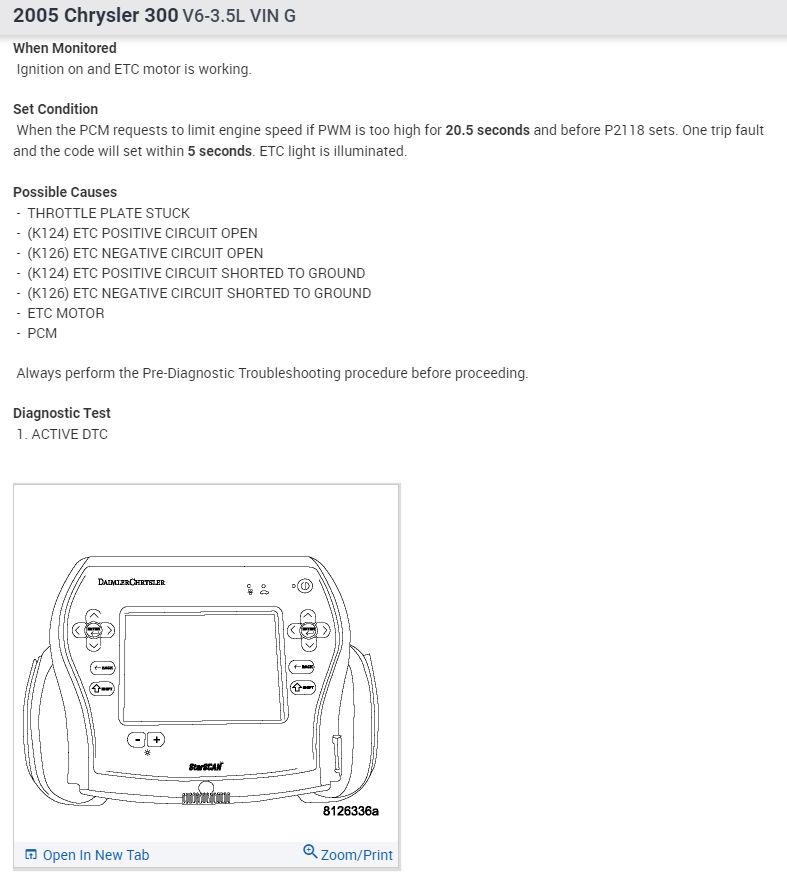

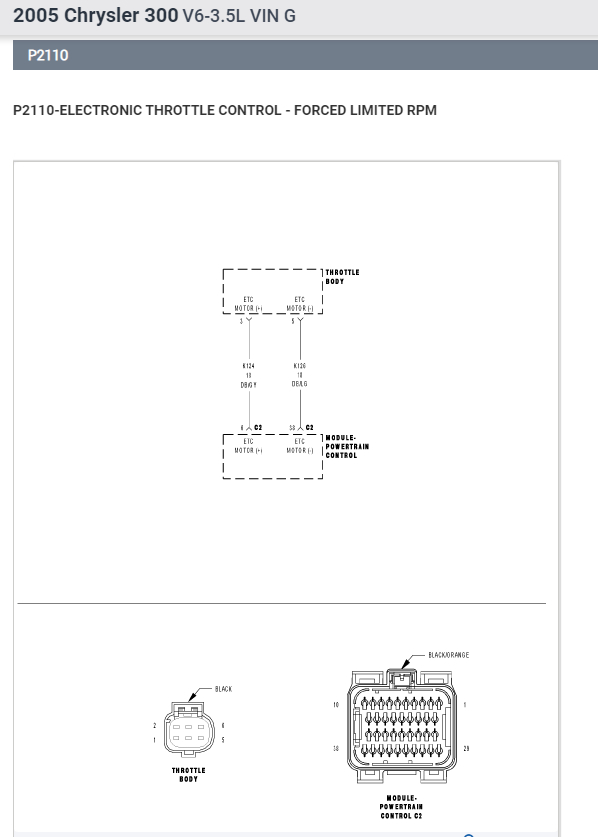

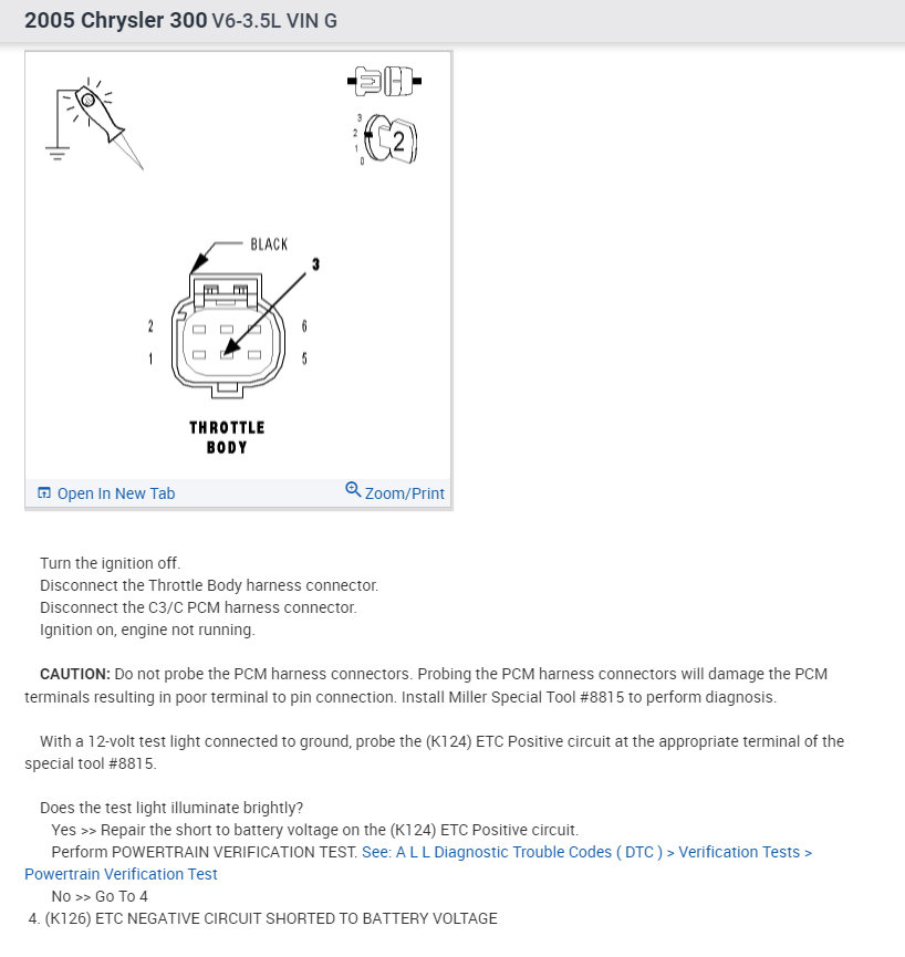

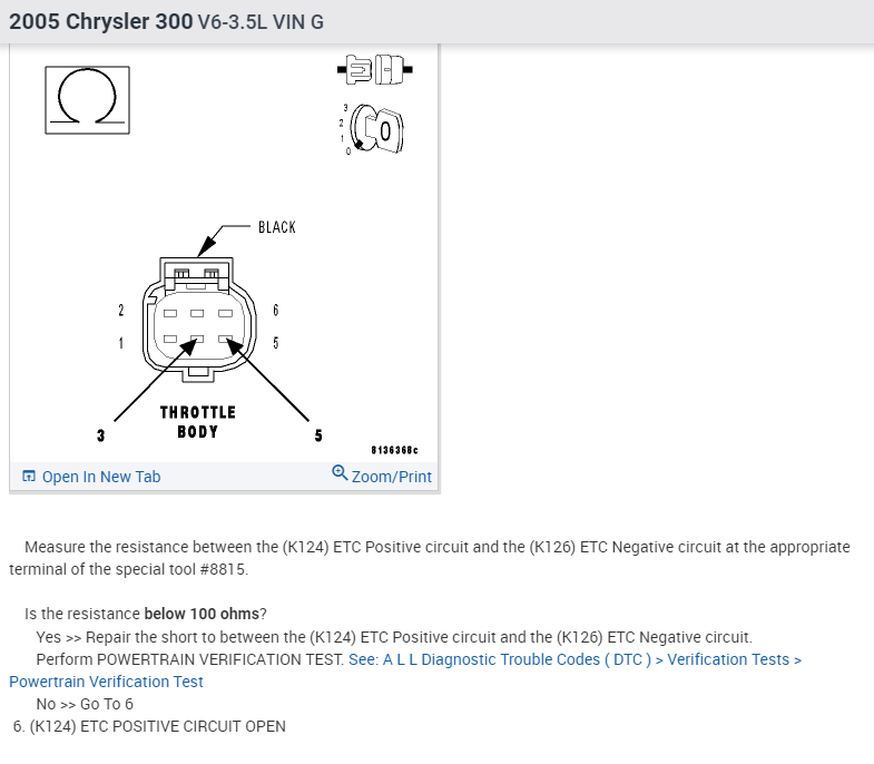

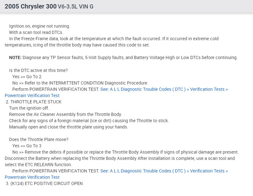

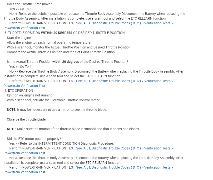

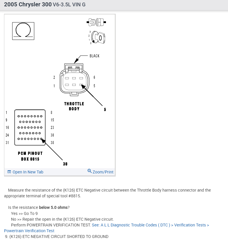

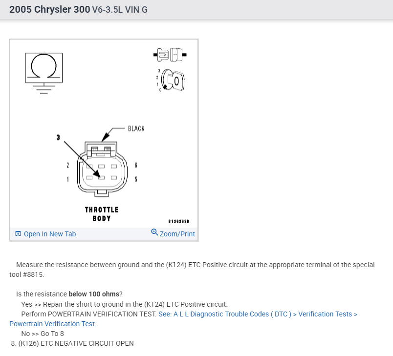

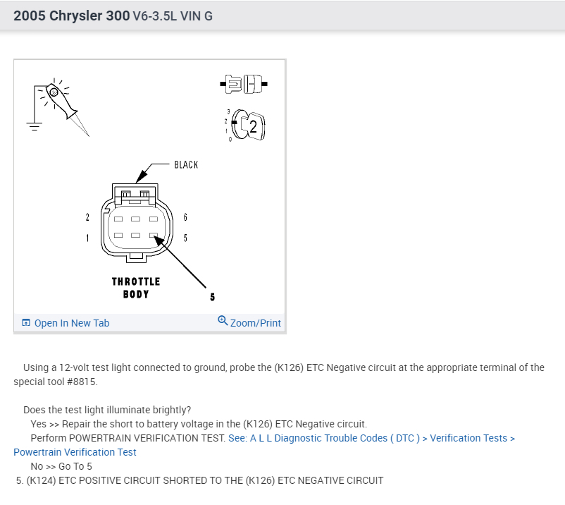

Did you clear the codes after replacing the actuator?
All those codes are related to the throttle actuator or the wiring for the actuator.
This could also be due to an issue with the PCM.
I have attached the detailed trouble shooting guide for P2110, P2118 and P2101 codes below.
Following those steps can help you determine the issue.
Thank you.
