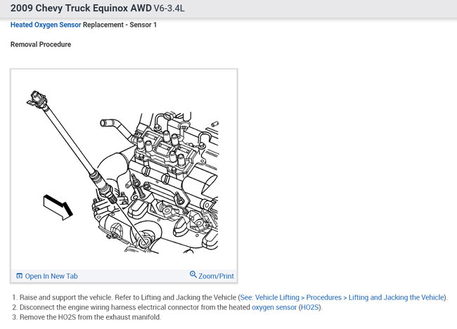

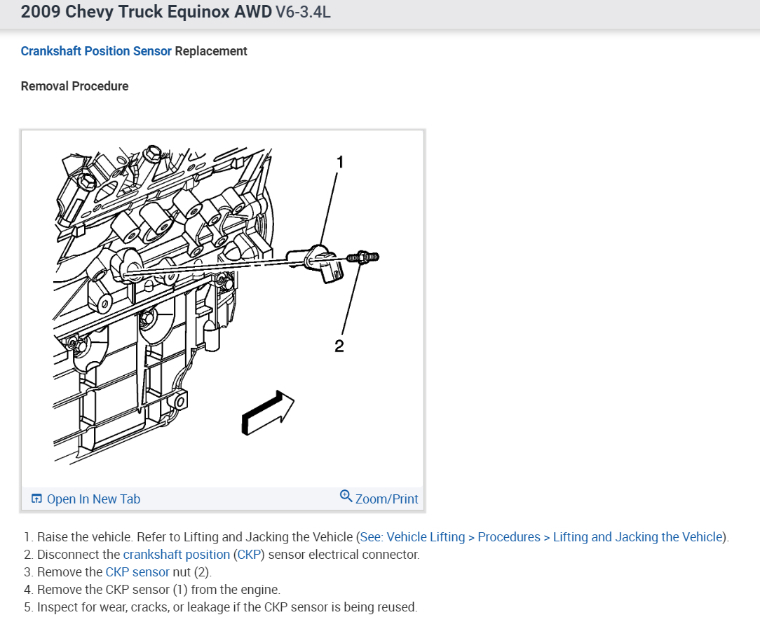

These codes are for the crankshaft sensor and the O2 sensor, I would replace both and clear the codes to see what happens. Here are guides and instructions to help you fix the problem:
P0050 HO2S Heater Control Circuit (Bank 2 Sensor 1) - OBD-Codes
P0018 Crankshaft Position - Camshaft Position Correlation (Bank 2)
This guide will walk you through the oxygen sensor replacement:
https://www.2carpros.com/articles/how-to-replace-an-oxygen-sensor
and to clear the codes.
https://youtu.be/ahK_eucFi-k
