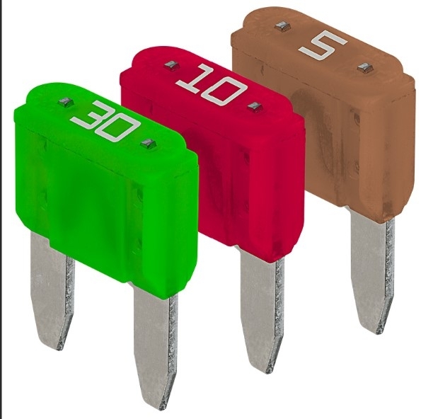

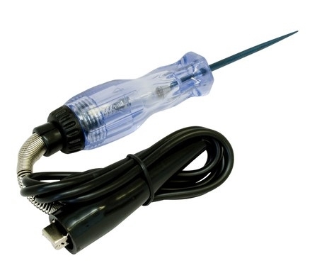

I would check all my fuses using a test light. I am adding an article for you that will help walk you through the procedure. It's very easy.
Replace any blown fuses and see if the light is back on.
