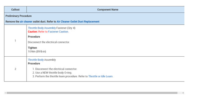

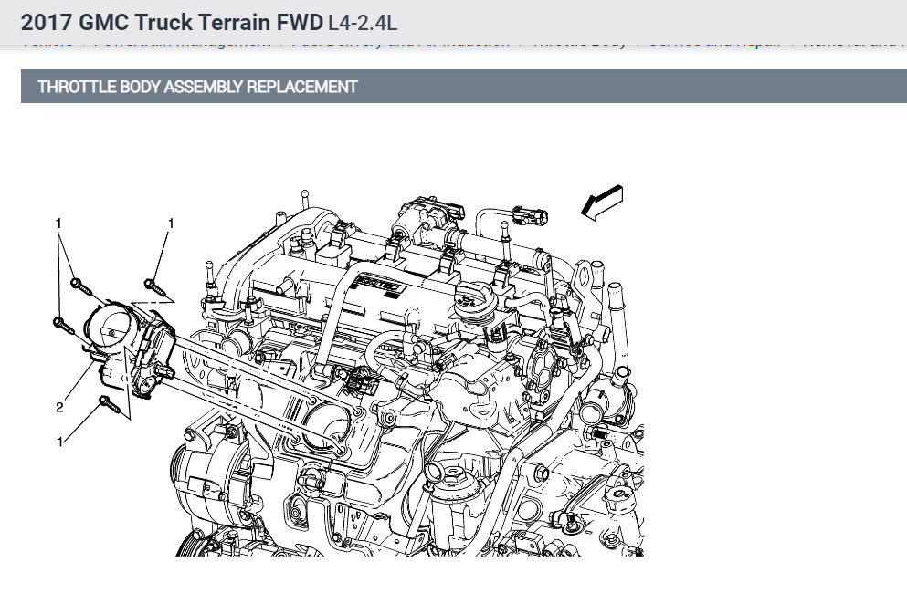

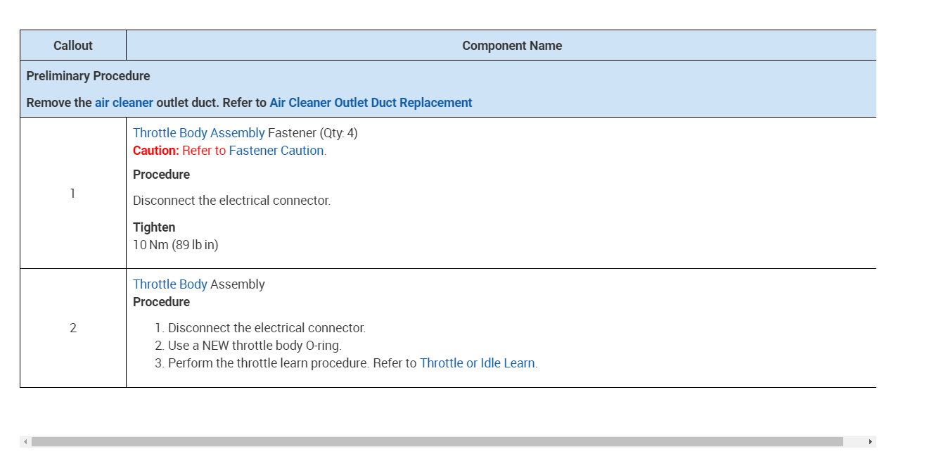

This sounds the throttle bore has gone out but to be sure we need to run the codes, here is a guide to help and I have included how to change the throttle bore out in the images below in case you need them.
Check out the images (below). Let us know what happens and please upload pictures or videos of the problem so we can see what's going on.
