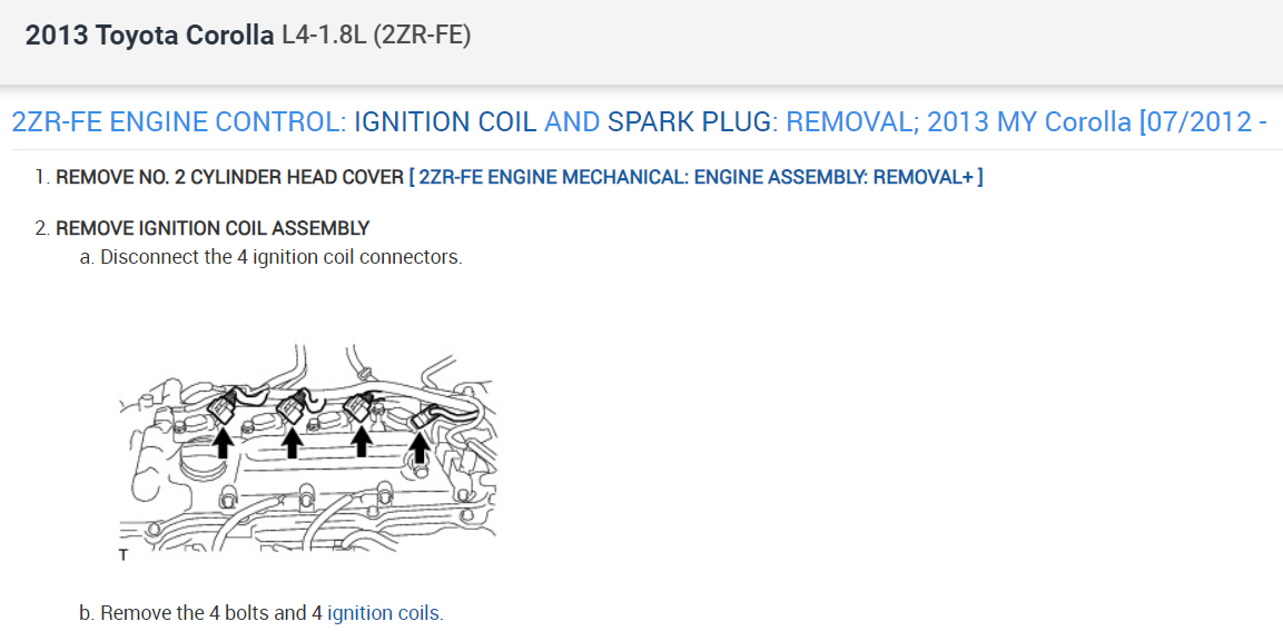

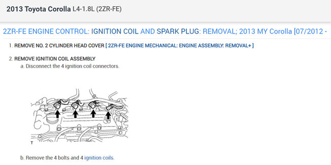

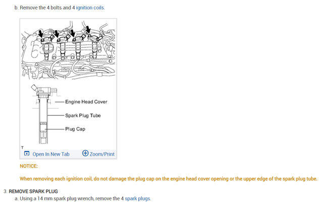

Please go over these guides and get back to us. Here is how to change the coil out. Check out the images (below).
