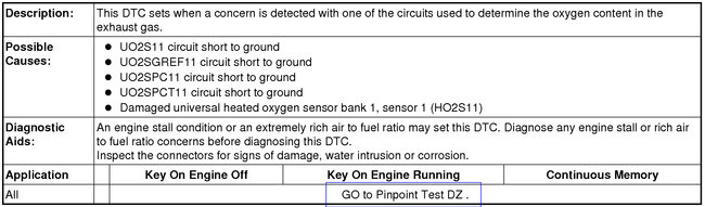

Two weeks ago Ford replaced 02 sensor. Engine light has come back on ,code says po131 low voltage sensor #1 bank1. Can I drive it until I get home about six hundred miles? Runs fine just light on.
Oct 15, 2018 at 6:06 AM
The low voltage could be the result of a corroded, damaged, or loose connection. It should be okay to drive. However, fuel mileage may be off. This system may run rich.
I attached a picture for you to review. It is a diagnostic flow chart for this code. Take a look and see if you can check some of the things mentioned. Make sure no wires to the sensor have melted and shorted.
Let me know if this helps.
