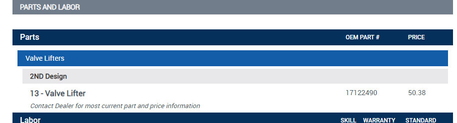

I attached the part number for the lifters below. Let's make sure they are correct.
