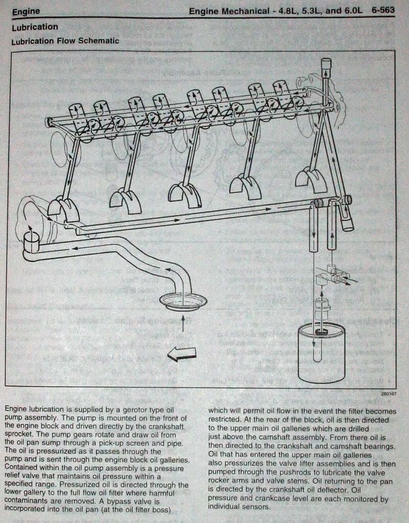

I have a 5.3 engine the engine and it is knocking and is only oiling one lifter.
Dec 25, 2016 at 8:48 PM
STEVE W.
  • 15,113 POSTS
If it is knocking and no oil up top put a pressure gauge on it and see what it shows. The 5.3 oils the top end first so if there is no oil there it is not getting anywhere else. Could be sludge blocking the oil pick-up, scored pump or blockage farther in the oil circuit. If it has been run that way very long it will probably be a rebuild or replace type repair.

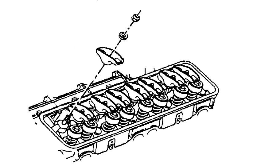

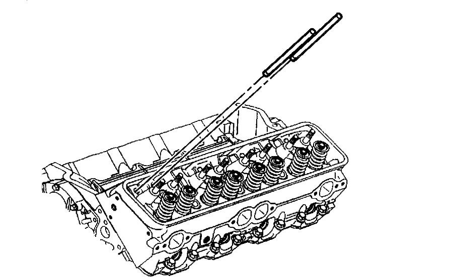

Good morning.
The first thing I would do is remove the valve covers and inspect the rocker arms. Sounds like you have a broken rocker arm. Check out the diagrams (Below). Please let us know if you need anything else to get the problem fixed.
