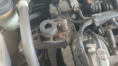

My daughter was driving down the interstate and she heard a noise and the van lost power and she did make it to the exit ramp. I had it towed to my house. It starts and idles fine but with a really loud knocking sound. Loses power when putting it in gear. The noise appears to be coming from the firewall on top of the motor. Blown engine??

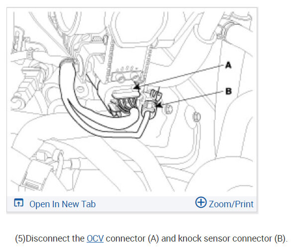

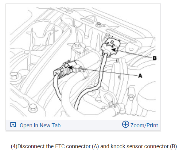

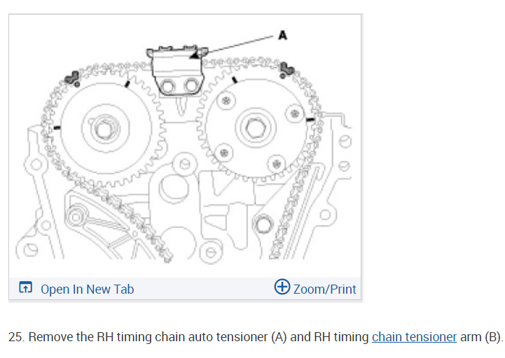

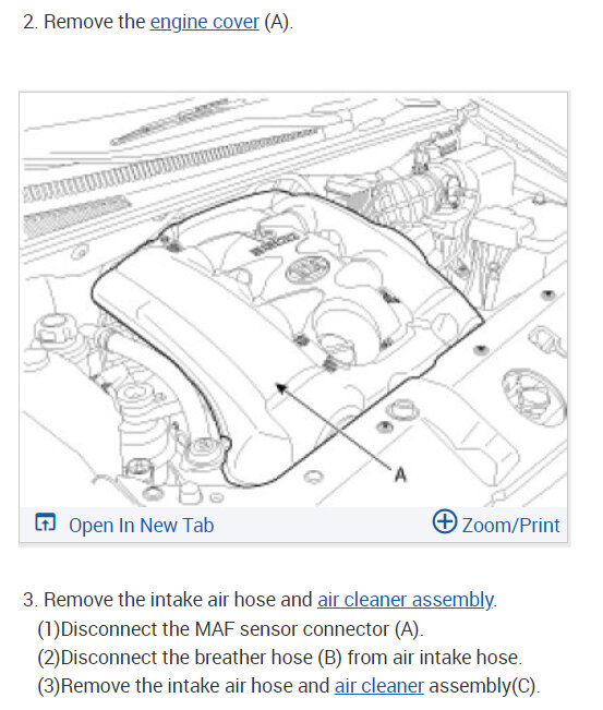

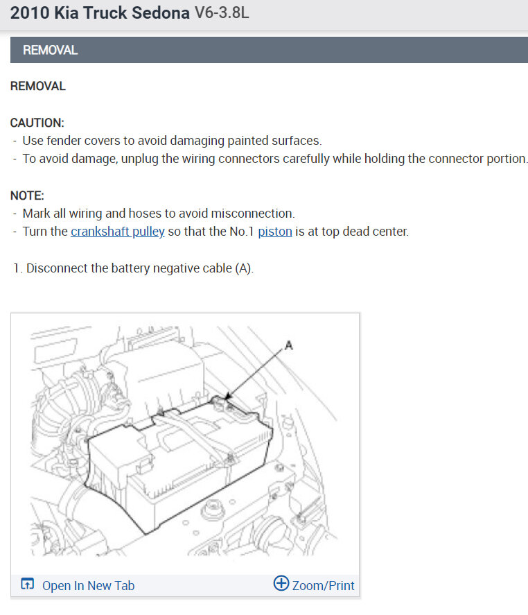

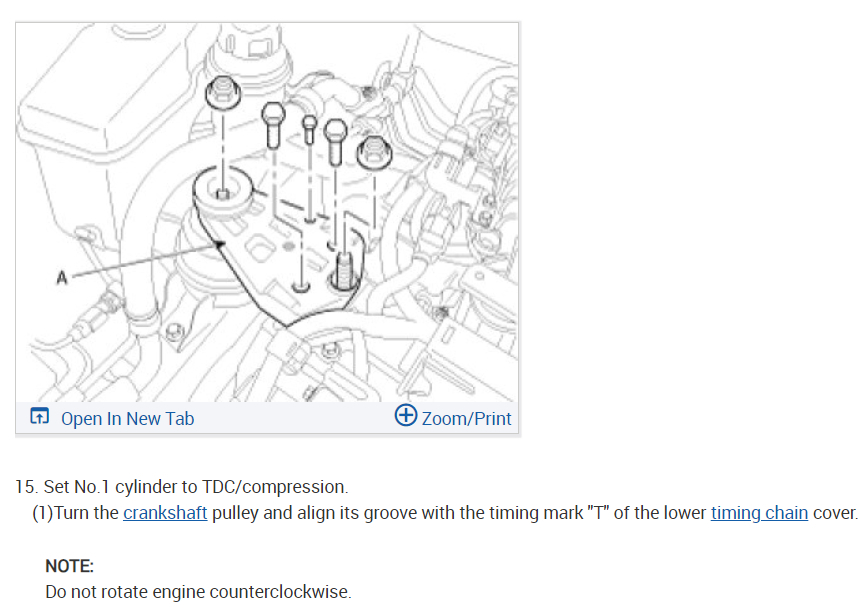

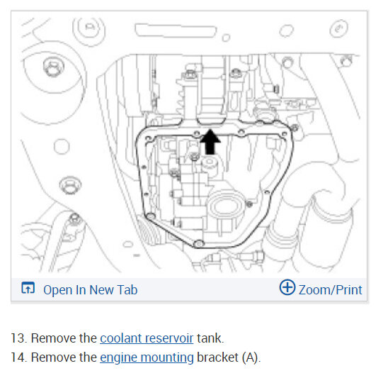

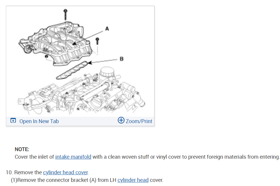

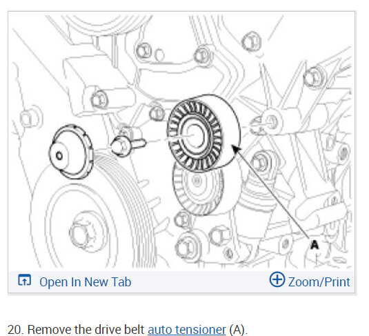

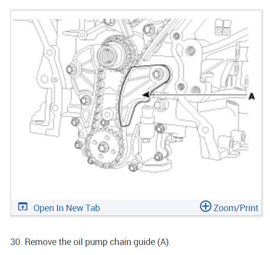

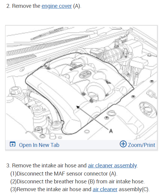

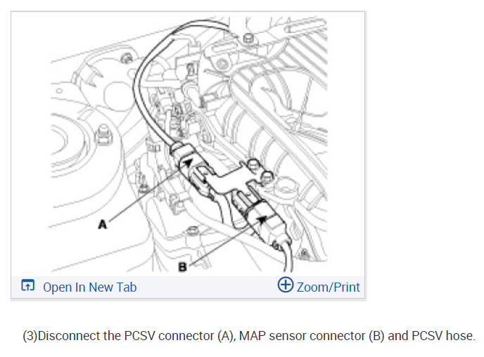

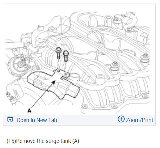

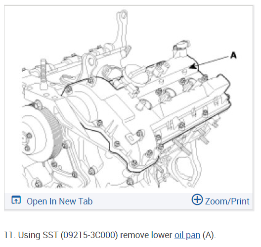

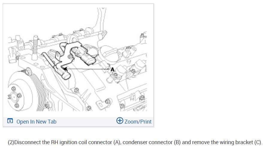

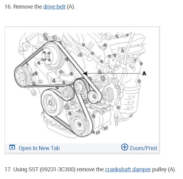

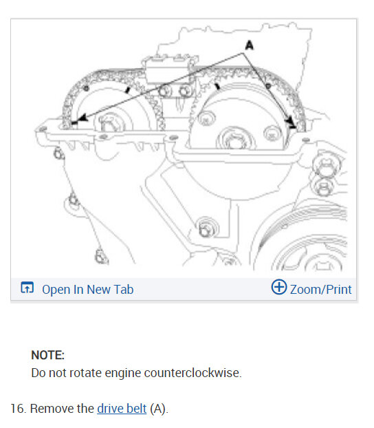

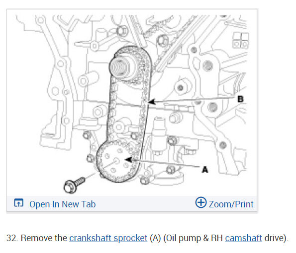

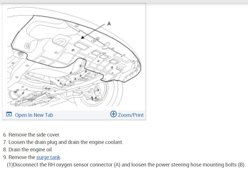

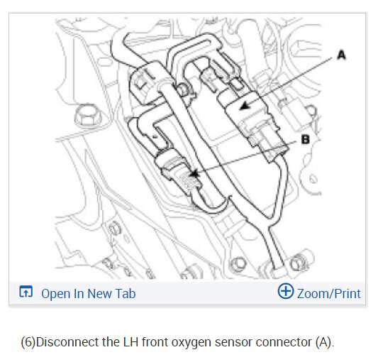

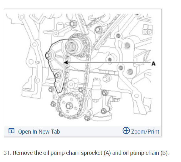

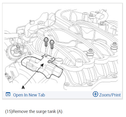

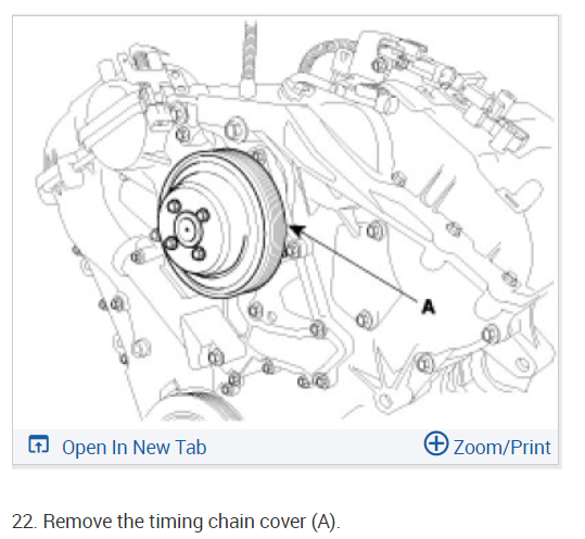

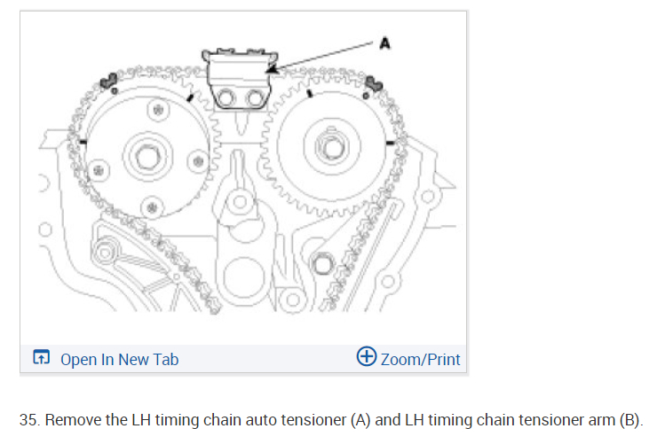

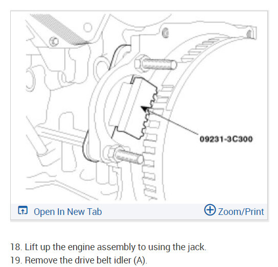

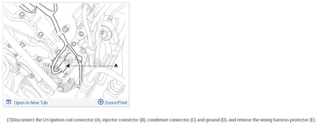

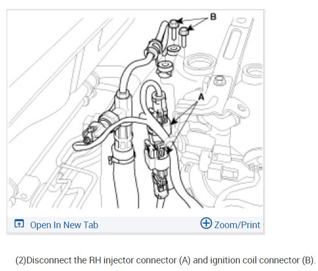

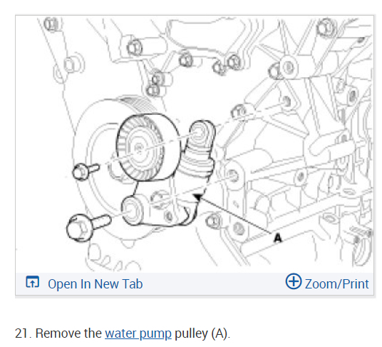

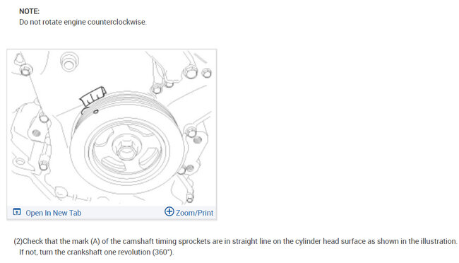

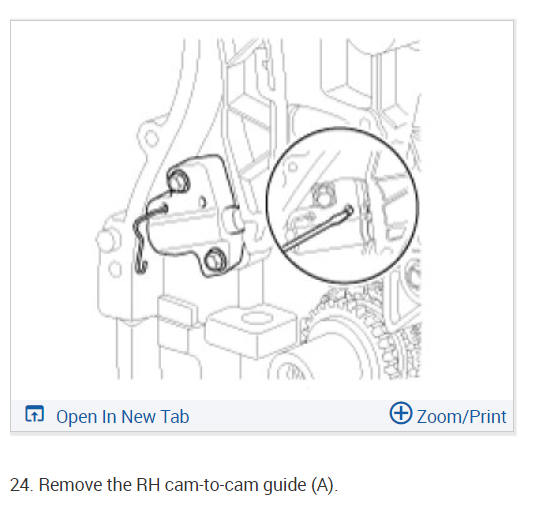

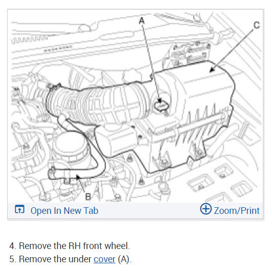

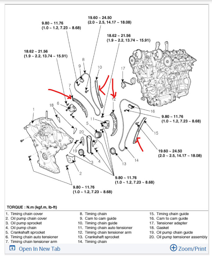

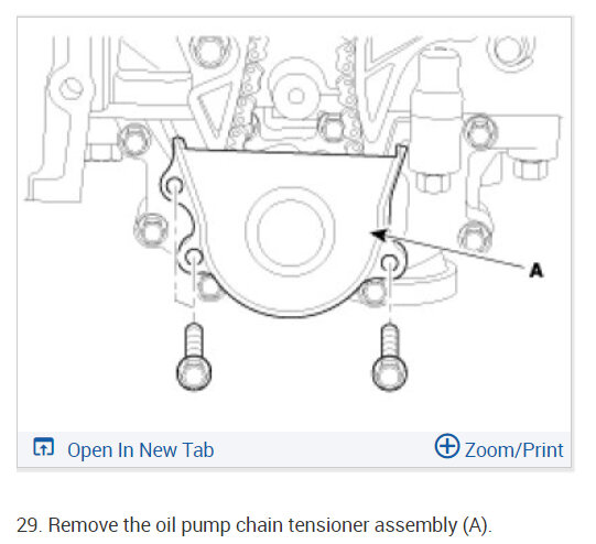

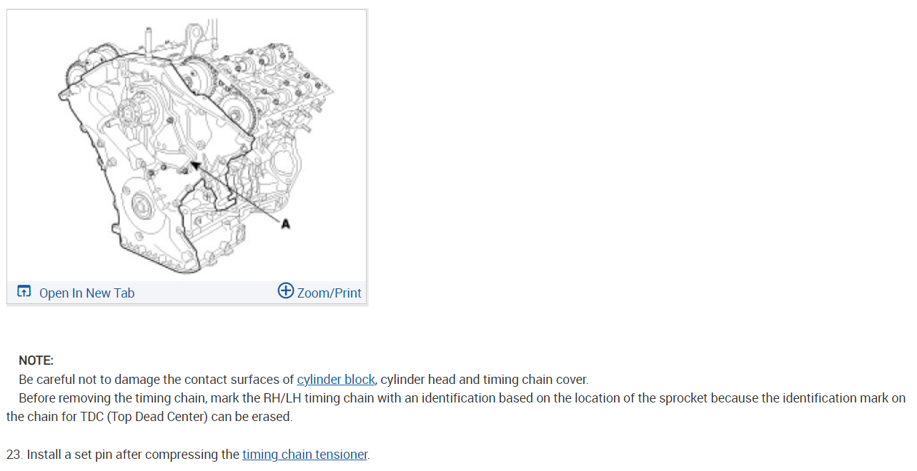

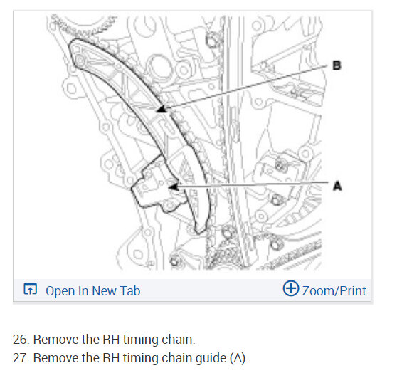

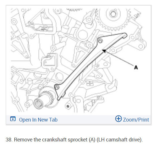

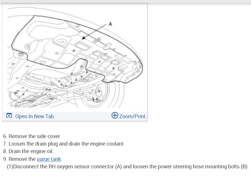

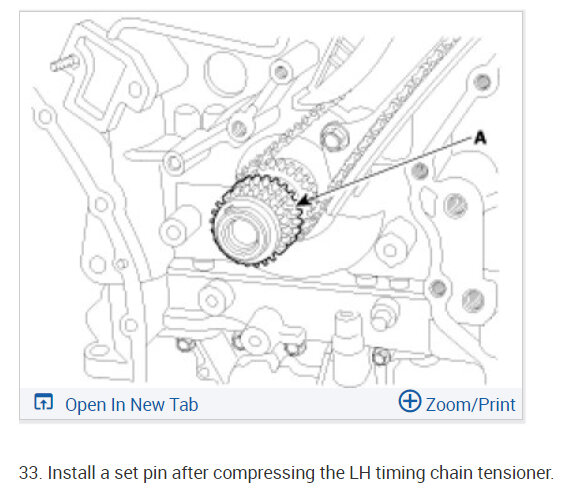

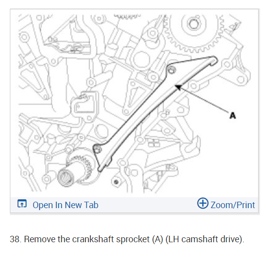

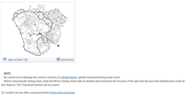

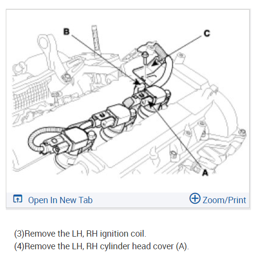

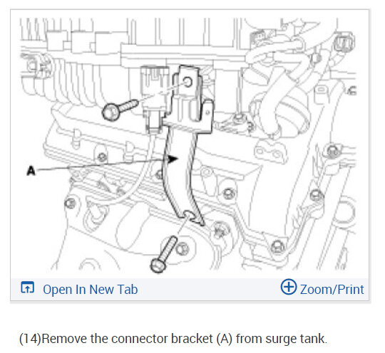

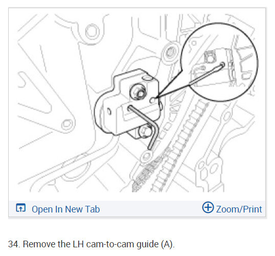

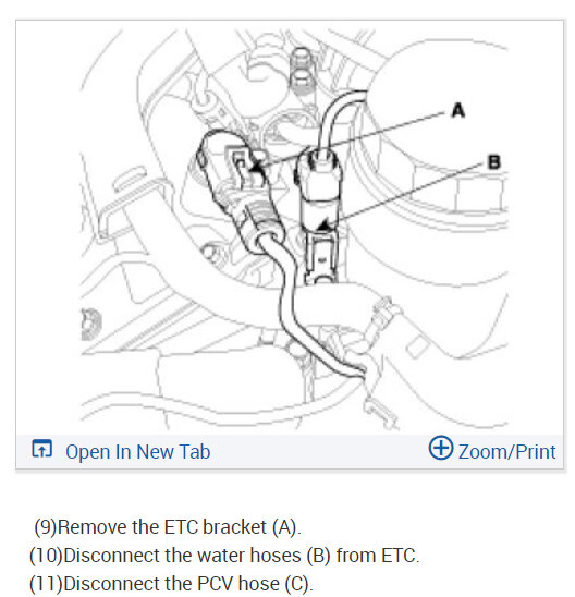

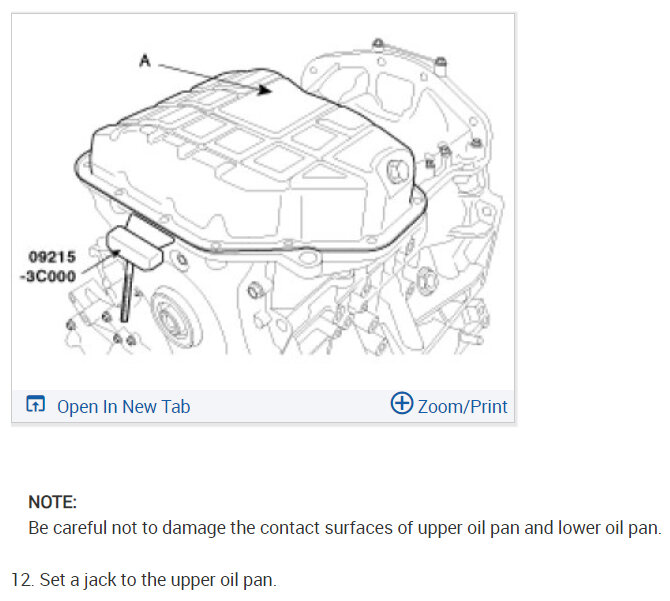

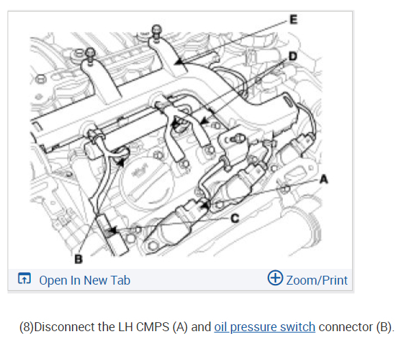

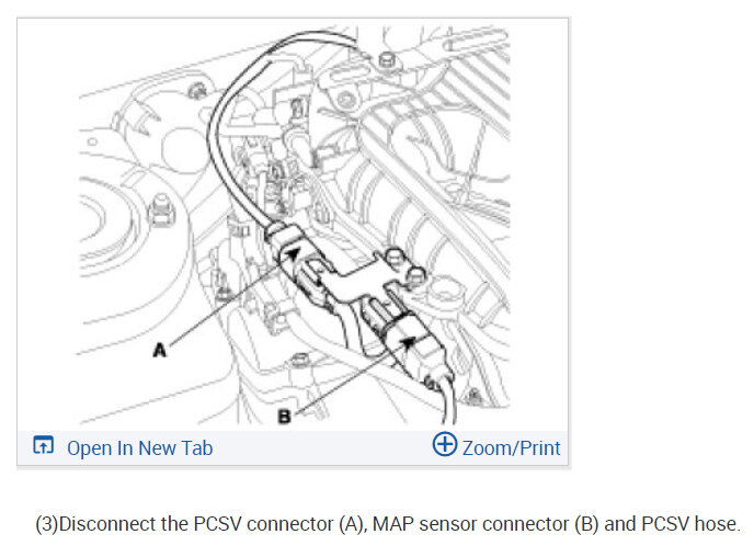

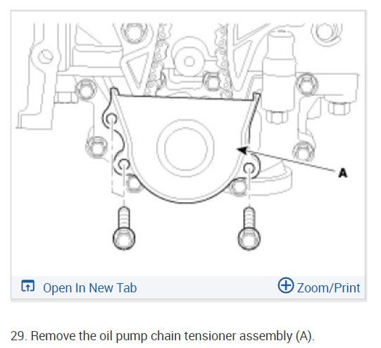

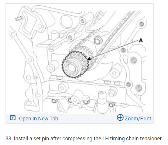

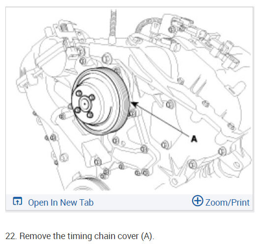

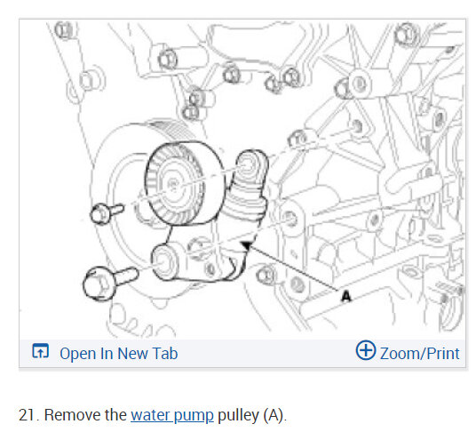

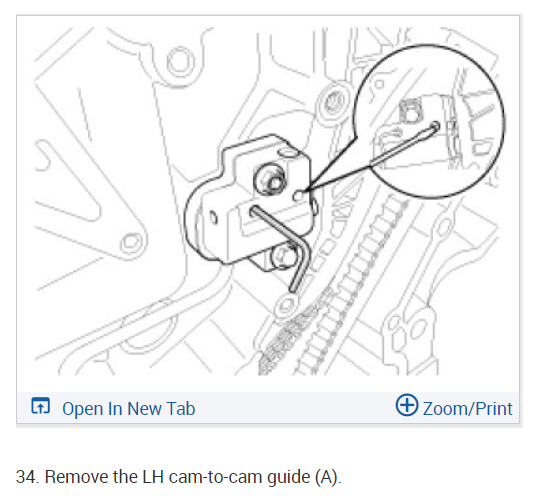

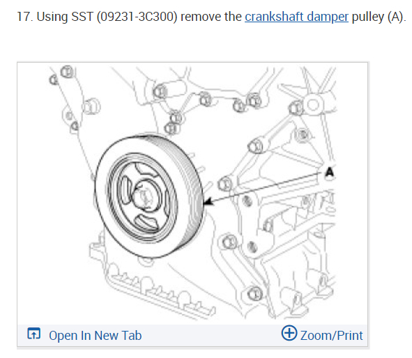

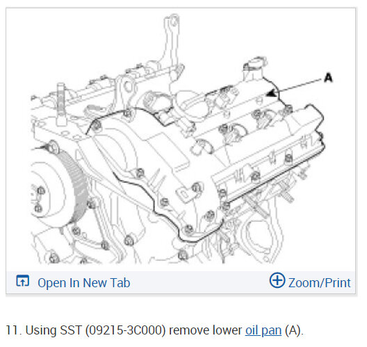

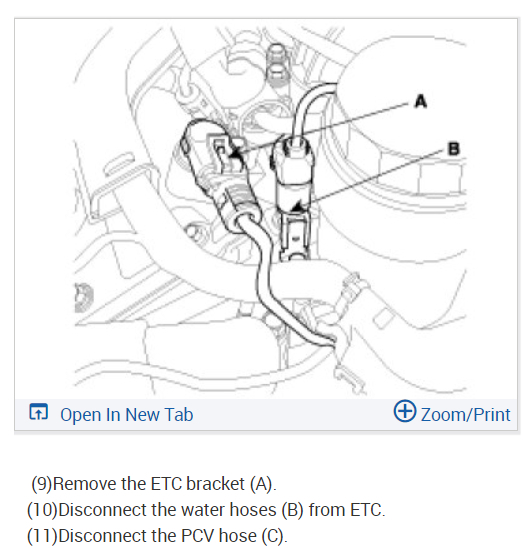

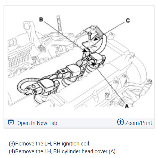

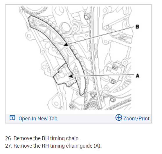

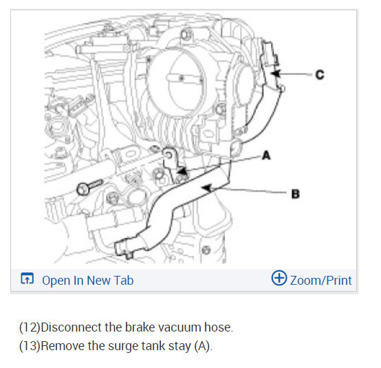

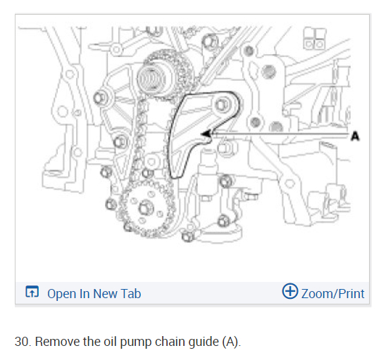

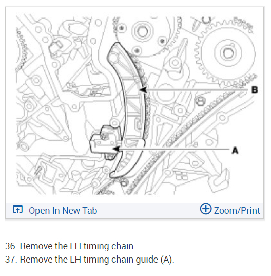

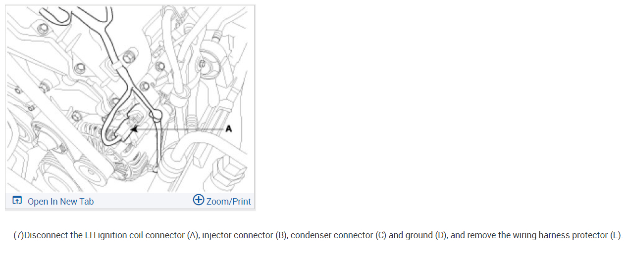

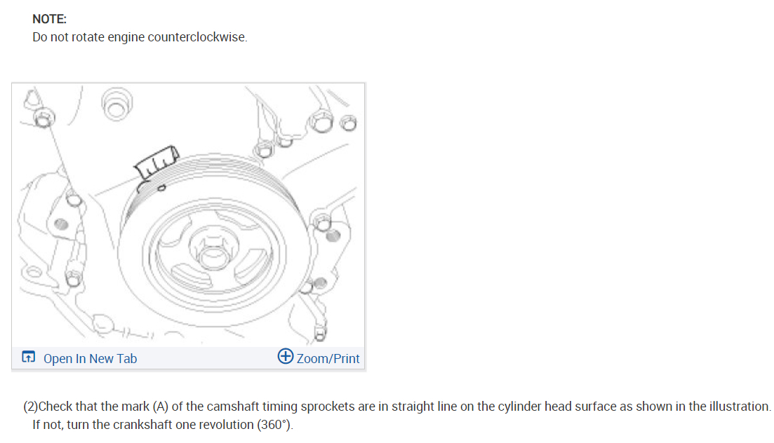

Thanks for the video, it helps. Yes to me it sounds like the timing chain guide has broken and you are hearing the chain contact the case. We can remove the timing chain cover to confirm the issue, here is how. Check out the images (below). Please let us know what happens.
