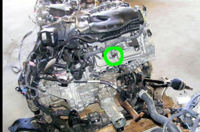

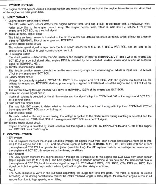

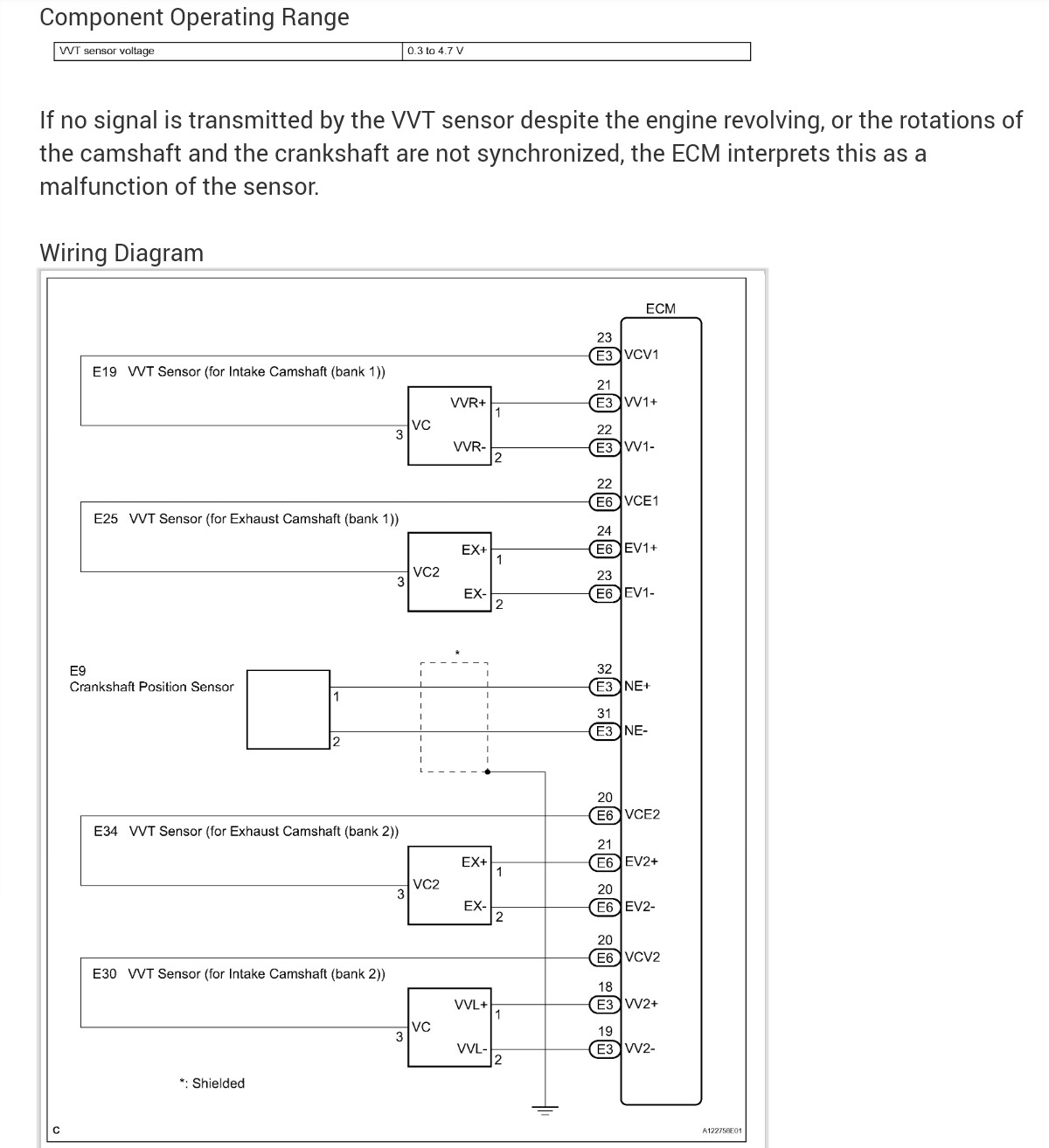

Yes, actually this car has 4 cam/VVT sensors. The ECM reads cam timing off of the VVT sensors, so sensor B I'm assuming is going to be on bank 2. Can you give me the code number that you got from your scantool? You can check all 4 if you want to. But the code may give us some better direction. All the powers, grounds and signals all go back to the ECM. So it could be a bad sensor or one of the wires is losing ground which usually causes a high voltage reading from the sensor.
Here are some extra information about how the cam timing works, there are sensors on both intake and exhaust camshafts.

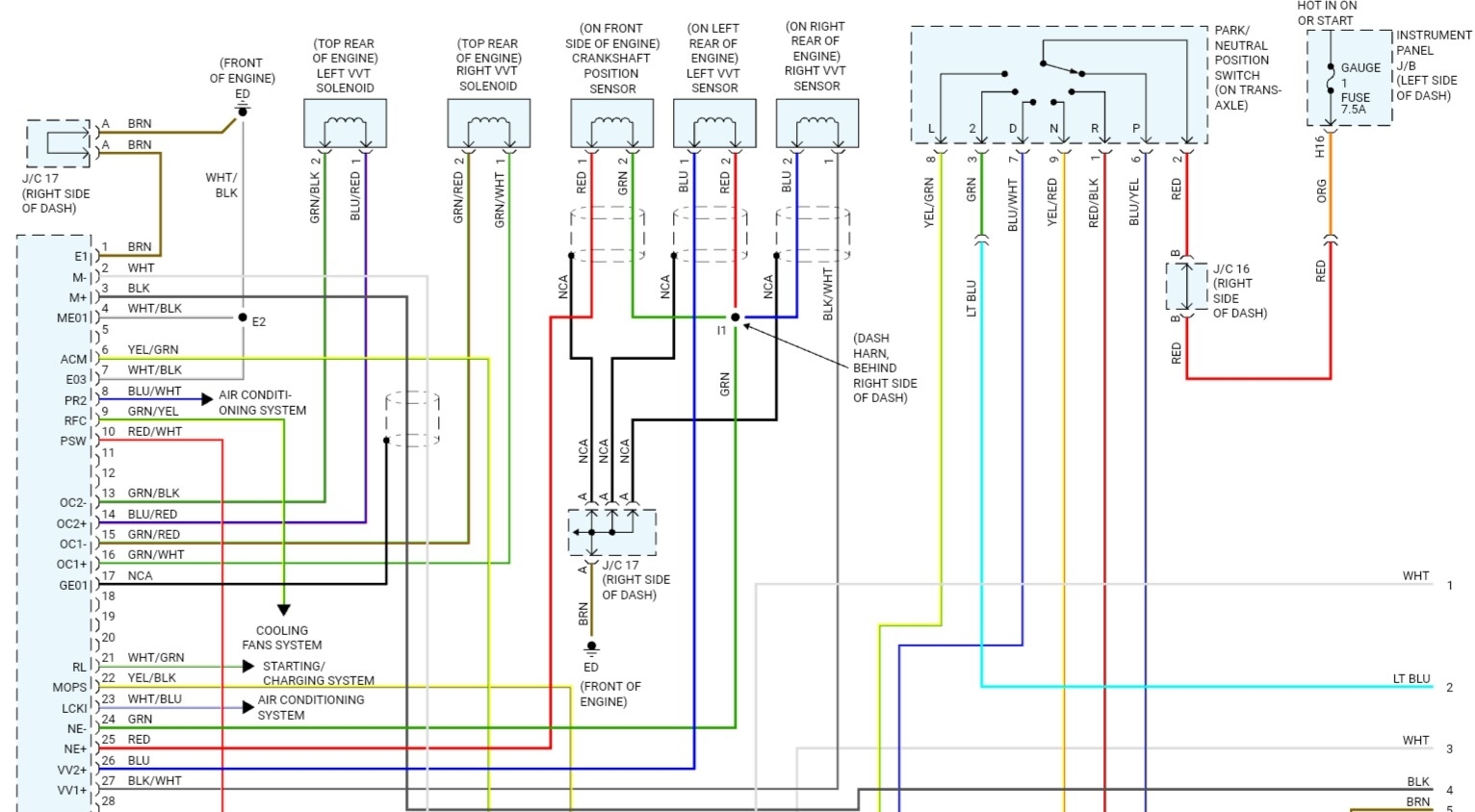

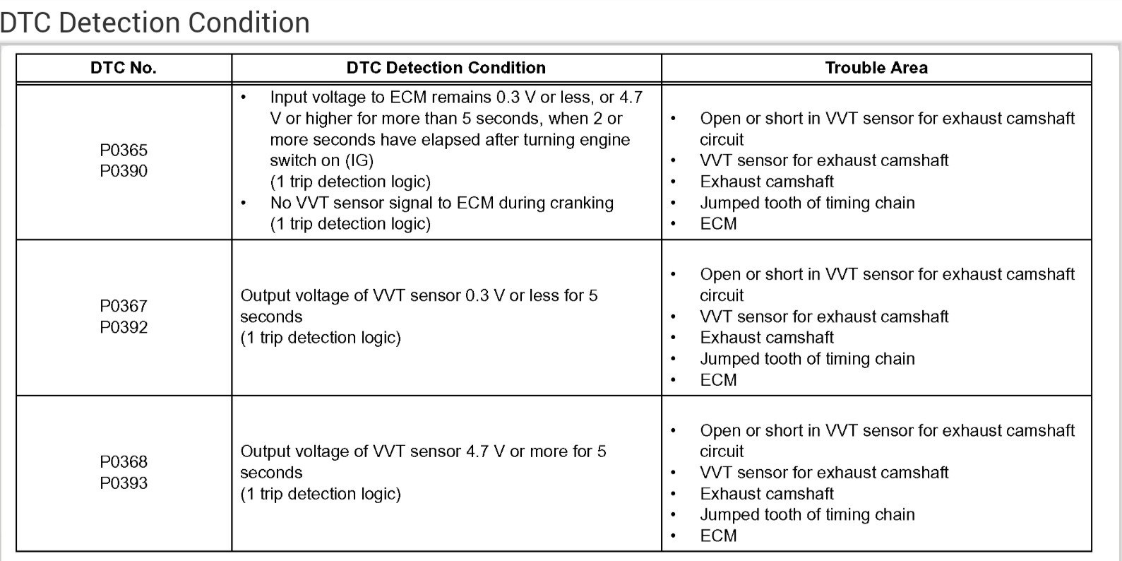

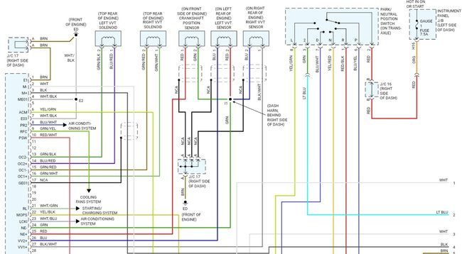

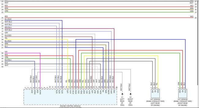

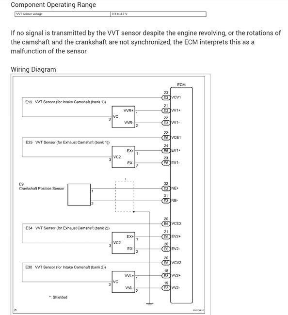

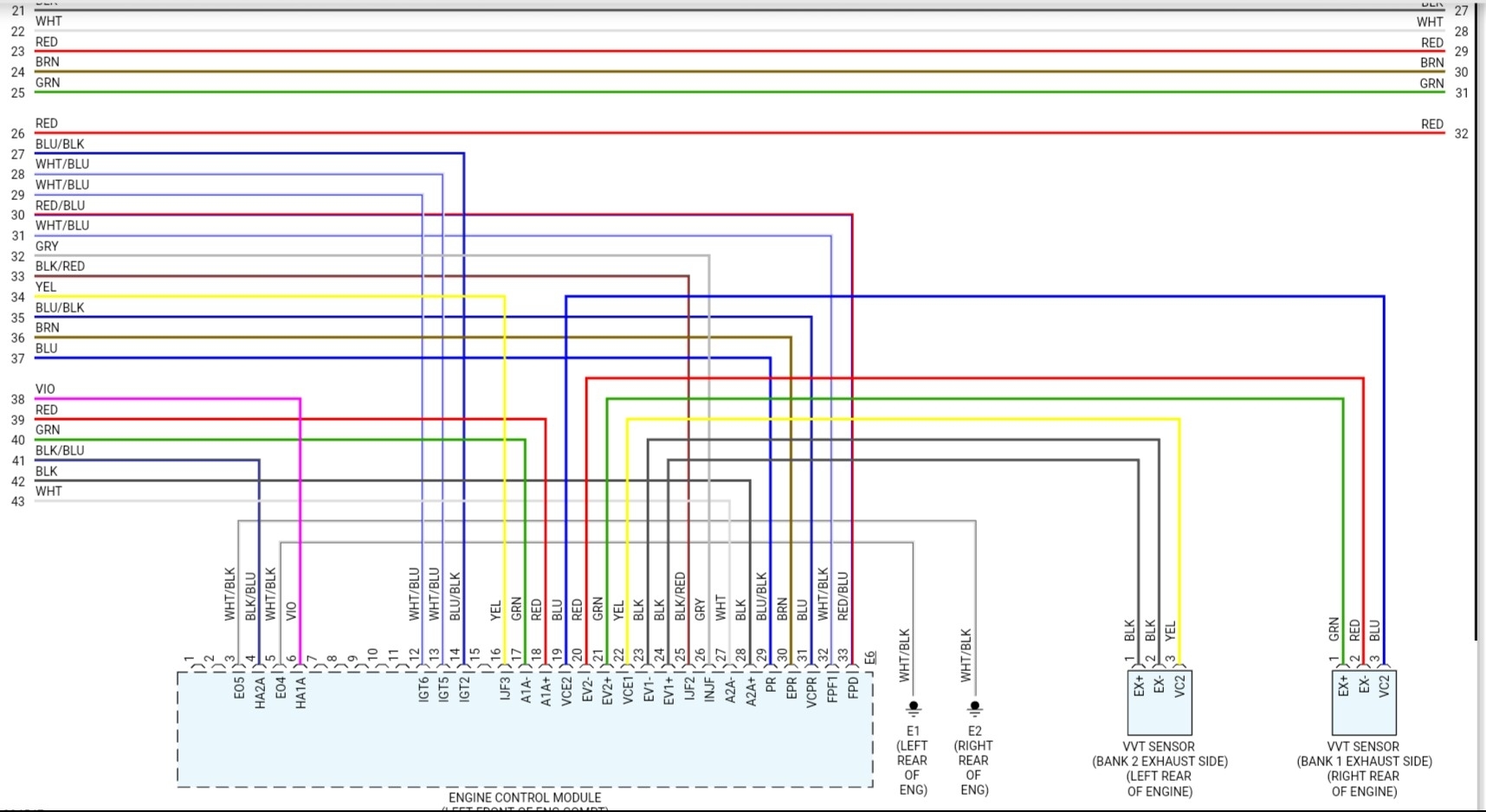

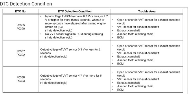

Yes, it definitely could be the problem, the engine computer uses these inputs for injector timing. I did some research last night on this code, it applies to the bank 1 exhaust cam sensor. It could be that the exhaust camshaft timing is off, since the timing chains or belt have to come off to replace the cylinder head, the timing chain could be off on the exhaust camshaft. This will throw everything else off. If this started happening right after the head was replaced, then something was installed wrong. The cam phasers need to be timed exactly right on. Here's the detecting conditions for that code. You may want to bring it back to the place that did the work and have them fix it. Special tools are required to hold the camshafts in place while setting the timing. I'm adding a picture of the wiring diagram for the cam and crank sensors.

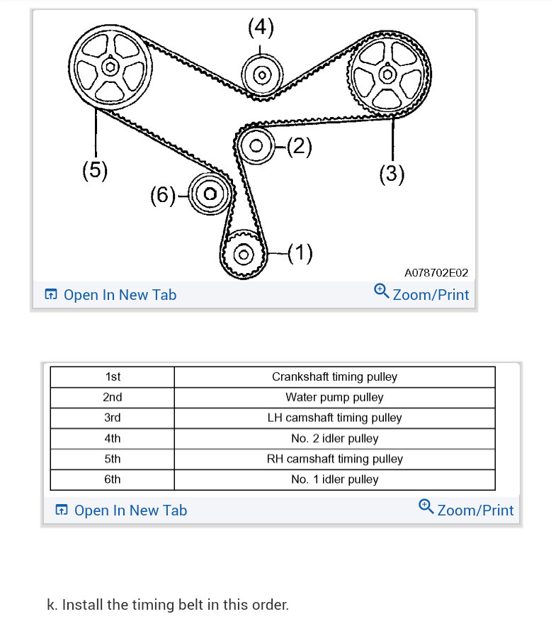

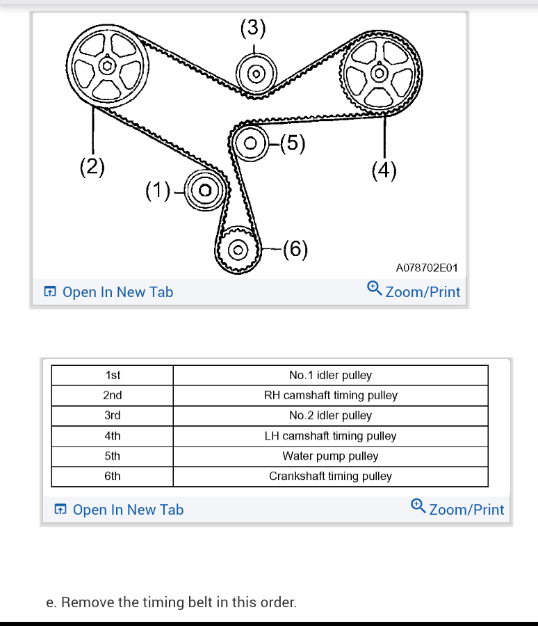

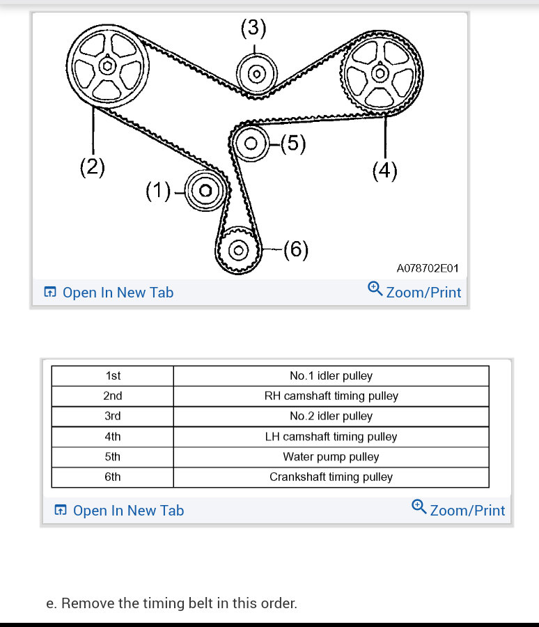

Please could you help me with the belt diagram showing the all the pulleys?
Dec 19, 2020 at 7:19 PM
AL514
  • 5,464 POSTS

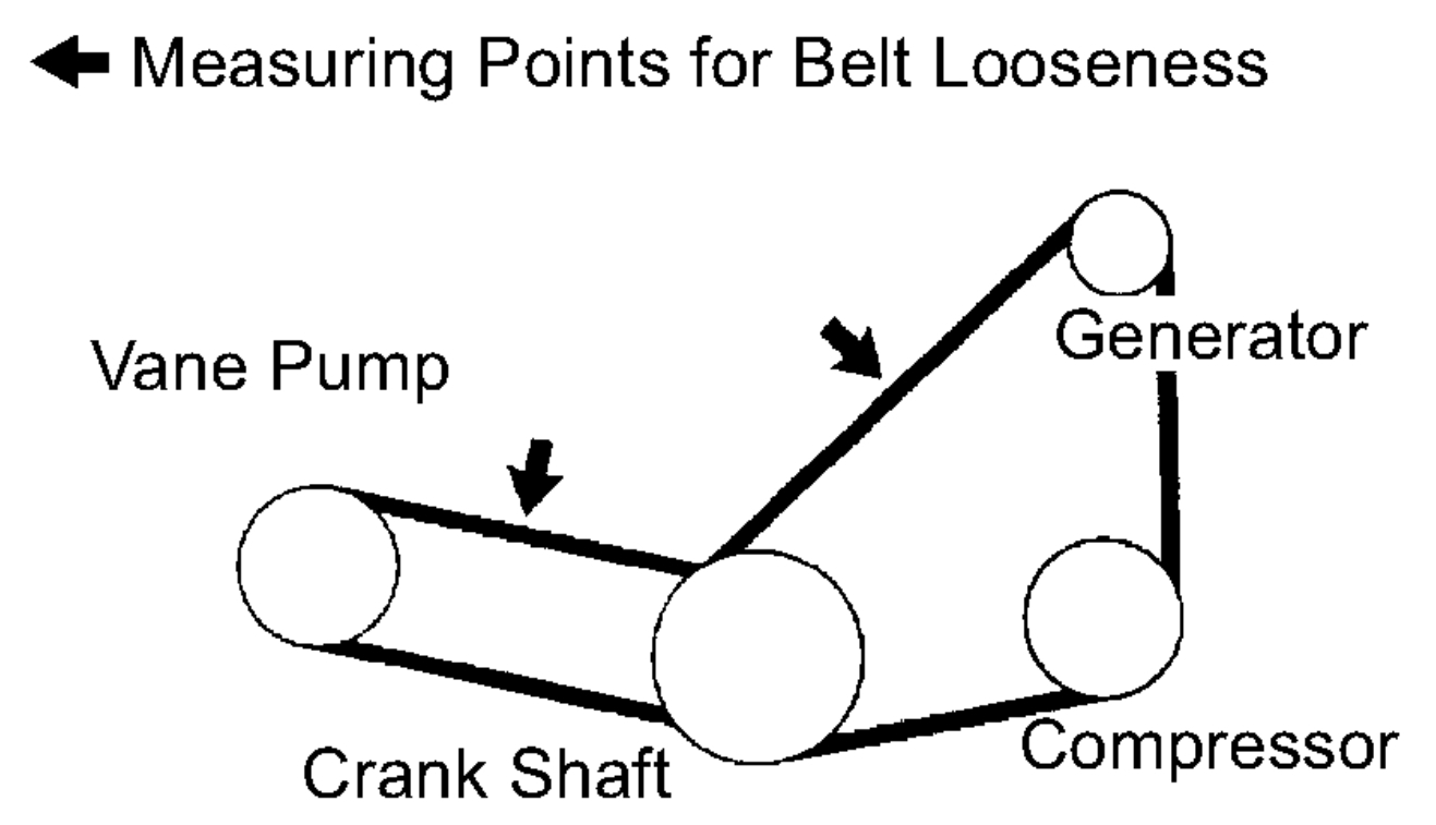

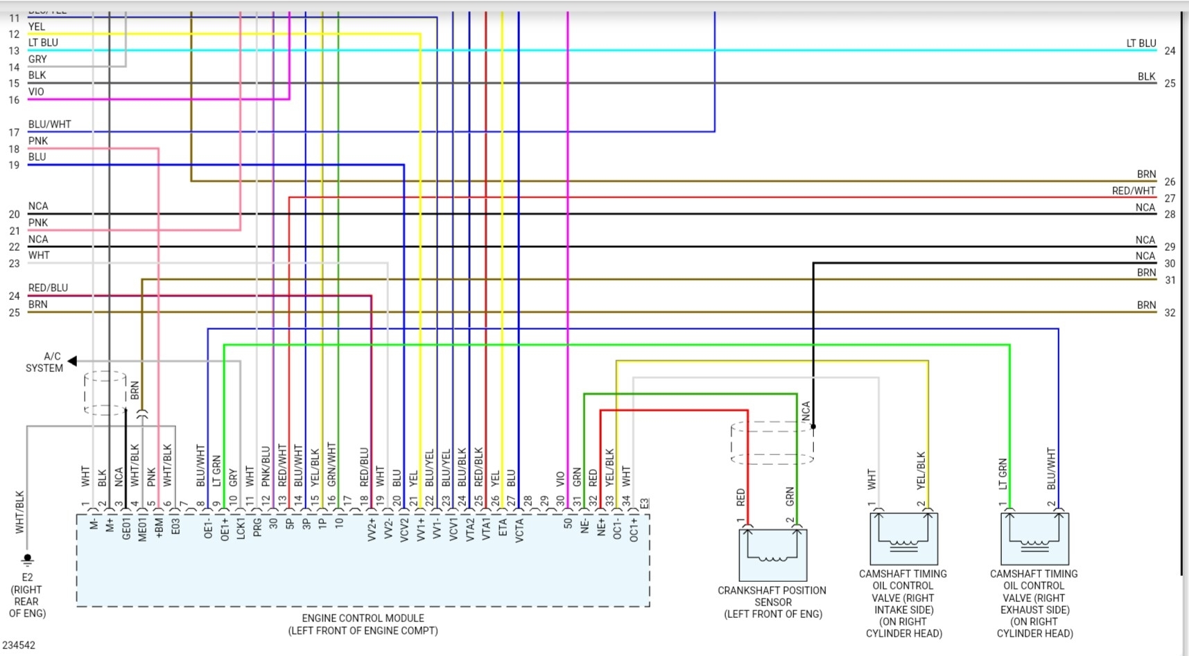

Is there something else going on with it? Did you want the timing belt? Just in case you wanted these. I did some research last night and what's happening is the system is going into fail safe mode and shutting the engine off is one of it's options.

Thank you for the diagram, I need it to explain something. The vehicle's serpentine belt was removed and the engine was started, it didn't trip off any longer, it works fine. I Checked the pulleys, it was observed that one of the idler pulleys had bad bearing, replacing the idler pulley solve the problem. It till amazed me anyway.
