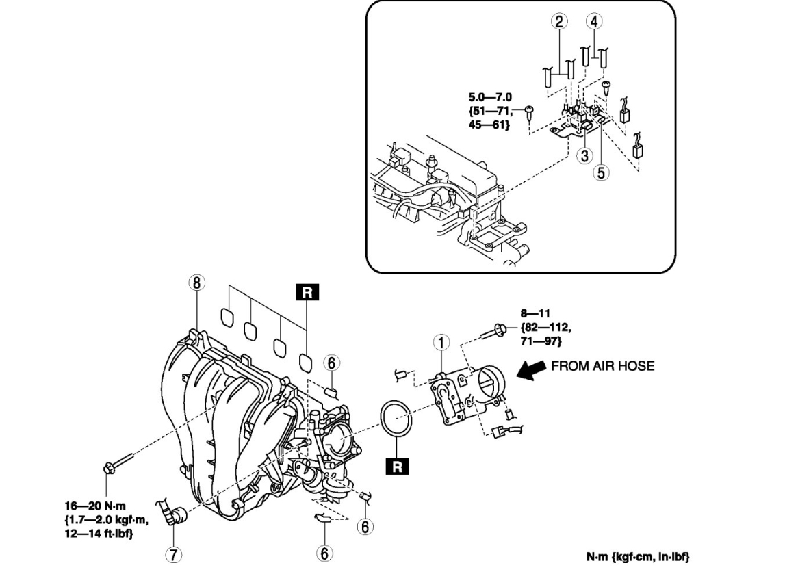

It sounds like the throttle bore is dirty. Here is a guide to help you fix the problem. Leave the actuator plugged in so it doesn't disturb the computer. The diagrams for your car are below.
