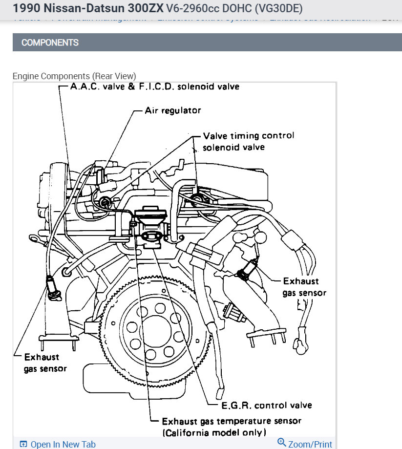

Is sounds like the EGR valve can be getting stuck open, I would remove the valve and test it, here is a video to show you how and the EGR location in the images below:
https://youtu.be/DqUCbbKdWf4
this guide may help as well:
https://www.2carpros.com/articles/stall-at-idle
