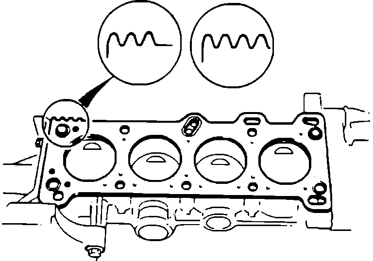

Fig. 2 Positioning Head Gasket
pic 1
b. When installing head gasket, ensure serrated edges of gasket are positioned as shown.

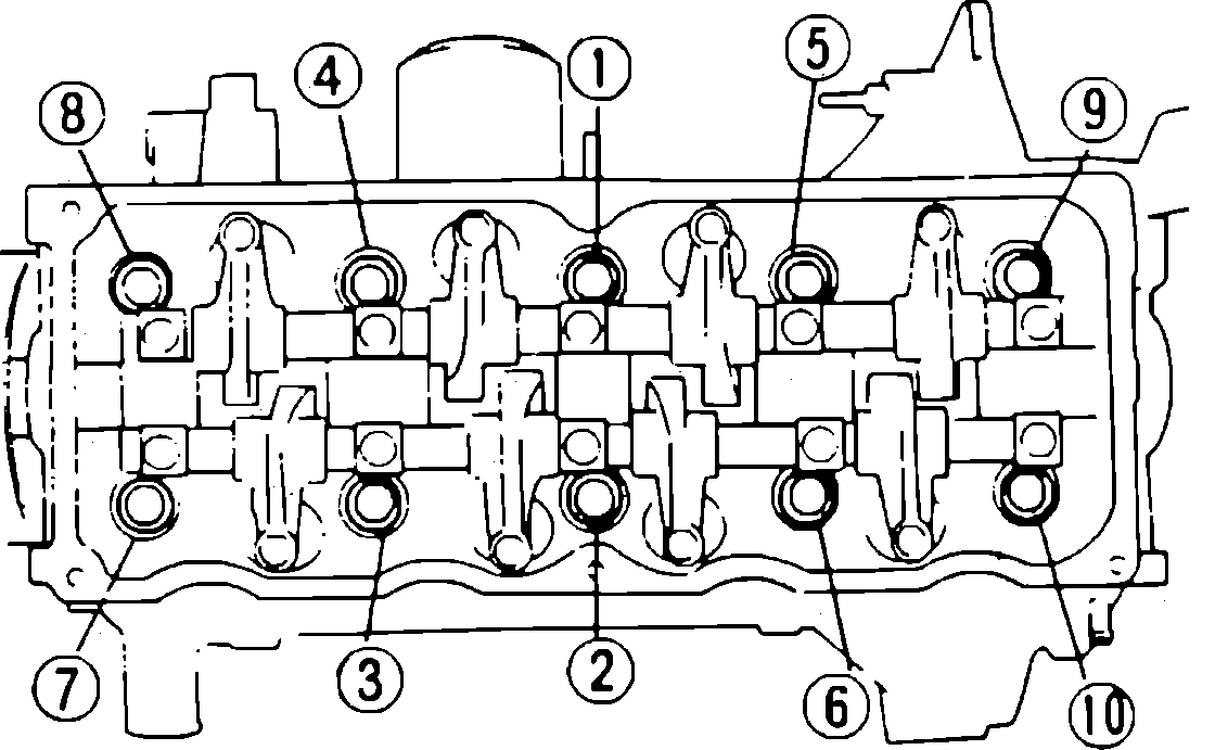

Fig. 3 Cylinder Head Bolt Tightening Sequence
pic 2
c. Tighten head bolts to 50-60 Nm (35-40 lb ft) in the sequence shown. Tighten again in the same sequence to 75-81 Nm (55-60 lb ft).

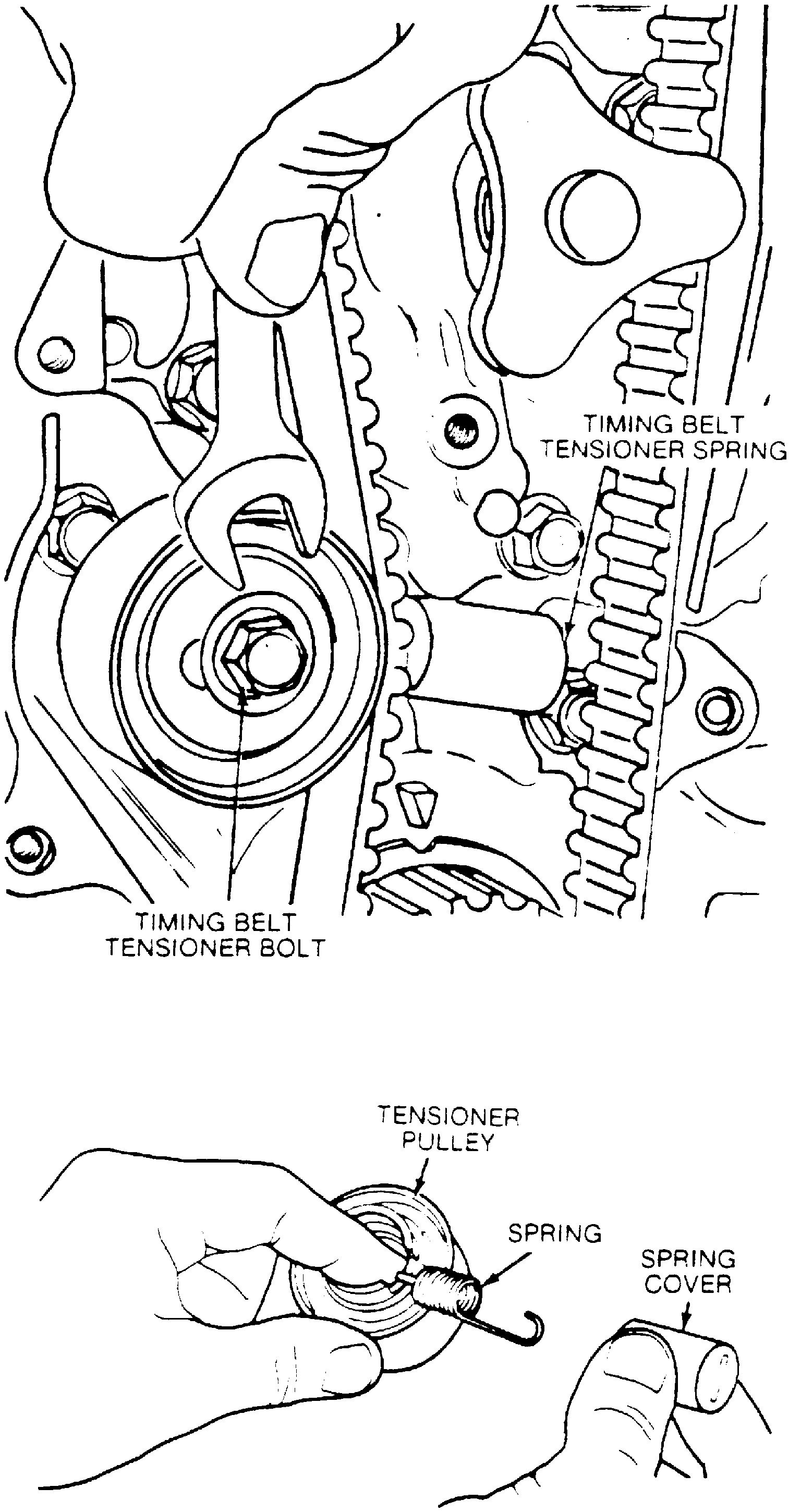

Fig. 11 Timing Belt Tensioner Assembly
pic 3
2. Remove timing belt tensioner pulley attaching bolt, then the tensioner pulley, spring and spring cover.

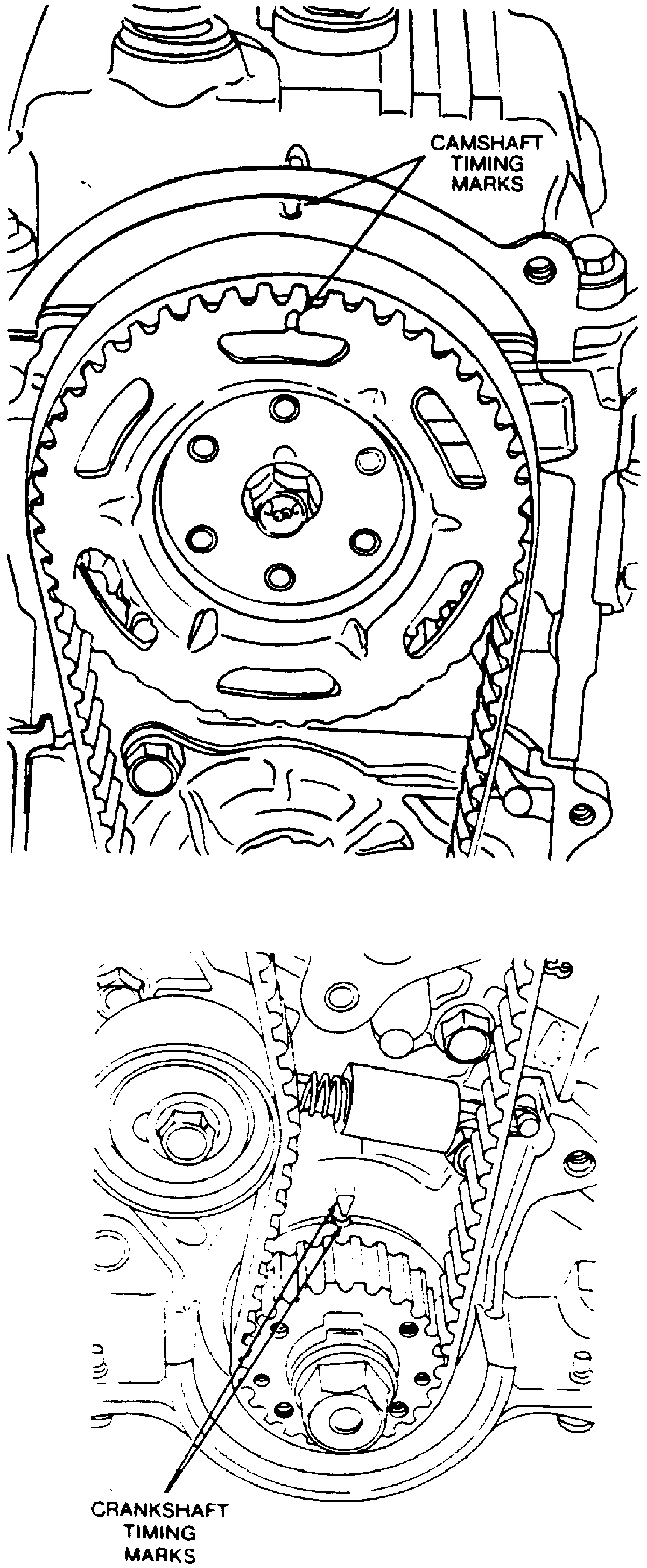

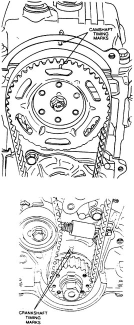

Fig. 12 Valve Timing Mark Alignment
pic 4
6. Align camshaft and crankshaft sprocket timing marks with marks on cylinder head and oil pump housing.
7. Install timing belt. If reusing old belt, ensure belt is installed so that direction of rotation mark made during removal is positioned correctly.
8. Install spring and spring cover onto tensioner pulley, then install pulley and attaching bolt. Do not tighten bolt at this time.
9. Install tensioner spring onto anchor tightening pulley attaching bolt to 19-26 Nm (14-19 lb ft).

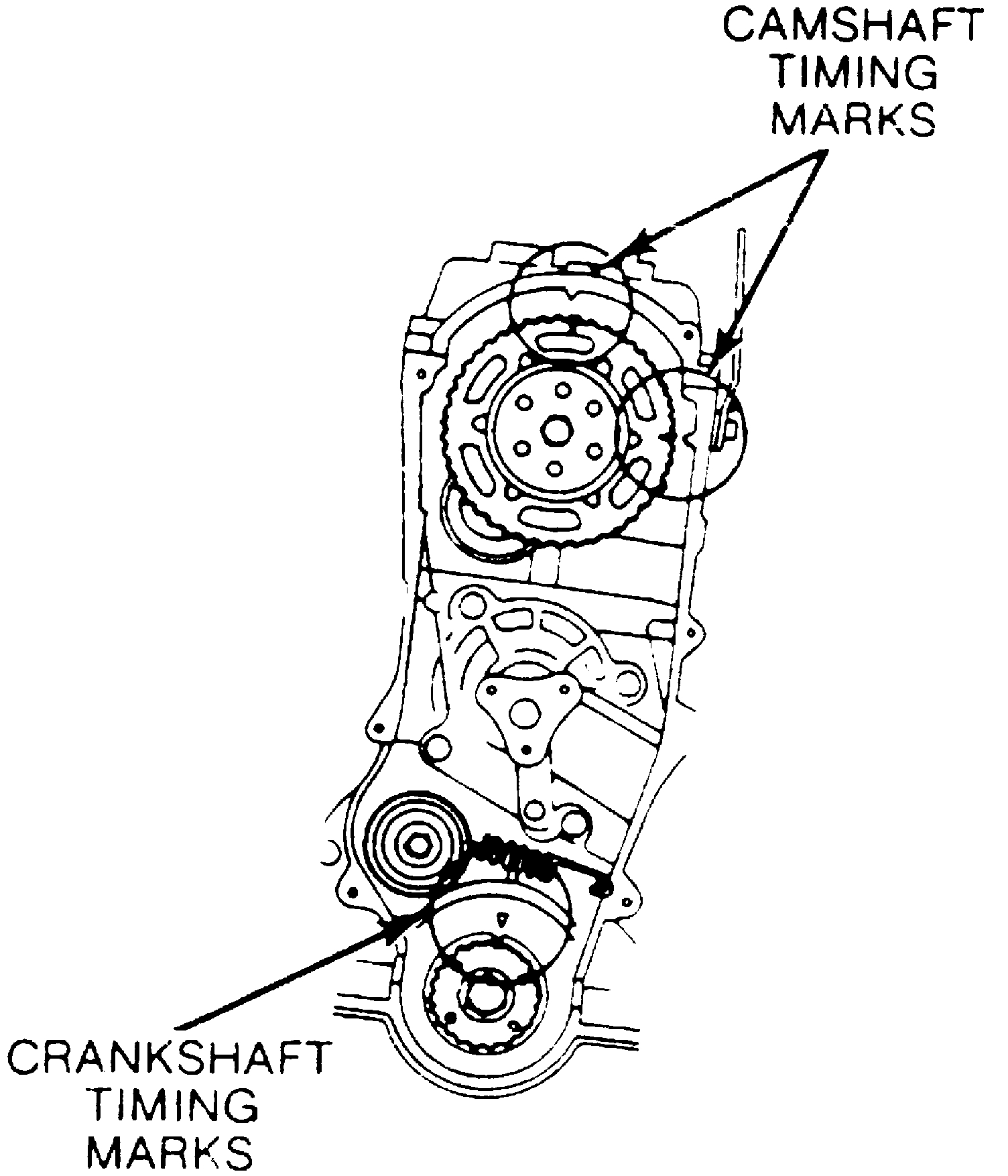

10. Time camshaft and crankshaft as follows:
a. Align crankshaft pulley timing notch with TC mark on timing belt cover tab.
b. Remove upper timing cover.
Fig. 13 Camshaft & Crankshaft Valve Timing Marks
pic 5
c. Camshaft timing marks should be aligned. If camshaft timing cannot be viewed, rotate crankshaft pulley one revolution, aligning notch with timing cover TC mark.
d. If camshaft timing marks are aligned, the camshaft is properly timed to the crankshaft.
