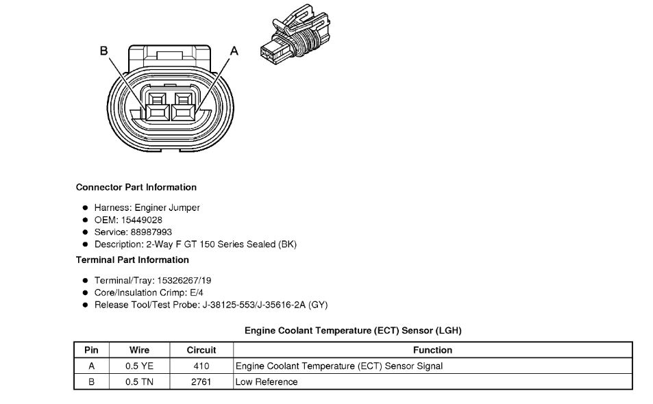

Do you have a scan tool that can read live data? See if it reads engine temperature.
https://www.2carpros.com/articles/how-a-coolant-temperature-sensor-works
The coolant sensor is what sends a signal to the ECM for engine temperature and then off to the cluster.

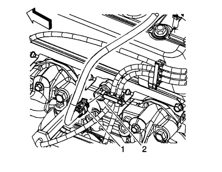

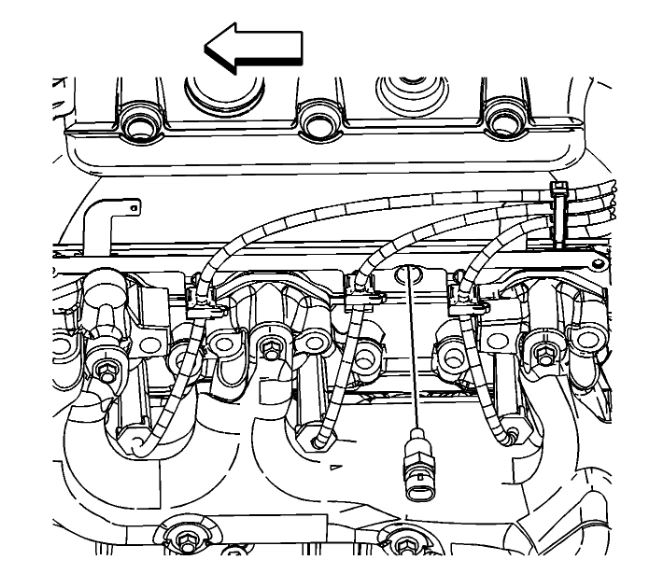

https://www.2carpros.com/articles/coolant-temperature-sensor-cts-replacement

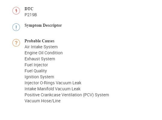

I checked it with a scanner. After driving the car 5 or 6 miles and letting idle for 10 minutes. Temperature was 76°c to 78°c, on scanner. Also there is two stored codes P219B and P0128.
May 5, 2020 at 9:09 AM
Okay, the 128 is a stuck open thermostat and must be replaced.
The 219 is a fuel trim code. This has nothing to do with the temperature issue.
I attached the possibilities for you and the flow chart below.
DTC P219A or P219B
Diagnostic Instructions
