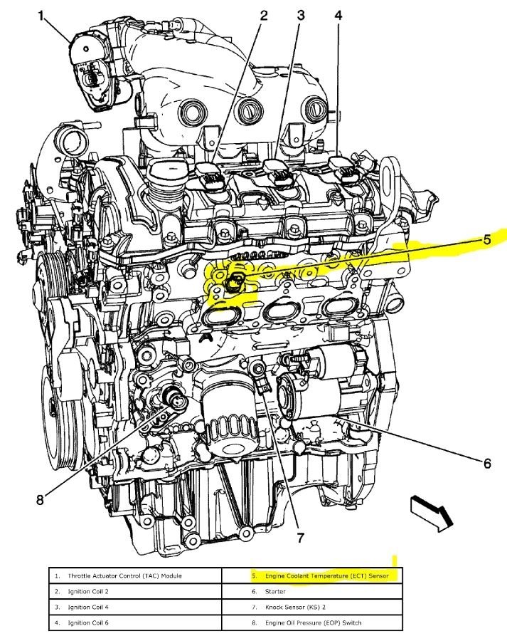

Okay, you got this message right after you changed the spark plugs? If yes go back to the wiring around the plugs and see if you knocked a sensor wire off by accident. You can get this message if the engine coolant sensor harness is unplugged or damaged. The computer defaults to thinking the engine is hot and starts limiting things in order to cool it off. The sensor is just above the exhaust manifold on the front of the engine.

I also changed that cooling sensor too and checked all wires that I touch only and starts fine just that the fans stay on AC off and the display on dash.
