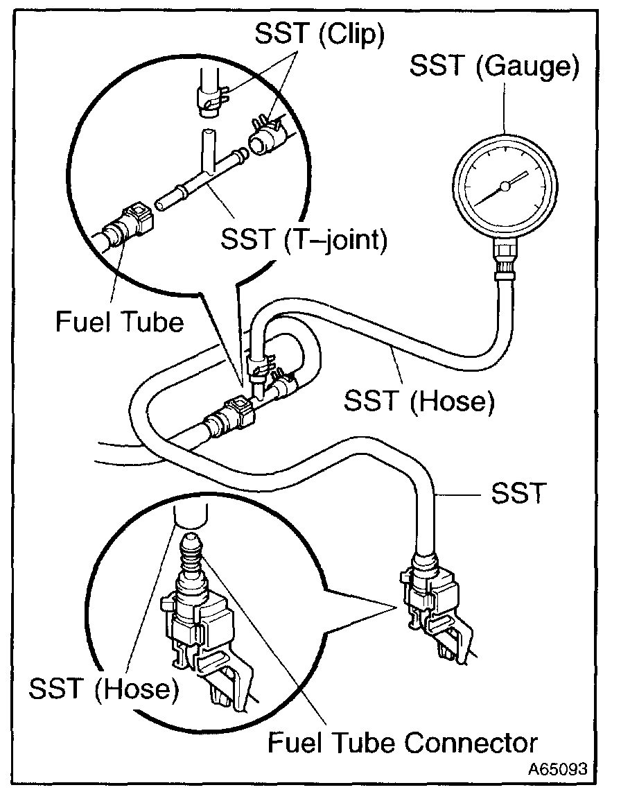

Now, if there are no vacuum leaks or trouble codes, since the engine bogs under a load, my next guess is that it deals with a weak fuel pump. With that in mind, I would recommend checking fuel pressure. Here is a link that shows how in general it is done:
Here are the directions specific to your vehicle. They include the manufacturer's specs.
See Picture 1
CHECK FUEL PRESSURE
a. Prepare for inspection.
1. Purchase a new fuel tube, and take out the fuel tube connector from its tube.
HINT: Part No. 23901-OD010
b. Work for prevent gasoline from spilling out.
c. Disconnect the EFI fuel pipe clamp.
d. Disconnect the fuel tube from the fuel main tube.
See Picture 2
e. Install SST (pressure gauge) as shown in the illustration by using the SST and fuel tube connector.
SST 09268-41047 (90467-13001, 95336-08070), 09268-45014 (09268-41200, 09268-41220, 09268-41250, 90467-13001)
f. Wipe off any splattered gasoline.
g. Start the engine.
h. Measure the fuel pressure at idle.
Fuel pressure: .................... 304 - 343 kPa (3.1 - 3.5 kgf.sq.cm, 44 - 50 psi)
i. Stop the engine.
j. Check that the fuel pressure remains as specified for 5 minutes after the engine has stopped.
Fuel pressure: .................... 147 kPa (1.5 kgf.sq.cm, 21 psi) or more
If pressure is not as specified, check the fuel pump, pressure regulator and/or injectors.
k. After checking fuel pressure, disconnect the negative (-) terminal cable from the battery and carefully, remove the SST and fuel tube connector to prevent gasoline from the splashing.
l. Reconnect the fuel tube to fuel main tube.
m. Install the EFI fuel pipe clamp.
n. Check fuel leak.
___________________________________

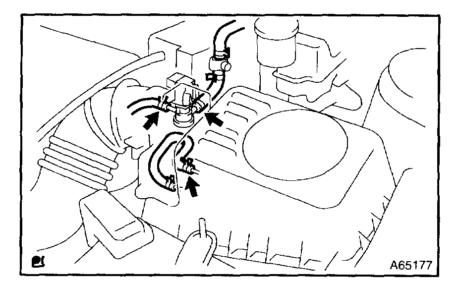

If you take a look at picture 3, make sure none of the vacuum lines indicated are damaged or not properly connected.

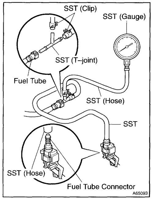

Now for the stiff throttle cable, look at picture 4 and make sure nothing is kinked, out of place and rubbing, or damaged in any way.
