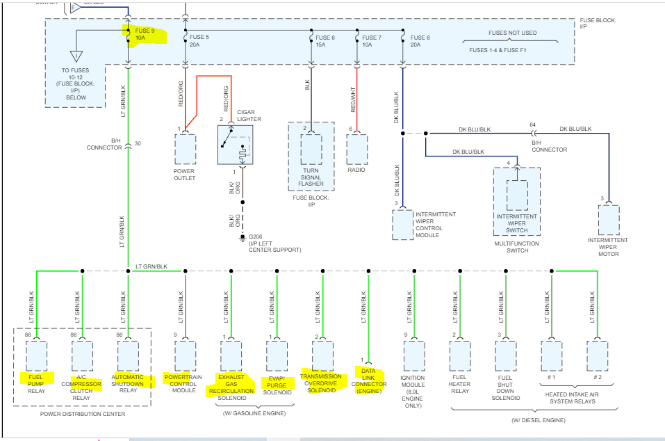

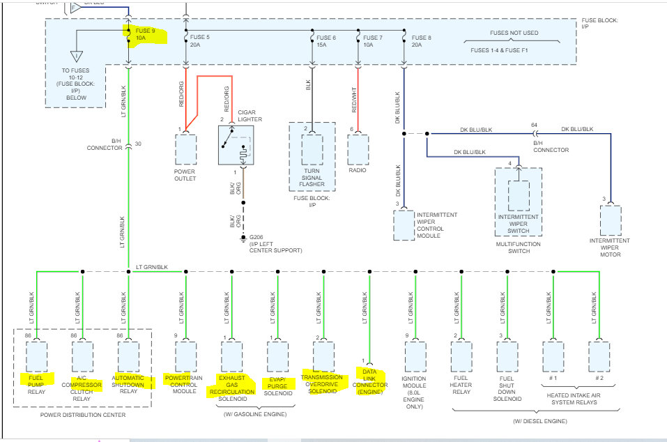

I attached a pic from the wiring schematic below. Fuse 9 powers several relays in addition to the PCM. It could be any of the circuits that have a short.
Here is what I need you to do: Remove one relay at a time and see if the fuse doesn't fail with one of them out. This way, we can narrow down where the issue is coming from.
Let me know what you find.
See pic below.

Okay, then we need to remove one of the relays at a time to see which one is causing it to fail when you try starting it. Fuse 9 powers the relays.
If you look at the schematic above, I highlighted the relays involved.

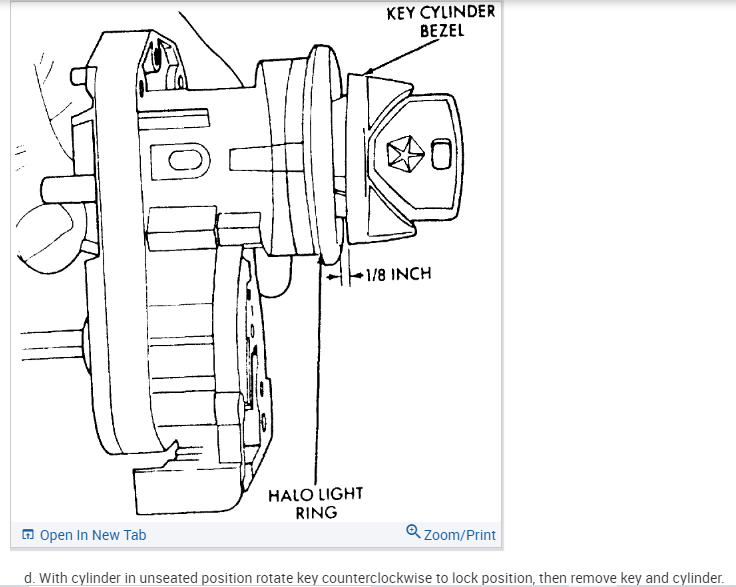

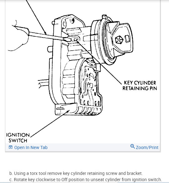

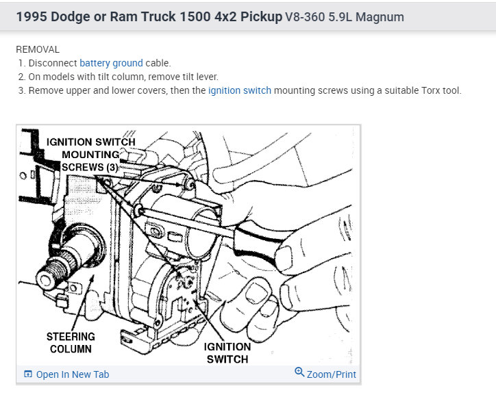

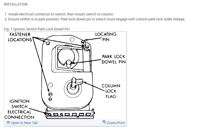

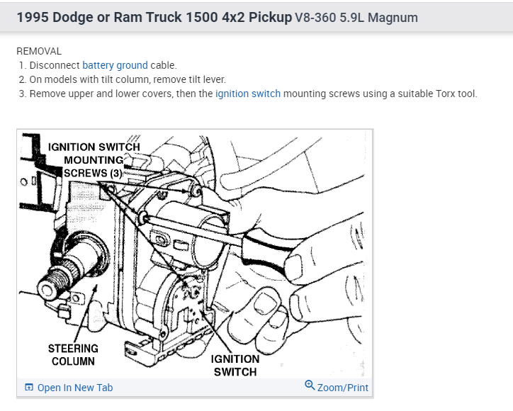

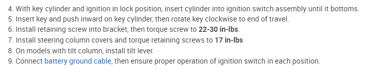

Ignition switch spring is out of shape and might be arcing behind key cylinder.
Aug 3, 2022 at 1:08 AM
That is very possible. I don't know if you need them, but I attached the directions for the removal and replacement of the switch.
Take a look through them and let me know if you have questions.
Take care and let me know how things turn out for you.
See pics below.
Aug 3, 2022 at 7:01 PM

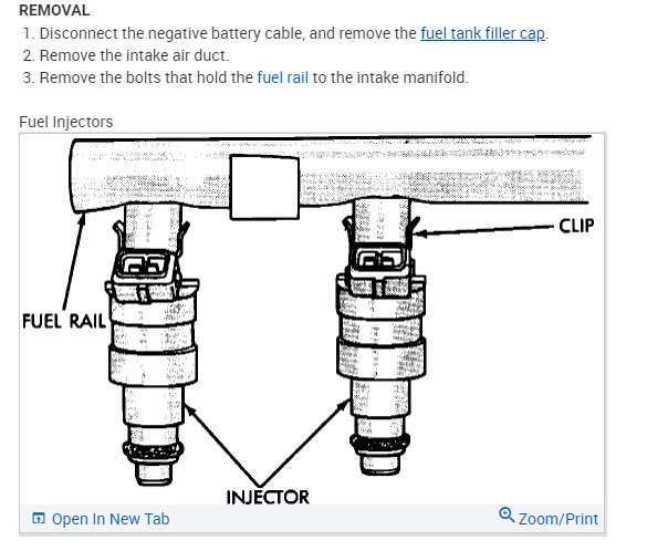

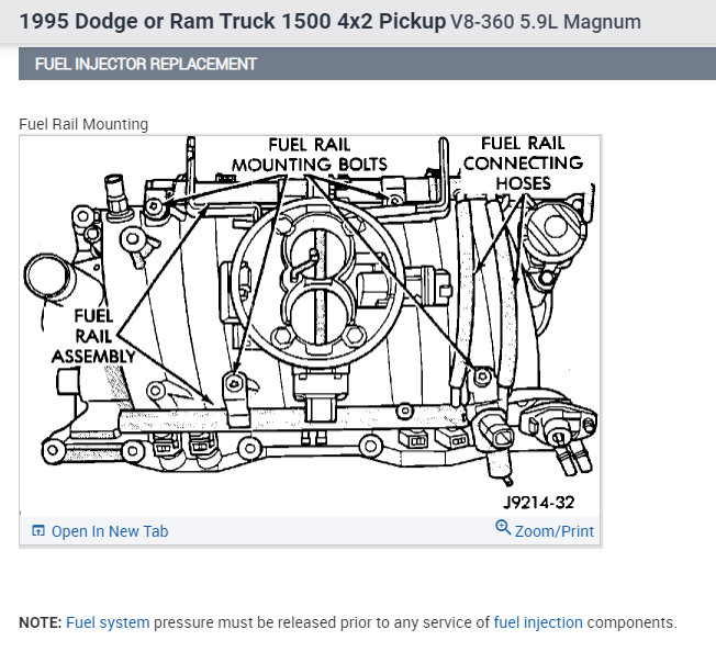

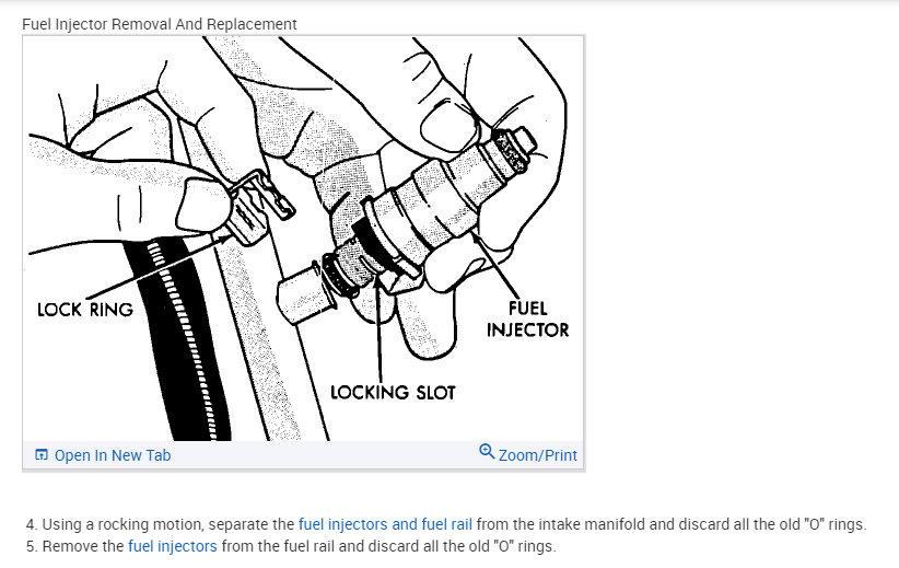

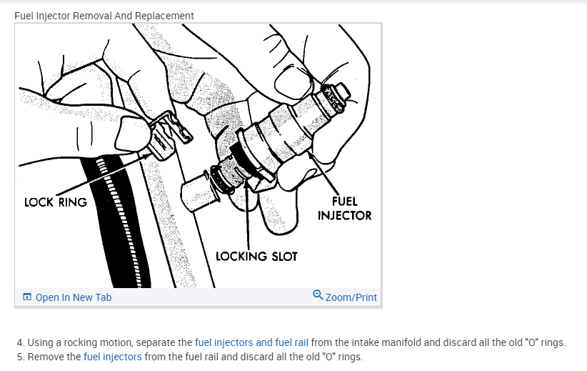

I have no clue on how to disconnect the injectors.
Aug 26, 2022 at 3:57 PM
The fuel rail needs to be removed first. I attached directions below specific to your vehicle. Make sure the battery is disconnected before you start and keep in mind the system is under pressure.
Also, here is a link that I feel is more detailed. However, it isn't specific to your vehicle. Between the two, you should be fine.
https://www.2carpros.com/articles/how-to-replace-a-fuel-injector
See pics below.
