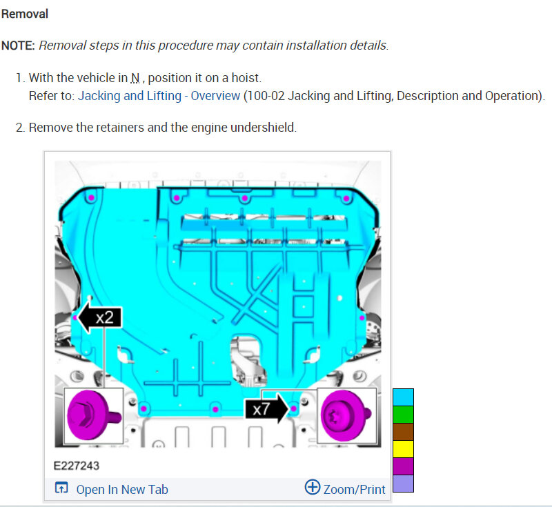

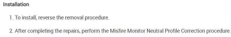

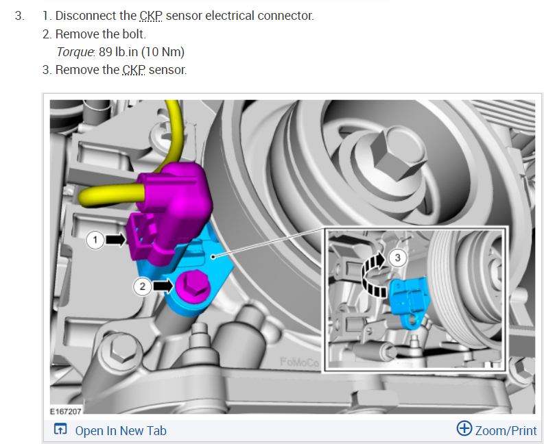

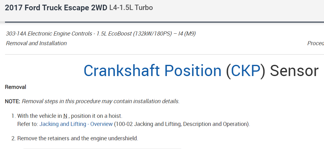

The P1336 code in a 2017 Ford Escape is generally related to the crankshaft position sensor performance. So, it looks like the wiring/connector is damaged or the sensor is no good, here is the location of the sensor so you can see what needs to be done or what to look for to help fix it yourself. Check out the images (below). Please upload pictures or videos in your response of the problem so we can see what's going on.
