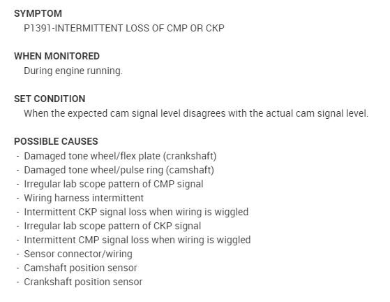

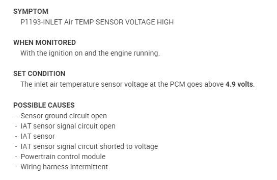

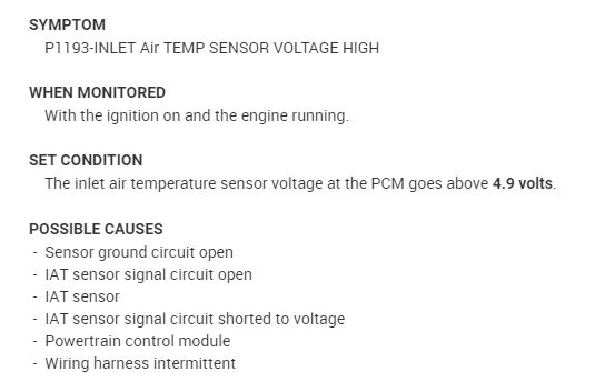

To start with it was codes P1193, P1391 and today it said on my scanner electronic control unit external malfunction.thanks please help me.
Nov 5, 2019 at 6:34 PM
Good morning,
The 2 codes' possibilities are below.
The one is for the intake air temperature sensor. That is on the intake hose from the air filter to the throttle body.

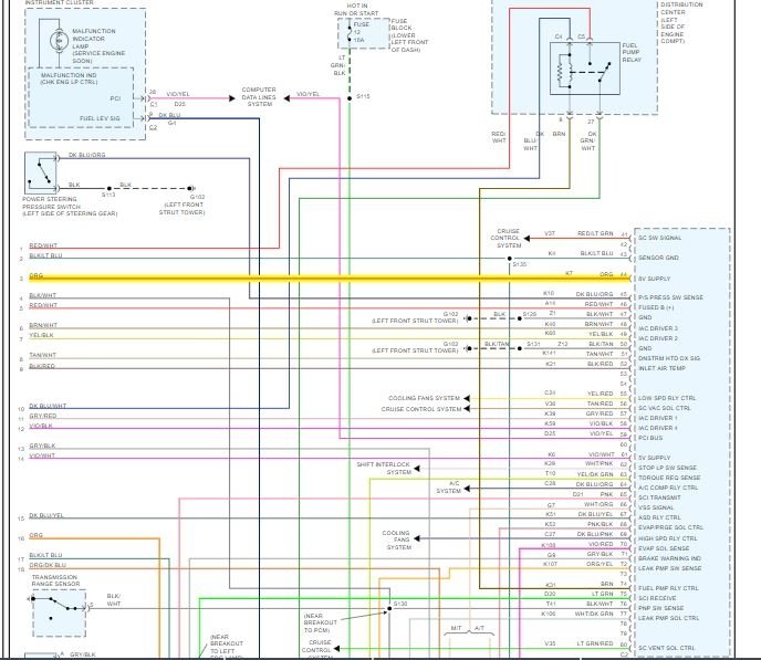

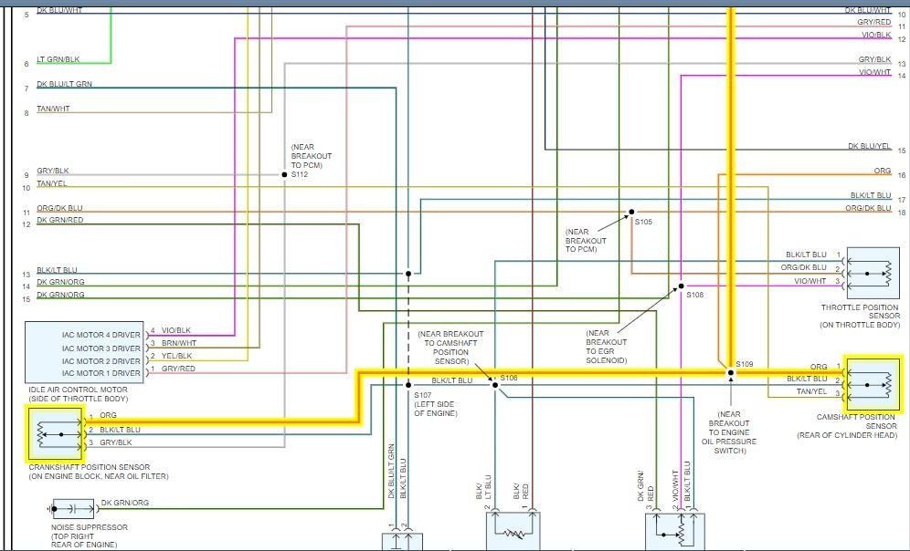

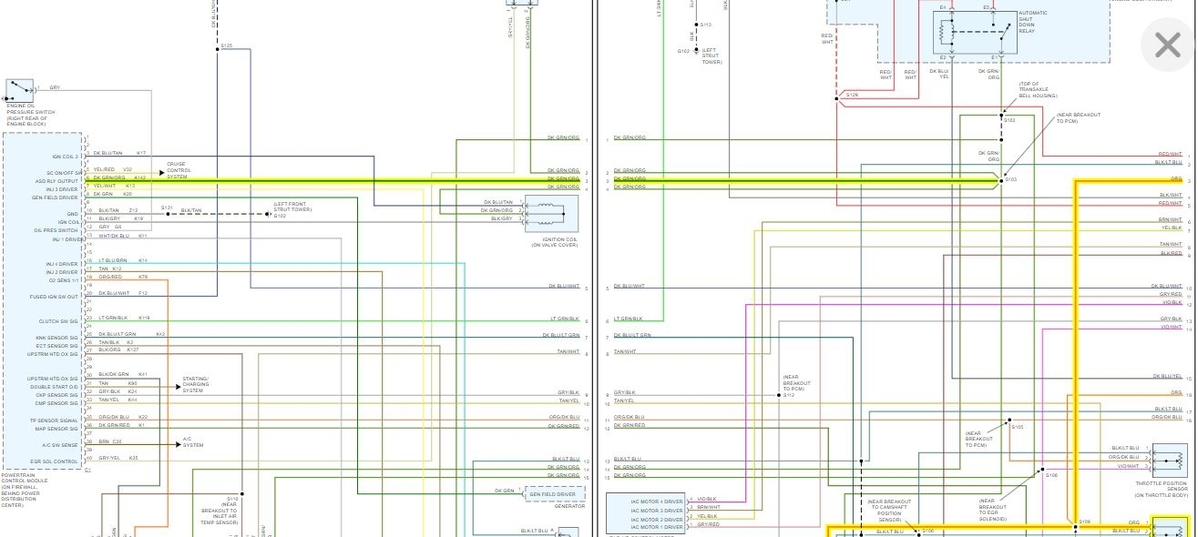

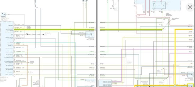

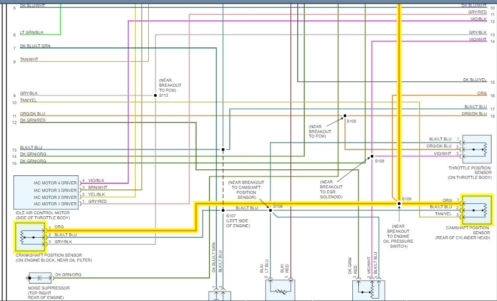

The other code is for the signal dropping out from the crank sensor. Check the connector and be sure you have 8 volts on the highlighted wire in the diagram I attached.

Do you think the wires that ran to the alternator and crank shaft sensor could have shorted out my computer? they were all raw and riding on the medal part of the trans axle. I checked the wires on the camshaft it's a hair over 8 volts. I have to crawl back under the car and take the wires off the crankshaft sensor. it's band new. also the cam shaft sensor, the new radiator fan, has also quit coming on when it gets warm. I changed that sensor. also need your thoughts. thanks
Nov 7, 2019 at 5:45 AM
No, it will not as long as the wire for the alternator did not short to any of the sensor wires.
Check the cam sensor harness as well. Peel back the harness about 10 inches and make sure it is still good.
