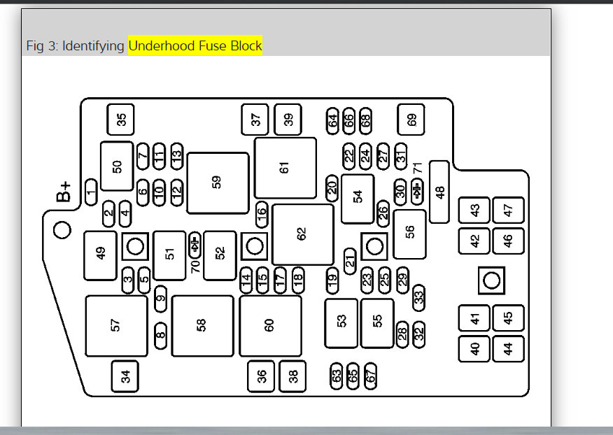

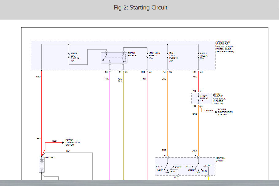

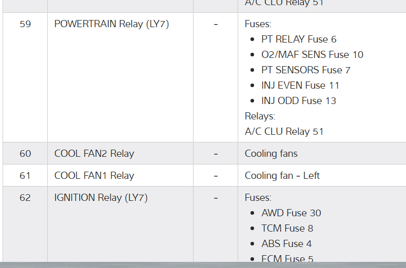

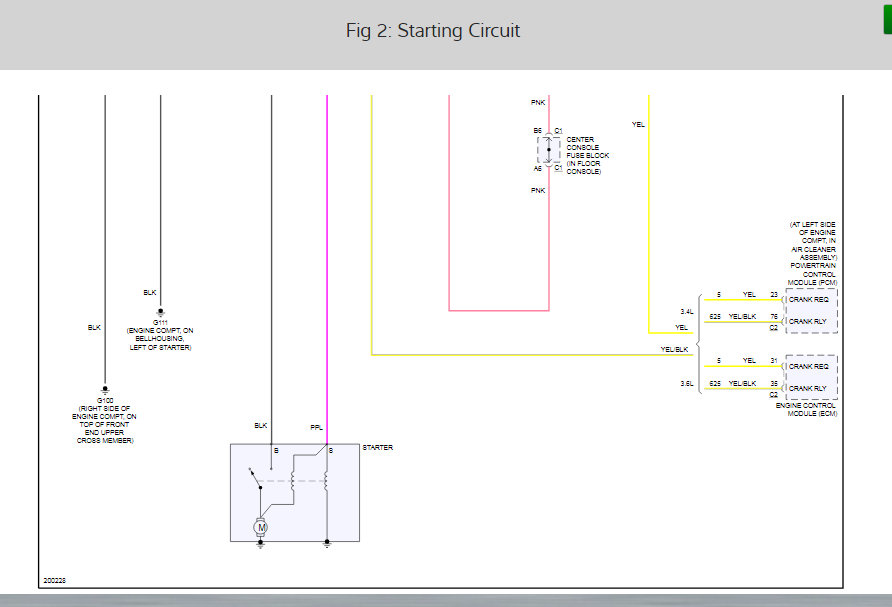

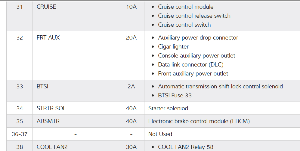

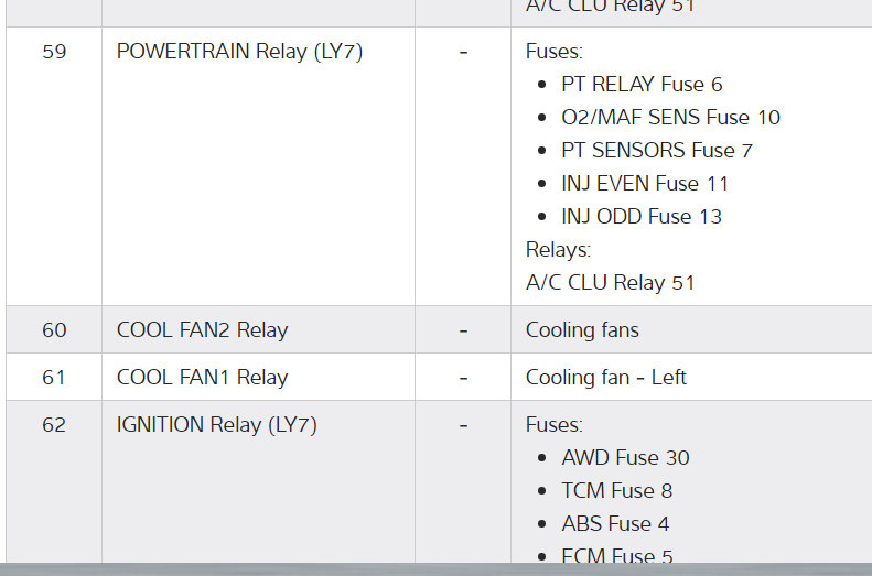

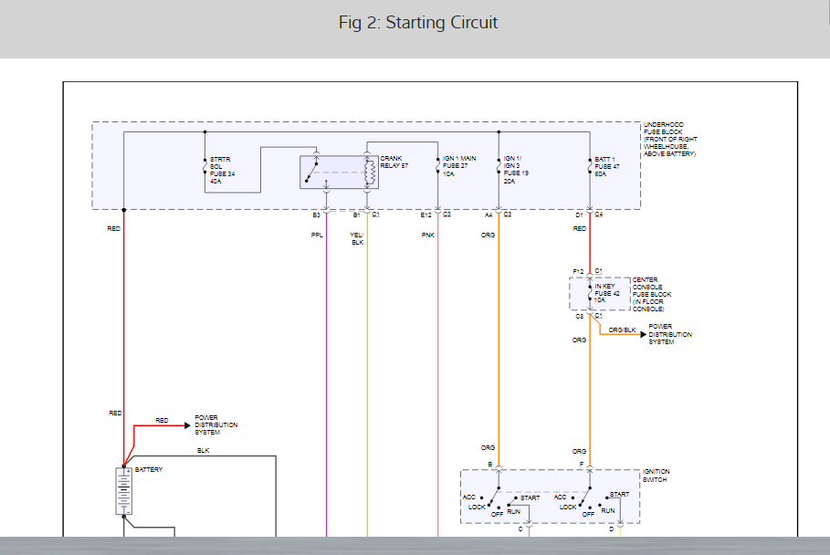

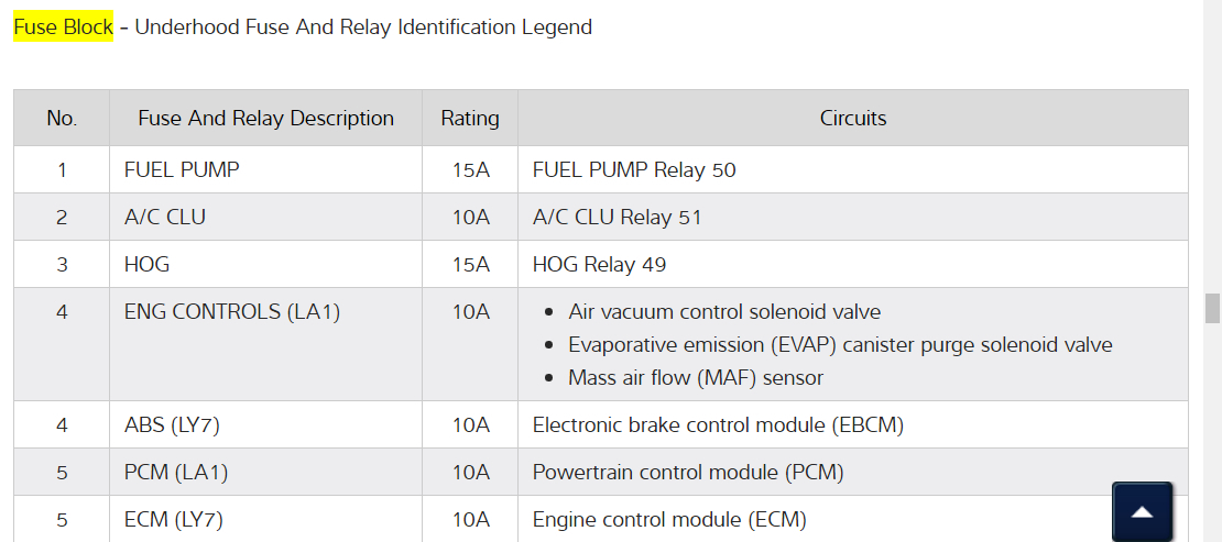

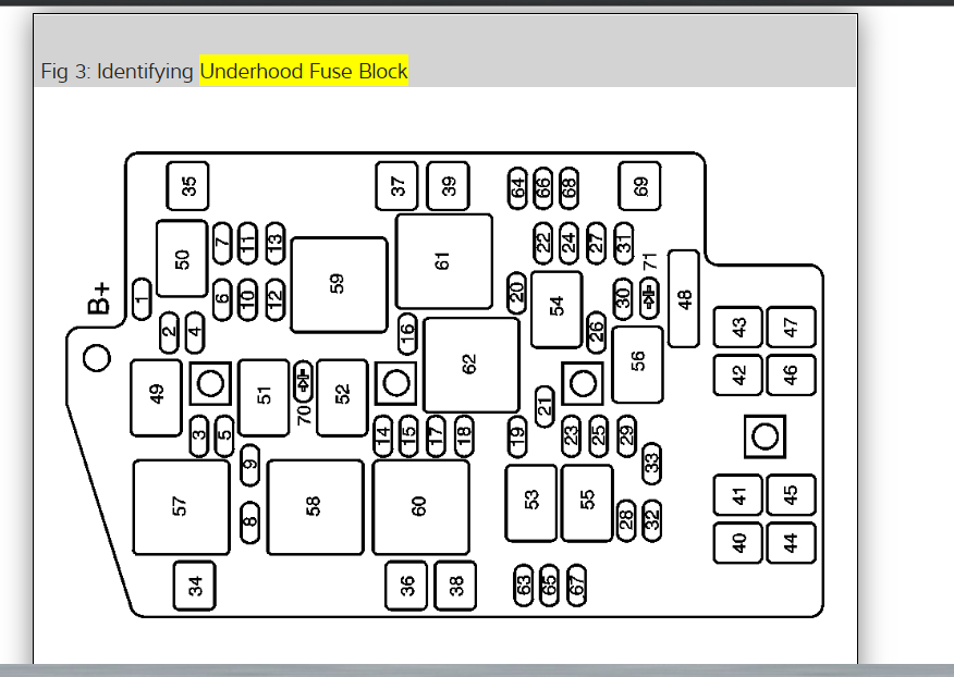

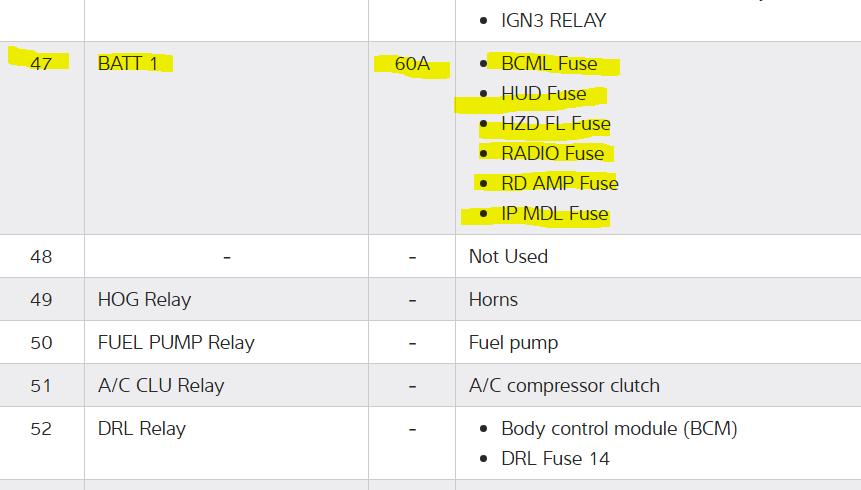

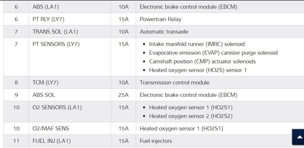

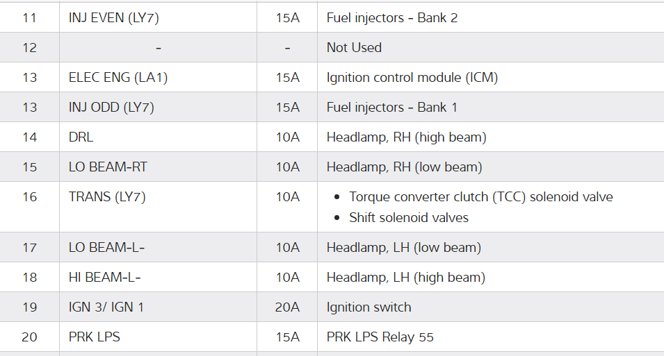

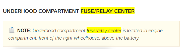

I replaced the front bearings on my vehicle. I had been getting a traction control needs service and the ABS light was on too. Both front bearings had play so replaced both.
After replacing I took vehicle for test drive bearings sounded much quieter. The traction control needs service and the ABS light were still on. Got back to the house unhooked the neg cable to reset computer 10 minutes hooked back up tried to start. nothing. Check engine light is on brake light is on and the line for my gear selector is not there gauges don't work assuming cause gas gauge not registering. nothing when I try to start. Left key on and jumped at relay starts up then shuts off.
