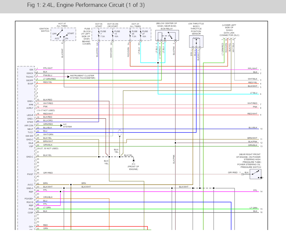

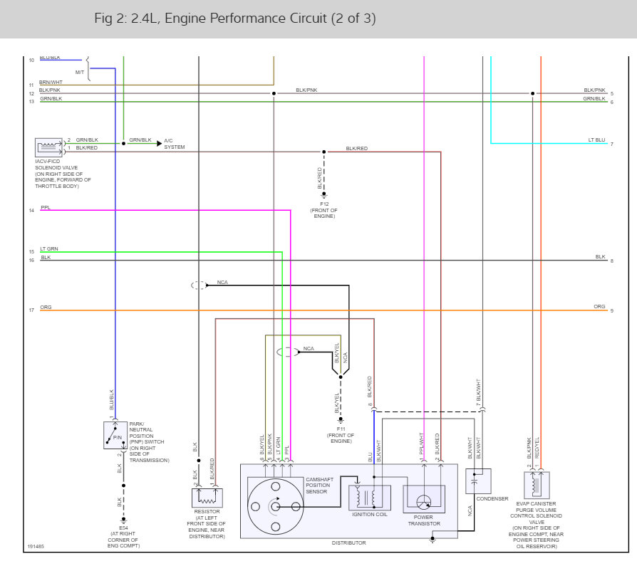

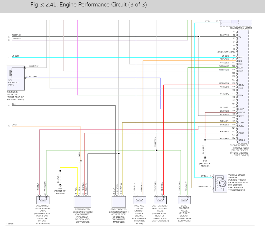

Had a problem with the distributor wiring harness. The six pin that plugs into the distributor. Some how the wires touched each other and shorted the distributor. There is also a 2 pin plug that fits on the distributor. any idea which is the positive?
Dec 11, 2019 at 6:54 AM
Here is a guide to help you test the engine and distributor wiring and the engine wiring diagrams below so you can see which wires to test and how the system works.
Check out the diagrams (below). Please let us know if you need anything else to get the problem fixed.
