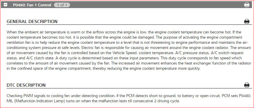

Hello, I am Danny.
Yes, that is possible. The fan that circulates the airflow throughout the engine compartment is affected.The coolant temperature sensor might be getting a false reading and therefore the engine is shut off thinking it's avoiding overheating. I would get fixed as soon as possible. I have attached a picture of its general description. Hope this helps and thanks for using 2CarPros.
Danny

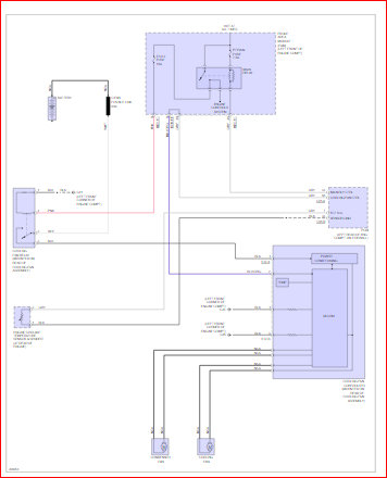

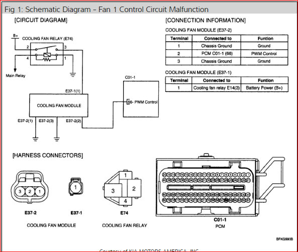

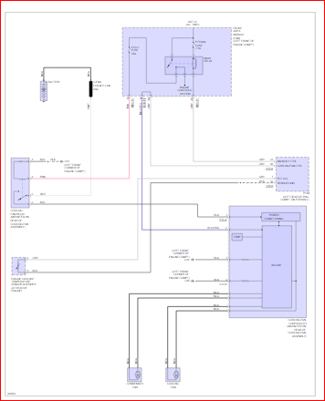

Could I get a clear picture of the fan controls and fuses and where they are located?
Dec 17, 2018 at 7:19 PM
DANNY L
  • 5,648 POSTS
Hello again.
Here are two wiring diagrams I've attached for you. I have also attached a wiring test tutorial for you to view.
Hope this helps and thanks again for using 2CarPros.
Danny-
