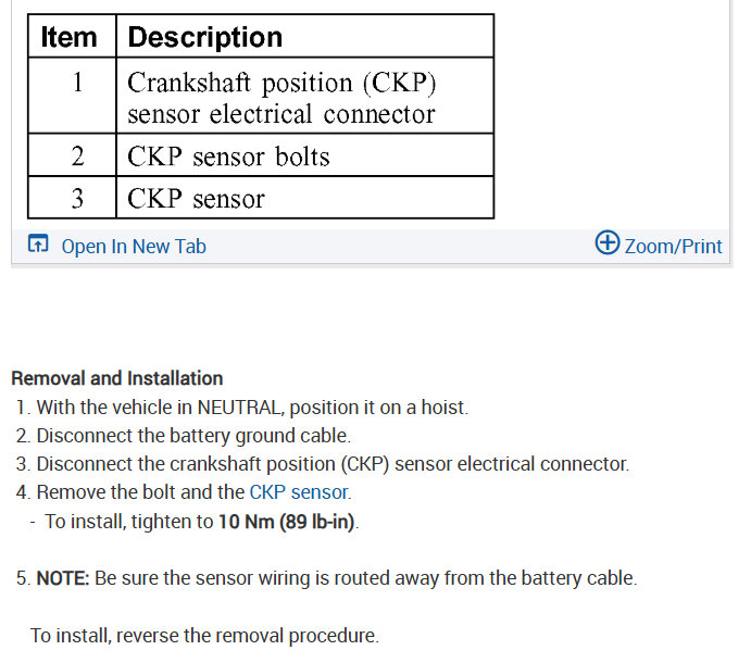

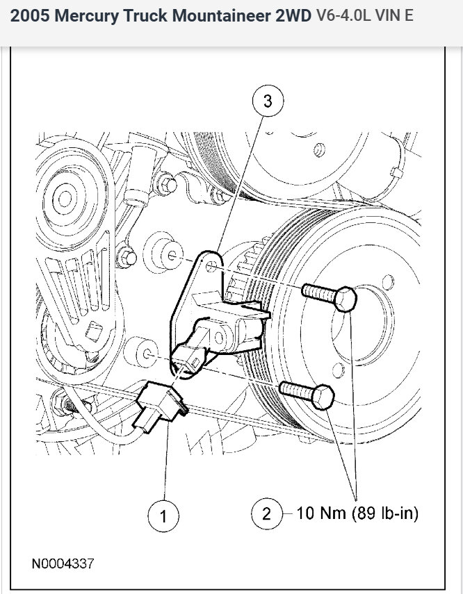

I have seen the crankshaft angle sensor go out and cause this problem, here is the location of the sensor so you can swap it out if you have no spark. You can use a scanner to see if it sees engine RPM as well.
