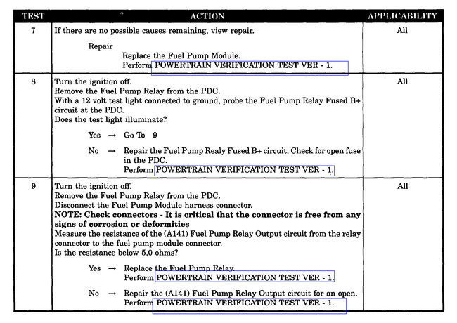

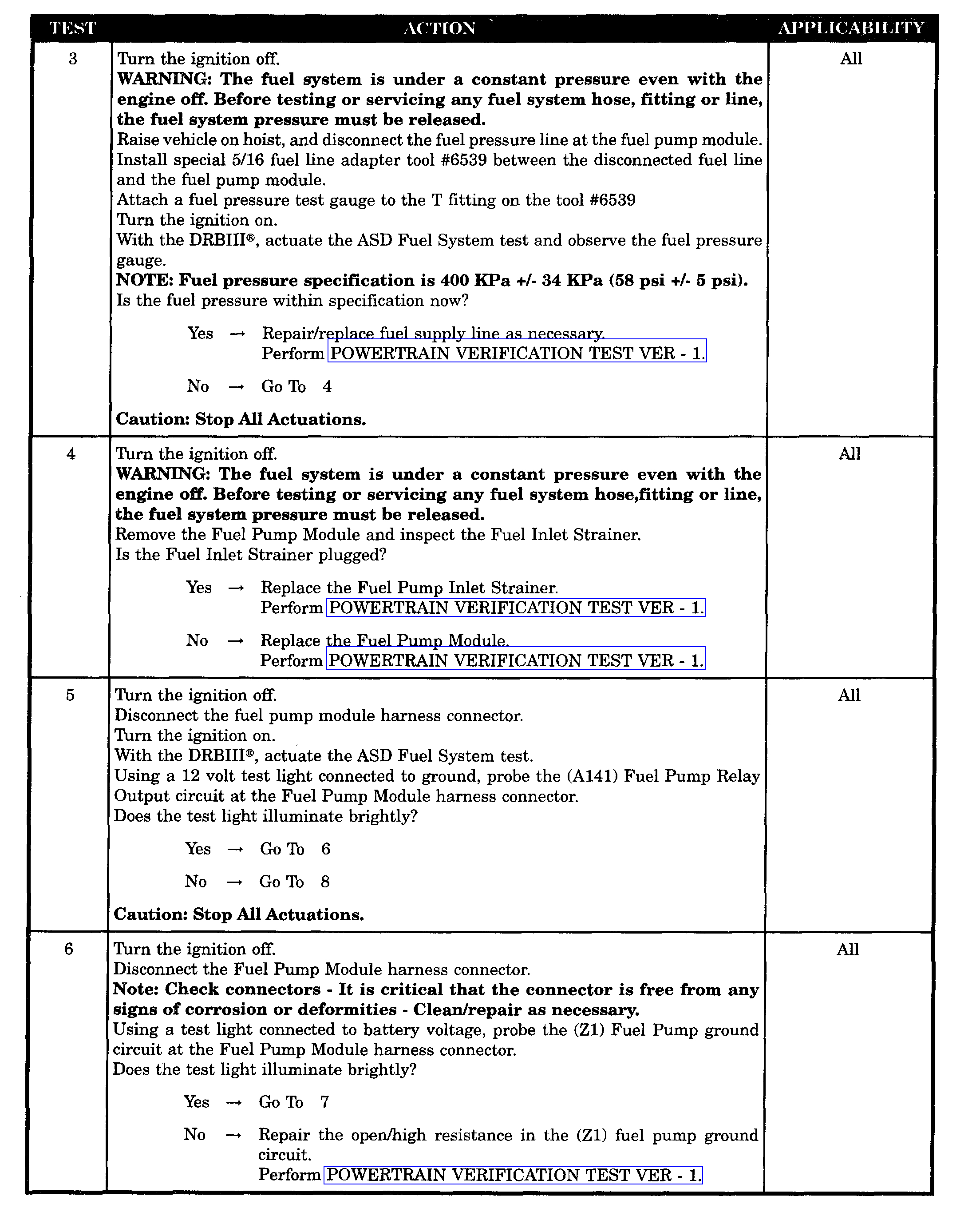

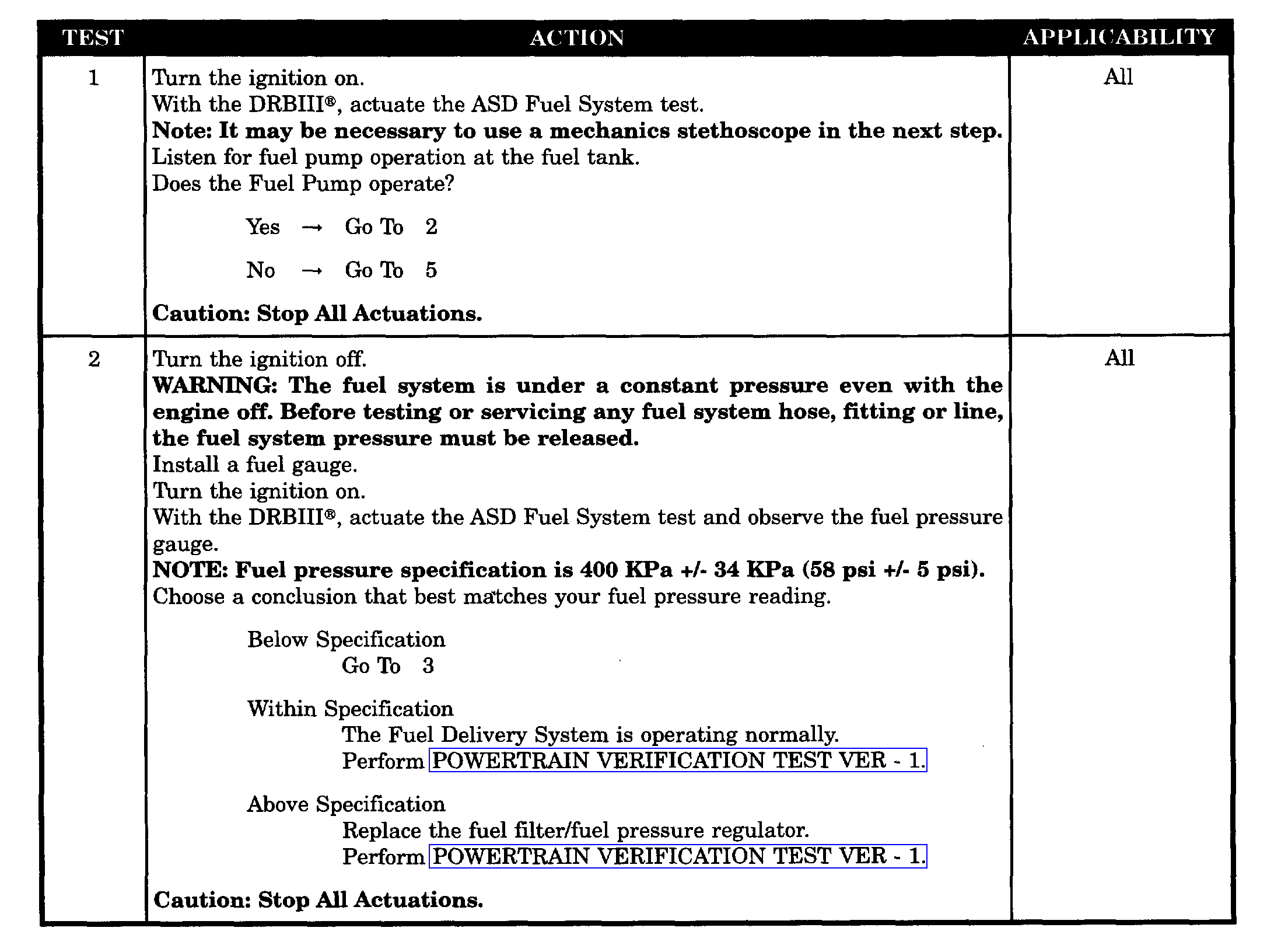

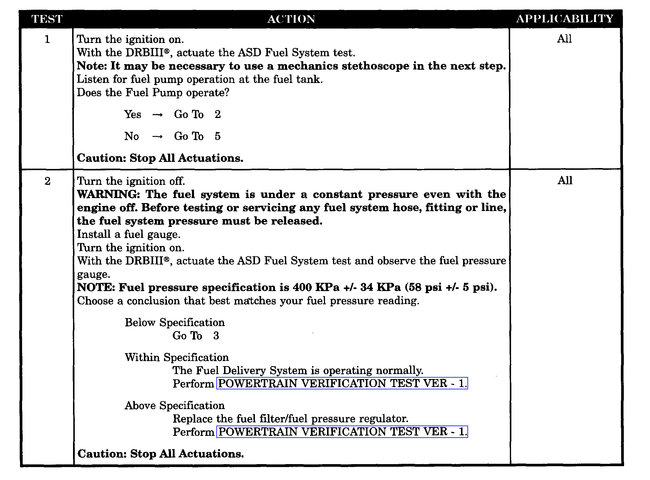

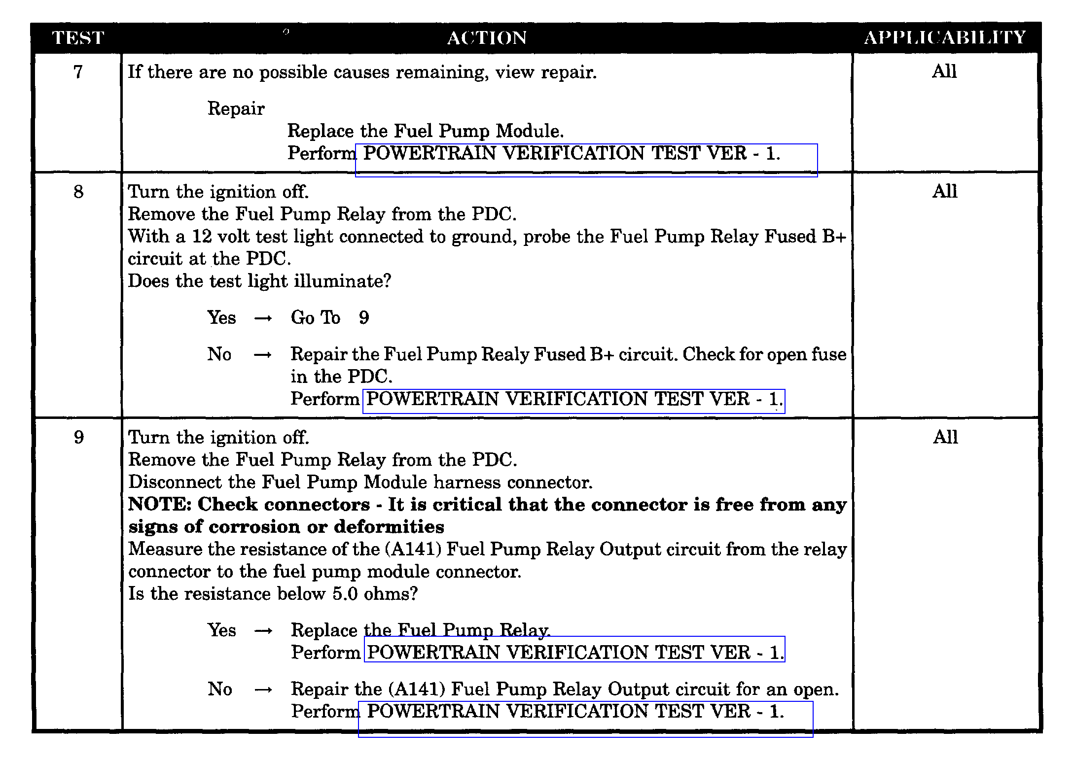

I have also included diagnostic flow charts for the fuel system. They are a bit more involved, but I thought I would add them. Here is a list of possible causes for fuel related issues that correlate with the pictures attached:
SYMPTOM
CHECKING FUEL DELIVERY
POSSIBLE CAUSES
- Fuel Pump Relay
- Fuel Pressure Out Of Specs
- Restricted Fuel Supply Line
- Fuel Pump Inlet Strainer Plugged
- Fuel Pump Module
- Fuel Delivery System Operation
- Fuel Pump Relay Fused B+ Circuit
- (A141) Fuel Pump Relay Output Circuit Open
- (Z1) Fuel Pump Ground Circuit Open/High Resistance
- Fuel Pump Module
