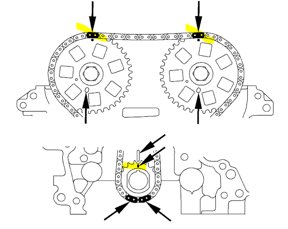

When you checked the timing chain marks on the cams, was the crank at TDC? See pic below. Also, when you crank it, is there any evidence of it firing? Are you spraying the starting fluid directly into the throttle body? If you remove the spark plugs, are they dry or wet with fuel?
Let me know. This is a good one and has my attention. LOL I want it fixed.

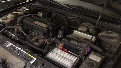

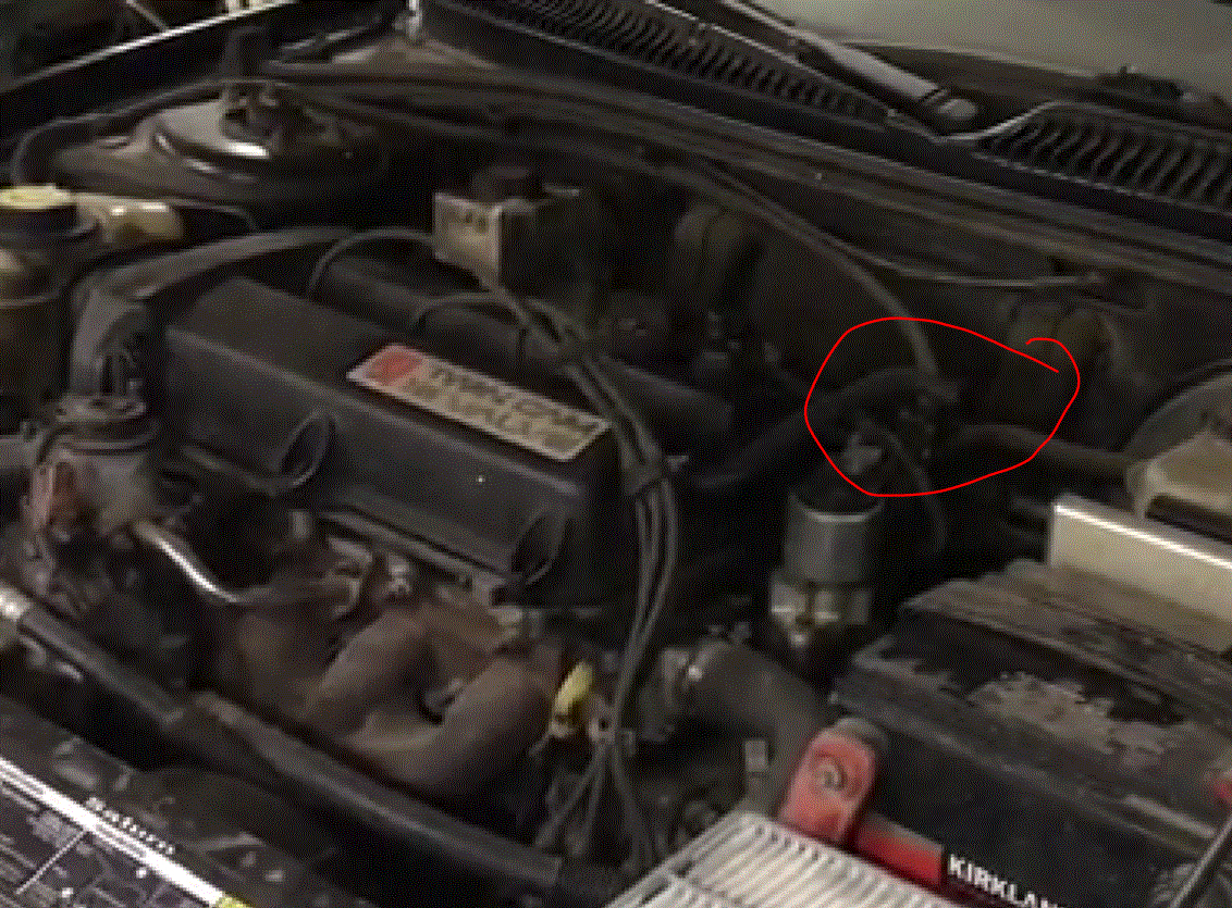

I attached a pic from your video. Is that the PCV hose?
Try something for me. Disconnect the MAP sensor and let me know if it runs differently or if there are any changes.

Hi Joe, yes that's the PCV hose... I removed a fair amount of the intake system to access the throttle body plus make sure there was no restriction anywhere. After sitting for a day and disconnecting the MAP plug, it initially resulted in a little longer run, slightly higher RPM and a little less roughness but the engine quit after 10-15 seconds. Restarting immediately after this resulted in the same rough run for a few seconds. 12v at 2 terminals on the MAP plug. TPS has 5v feed and varies from .43v to 5v when throttle is moved from one extreme to the other. Coolant temperature sensor has 5v feed and when removed it varied in resistance when run under hot/cold water.

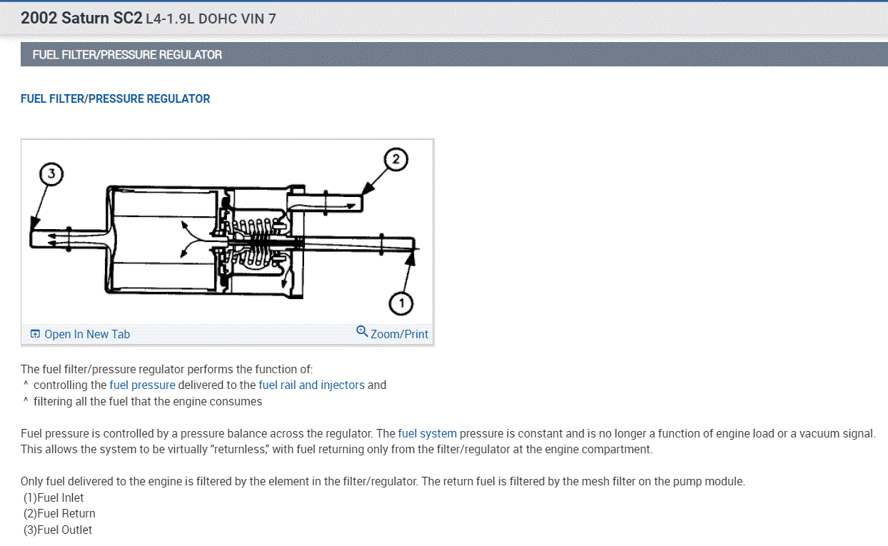

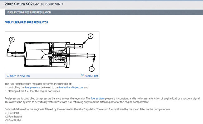

I may have figured this out. The fuel pressure is regulated at the fuel filter. The filter is just that, a filter, but it has an integral pressure regulator. See pic 1 below.
By chance, have you replaced the filter?

I'm concerned about the fuel filter. According to the manual, the pressure regulator is integral.

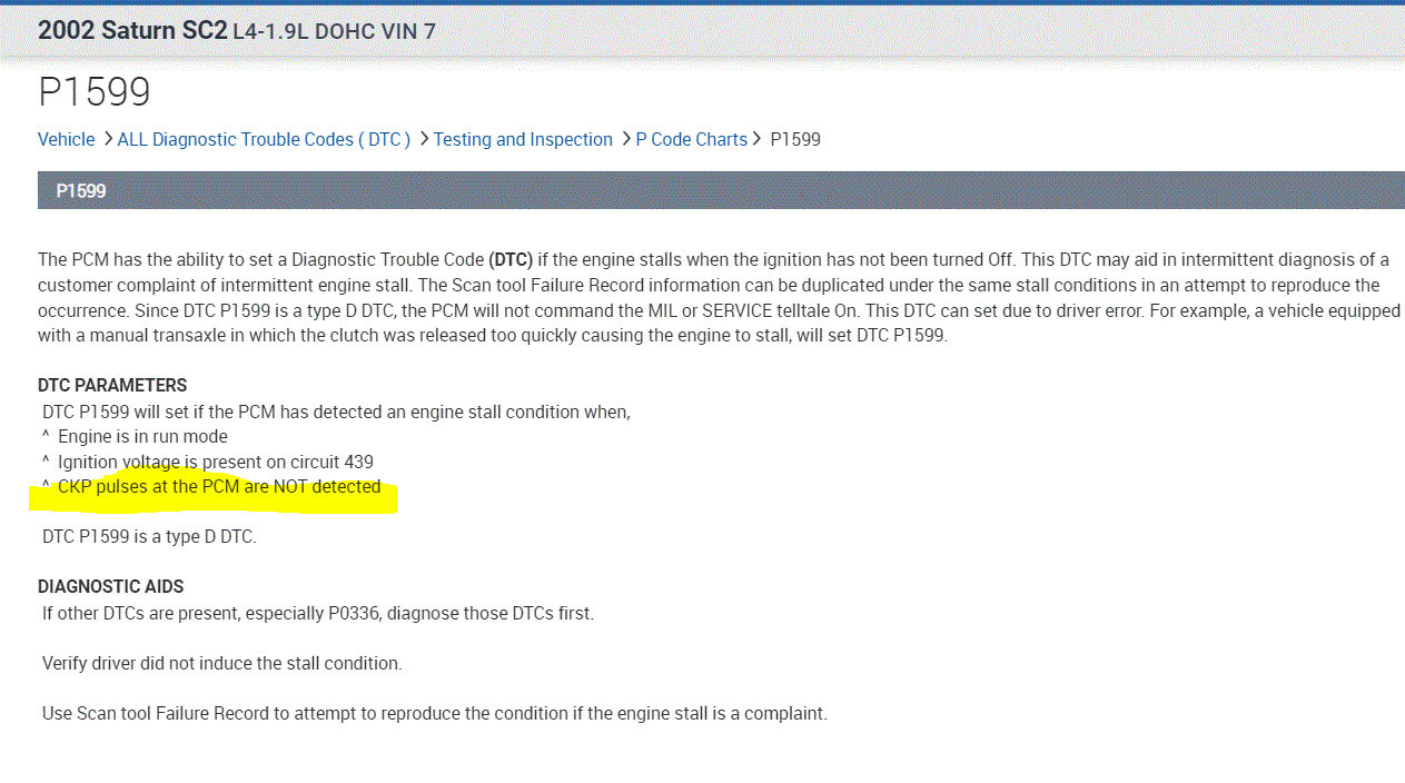

Hi Joe, my friend finally got back and borrowed a Snap-On high end code reader. It showed code P1599, and when I looked into that it just means the engine stalled when the key was still turned on. I checked the fuel pressure again and it's 56# when the key is turned on, and while cranking (or barely running) it varies between 50 and 55#. He said there was another code that indicated something about the air intake temperature sensor (maybe that it had been replaced). I had already taken out this sensor and the resistance checks out correctly as I make it warmer and cooler, and there is 5v at the connector. Now I'm back to no ideas again. If you have any other brainwaves, please let me know! Cheers, Al.

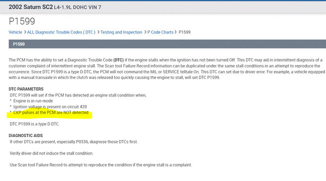

Also, the code does indicate it stalled with the key in the run position. However, it also indicates the CKP signal was lost.
Read through the code description below and let me know your thoughts. Also, by chance do you remember the code related to the intake air temperature sensor?
See pic below.
May 21, 2022 at 8:57 PM

Hi Joe, I'm just back home after our long weekend. I had tried removing the 02 sensor in the exhaust manifold, and quite the spark show. I ended up actually removing the exhaust pipe from the manifold in order to ensure it wasn't a clogged catalytic converter, or anything else in the exhaust system. No difference. Good idea, though. I didn't get a chance to see the actual code the reader showed for the intake air temperature sensor, but my friend said the reader showed a high reading and suggested I replace the sensor anyway. As I had mentioned I took it out and checked the resistance at different temperatures and it seemed to fall within specs. Do you think I should try replacing it anyway? I read in the Haynes manual that this sensor goes from about 6.6K to 8.4k ohms at 40 degrees Fahrenheit, and down to 215 to 235 ohms at 200 degrees Fahrenheit. I removed the sensor plug and installed a 220-ohm resistor but no change trying to start the engine and I got a code P113 (sensor above maximum acceptable range) on my cheap code reader. Resistor removed and plugged back into the sensor I get no codes.
