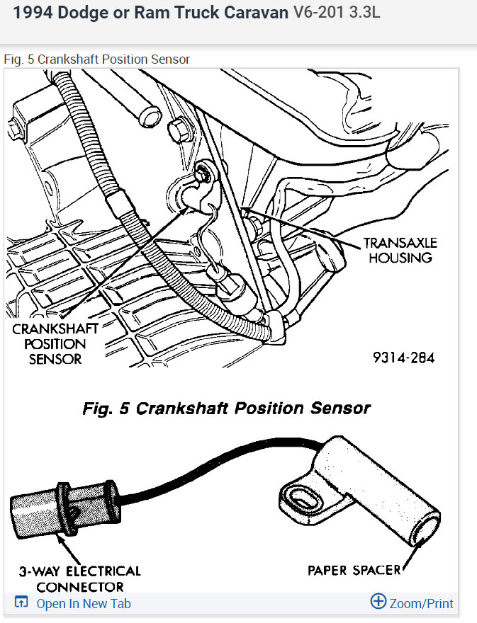

How does it sound when it is cranking over? Can you upload a short video so I can hear it that way I can make sure the engine is not hurt. Also, let's check for spark which video will help you do.
https://youtu.be/baq_aEWNQ0Y?si=XFPy1s3jM04lRKV9
Please go over this guide as well:
https://www.2carpros.com/articles/starter-not-working-repair

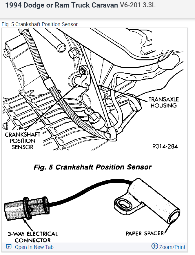

If there is no spark, I would swap out the crankshaft angle sensor here is the location of the sensor in case, you need it. Check out the images (below). Please let us know what happens.
