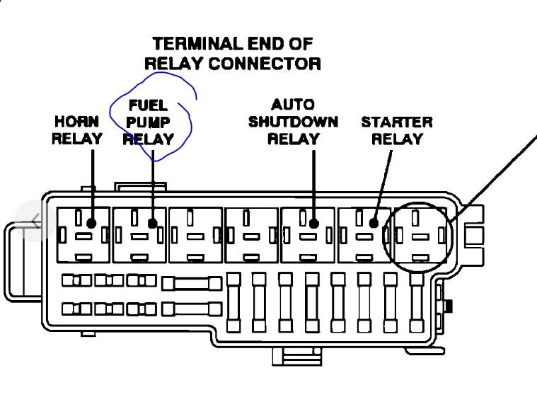

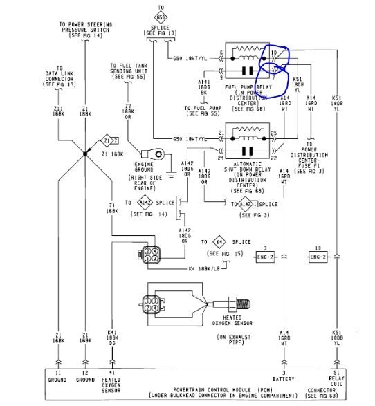

I attached a diagram for you. Can you check for power to the 2 wires I circled at the relay with the key on?

While sitting in the vehicle I can’t hear it turn on. I will check on the wiring. I haven’t read a wiring diagram much at all. How do you know which wires to check based on where they are within the relay itself? If that is what you are wanting me to do.
